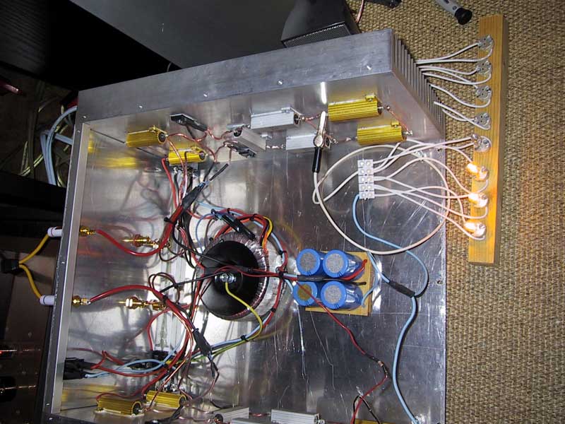

Figure 5 shows the use of a 300 watt Sylvania bulb. We will later be showing performance of 2 such bulbs in parallel for more bias current
from the article
http://www.passdiy.com/projects/zenlite2.htm
http://www.passdiy.com/images/projects/zenlite-rear.jpg
loks like lighbulbs. 300W 115V or so.
http://www.sylvania.com/catalog/
i was not able to find what i would need to go this way. No ceramic sockets, not 600W 220V E27 bulbs. I have one 300, one 500 and one 1000W 220V E33 bulb and no socket.
It works with halogen also.
If anyone has a few nice ceramic sockets and bulbs around 1kW for me...
The first one i built was with some 300W halosticks in parallel and had about 10W.

If you want to build this ZEN, I think you shouldn´t worry about what kind of bulb. More important is a god ripply free power supply with some effective filtering.
