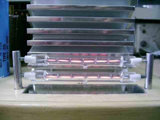

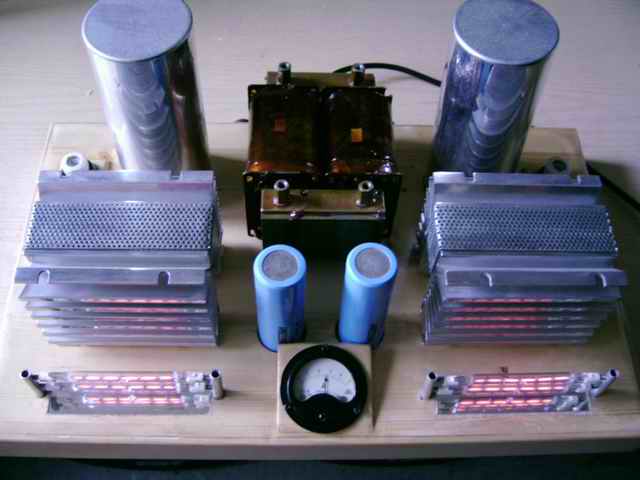

BTW, just yesterday I completed a ZEN-lite, in a wooden case, with ceiling halogen bulbs. I used 3 pieces, 12 v, 20w in series per channel. Unregulated power supply, 48 v, CLC filtering (Only around 50, 000 uF pr channel🙁 ). Got about 1.85 A of current. The voltage accross one bulb around 9v. With six of them( 2 channels), it is quite bright so in the evening I can turn off the lights in my room; ZEN is bright enough😎
Why Zen-lite now? In fact, I was attempting to build an F2, but didn't like the result. It was showing signs of instability, some weird noises from the loudspeaker when no music was playing. Then I "converted" it to a basic ZEN schematic, but with the lightbulb as a current source...(now it works fine)
I hope to "upgrade" this circuit to something better, an F3 or just a cascoded Zen, using another mosfet, but I have to solve some issues first:
Problems:
1. I have to add a turn-on thump blocking circuit; at the moment I am shorting the input manually when powering it on.
2. Heat: While two mosfets are mounted on a decent heatsink, halogen lamps release pretty much heat on their back, which are inside the enclosure. So I am keeping the cover open, but I am thinking of adding a fan.
3. Noise. Transformer (600 w) is quite noisy. Enclosure is resonant; I feel as if I mounted a tranny inside an acoustic guitar:dead:
If I don't manage to solve these isses, maybe it will just be "forgetaboutit" thing...
