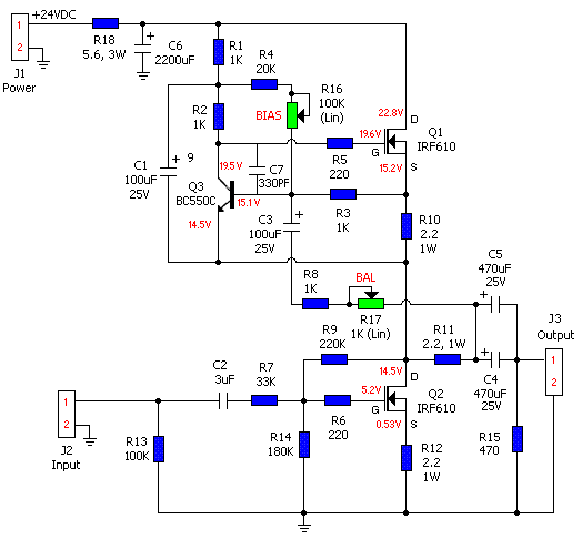

Zen headphone amp problem
What is the source that is used to drive your headphone amp?
Can you identify the source of hum and hiss?
If they come from the source, you can add a 10K VR to the input of your headphone amp.
By adding a 50 ohm wire-wound VR between the amp and your headphone, you can decrease the output level as well as the noise. But this may somehow affect the output quality.
Even with a 45R resistor at the output, and the noise is still present, somewhat lower but still there.
I tried using just on channel with the following power supply 10.000uf R5.6 10.000uf R5.6 3.300uf, no hum at all but the hiss is still present.
I also tried replacing C3 with a better quality one, Q3 with a 2SC2240 , replacing R16 and R17 with resistors, no difference to the noise what so ever.
So I guess I have hit the noisefloor of this circuit. :xeye:
Next step build a LU1014D cascode J-fet follower as shown by EUVL, just with lower rails.
Yes yes steenoe, you told me so 😉

I tried switching C2 and C4/C5, increased R5 and R6 to 440 ohm, and changed R15 to 45 ohm. No difference what so ever.
The amp plays nice with my grados, without any hiss, but with my shures with are much more sensitive you can hear the hiss, not alot but enough to get annoyed.
It is properly just my P2P mess the creates the hiss.
