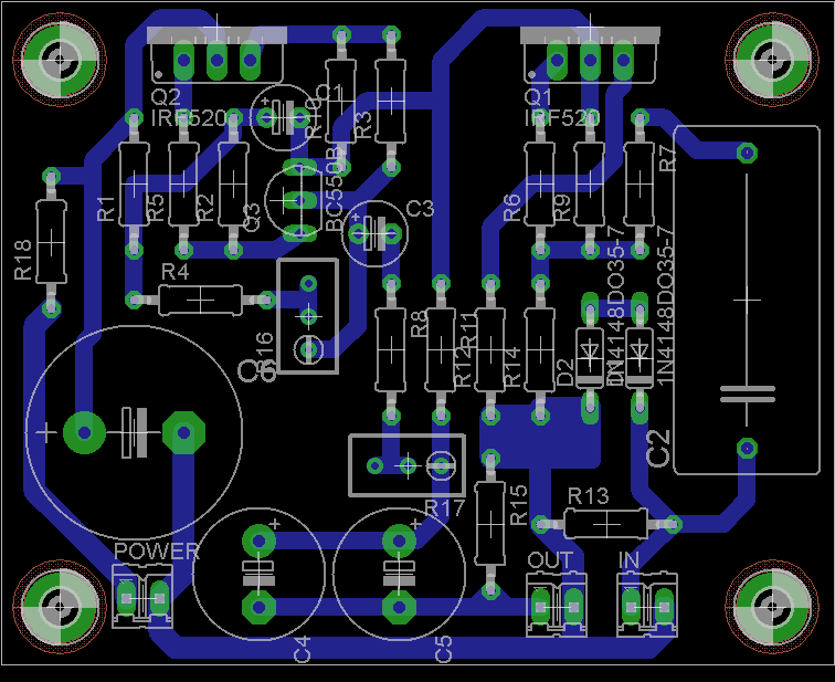

Zen headamp. PCB, my ver.
Hello. I'm interested in building Zen head-amp and now designing PCB for this.
My PCB design is based on Marcello Pellerano's PCB, which can be found here:
HeadWize - Project: The Zen Headphone Amplifier by Marcello Pellerano
So here is my version. It's a bit smaller then "original" and I also tried to minimize the total length of tracks, were signal is flowing...
Waiting for comments and advices.
After all I'll share Eagle file here.
Twitchie,
Maybe flip R3 and R10 and eliminate the jumper, then you could also straighten up the track between R10, R11 and Q2
Done. Thank You.
Rodeodave,
Concerning C2: Maybe add more holes to support various footprints/sizes.
Added Lead spacing 10.2 and 15mm. Need any more?
PCB size is ~85*72mm (with mounting holes)
Inputs cap (C2): Wima MKP4 or other (LS 10.2, 15, 22.5 mm);
Output caps (C9,C10): Panasonic FM 470uf or another (LS 5mm); Elnas are too big 🙁
Power Cap (C6): Panasonic FC or other ( LS 7.5mm)

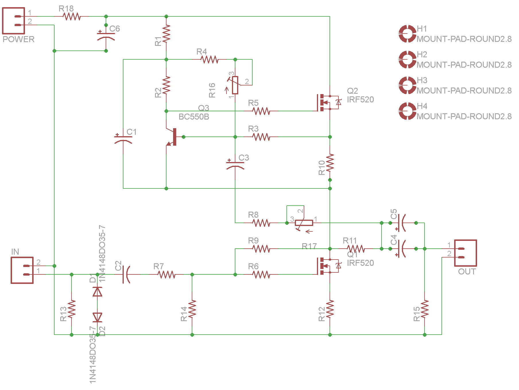

Thanks to STREAM for renewing my interest in this one enough to take a crack at the layout:
it's 2.0x2.5 inches or about 1/2 the size of the original
Twitchie, nice looking layout.
I'm only worried about very long and thin track from V+ to first IRF.
Are You planning building this? And why IRF520?
P.s. Nelson Pass used some MKT(MKS) caps to bypass power and output in ZEN4 , maybe we should add them to this design too?
Hi Twitchie,
nice layout, but please consider that "high" bias currents need some copper: it is not necessary to oversize this aspect, you needc to calculate it correctly. In a quasi non-feedback circuit (few dBs....) even the current modulations can be heard through (sensitive) headphones. IMHO I don't see IRF520 very well in this circuit. It has been design around IRF610 types, with the 520s the frequency response will not be enought for a quality result.
As suggested, you can successfully defreat the bias modulation with slightly acoustic upgrade, but yuo will need to crank up the bias current to compensate. And yes, with my Grado's and my AKGs (701, 141M) I need gain too, if I want to connect the amplifier straightly to the Micromega CD setup outputs.
Good Work! : )
Marcello
🙂 Thanks for the comments Tortello and I should thank you as well for your original contribution
Sorry, I guess I should clarify - I've been on a diyAudio break with a new baby and my computer got reimaged so I just downloaded Eagle and it didn't have IRF610 so I just used 520 for the layout and pinout.
I was hoping for the feedback regarding trace widths. To be honest, I enjoy all aspects of diy equally so I may or may not ever etch this and even if I do, I may or may not get to populate it and even then ... you get the picture, but I do have fun all the way along.
I moved the layout around a tiny bit to make room for wider traces. I'll repost when I get enough time between diaper changes :drool:
