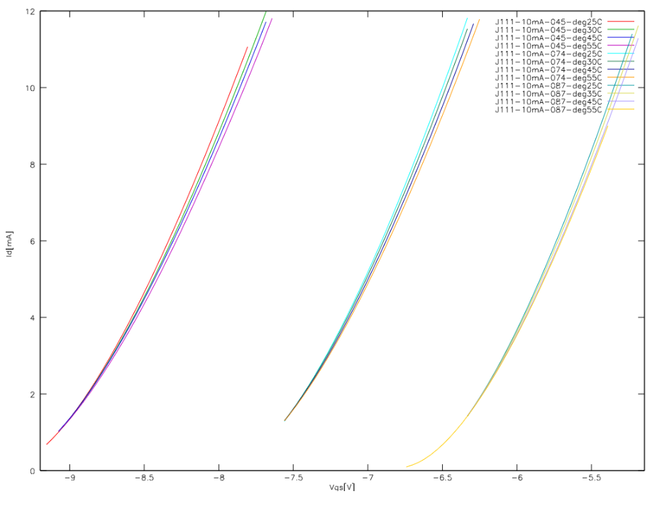

We made a fixture to mount the 2N4391 on our computer controlled heater block.
Then we curve traced a few examples at different temperatures from 25°C ~ 55°C.
The zero tempco current is at ~2mA, not 6mA as in datasheet.
You can always use 3x each degenerated to 2mA to make up the 6.2mA required.
Patrick

In post #1586 above, we mentioned that the tempco at 6mA was -3µA/°C.
Assuming a Riv of 680R, this means a tempco for the output DC offset of 2mV/°C.
Or 10mV for an ambiet temperature change of 5°C.
So the issue was not stabilisation.
The issue was DC offset dependent on ambiet temperature.
In Asia and probably also in Southern Europe, room temprature change of 5~10°C is normal.
One can then argue whether 10~20mV offset is too much or not.
We just want to publish our findings.
One can decide for himself what solution he wish to choose.
