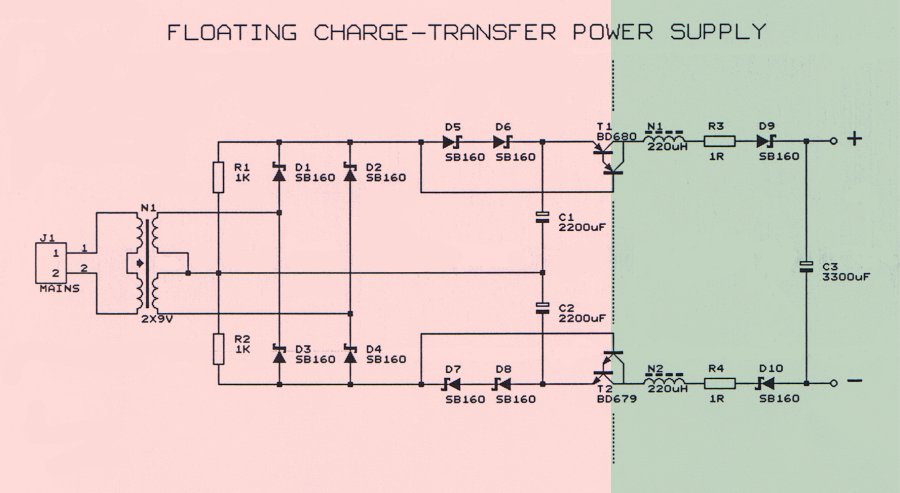

I agree that a floating supply is not a problem to make. The easiest are buffered batteries or accumulators.
Somewhere in my files i have a design for a floating low noise supply that can be fed by a conventional mains transformer. When i can dig it up i will publish it if you like.

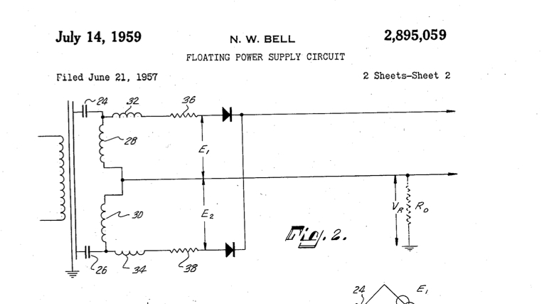

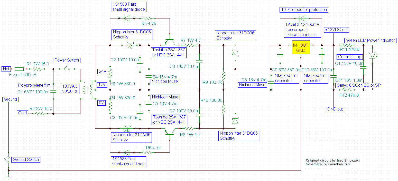

For the basic principle something as old as me.
Or using a few more parts.
Interesting.Or using a few more parts.
The circuit on the left would not be covered by U.S. Patent 2,895,059 because it doesn't have the dummy load and does not use the center tap as ground. However, the circuit on the left is the one that I would intuitively build.
The circuit on the right does indeed look like an actively regulated version of 2,895,059 because there appears to be a dummy load (active, at that) and ground is taken from the center tap like in the patent. ... EDIT: Oops, that's not a dummy load. The circuit on the right is also not similar to the patent mentioned above.
Both examples would have leakage current to ground which patent 2,895,059 minimizes with its dummy load.
