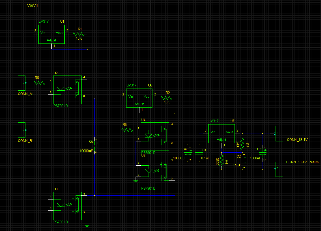

How about something like this for a Sen floating power supply?
Switch A and B on and off alternately at 10Hz-100Hz with a gap of 1ms where they are both off to ensure the output supply is never connected to the input.
With 100Hz switching, could maybe reduce the big caps to make it smaller and even cheaper.
Would it work? Would it buzz?

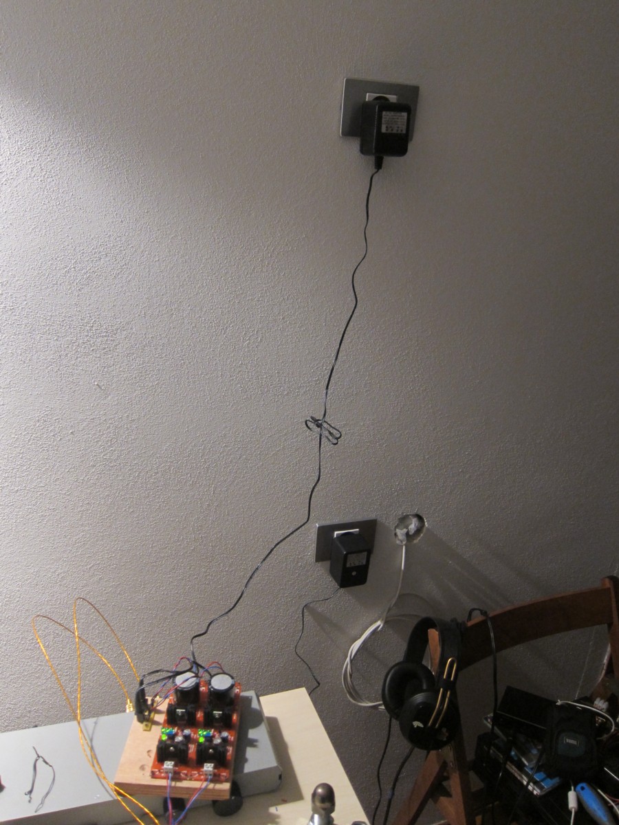

That is interesting Guglielmo. I was thinking that a transformer with secondary away from primary was mandatory, like in a R-core transformer, to keep the line noises from getting in to the signal.
can you open the case of the transformer ?, just to see if it has separate primary and secondary, sometimes even a cheap transformer has them in separate bobbins. Thanks.
