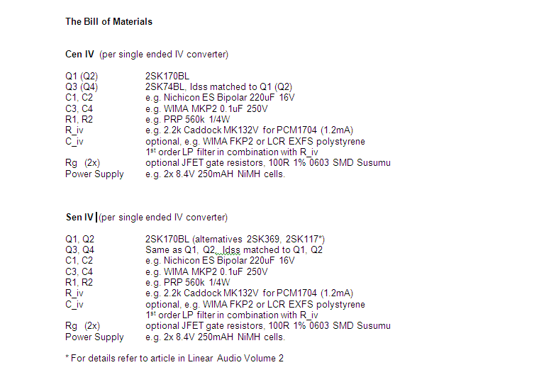

can I use 1 pcs of high Ah car battery 12V + another 6V battery for two se sen channels
If running balanced and i have one +-18v PSU, should i just run +18v to positive phase and -18v to negative phase? and then paralleled over both channels?
Also, approx how much current would in total can i expect (per phase) if running 6x SK170's in CEN config?
Is it just six times IDSS which is TOTAL current draw per phase in that config?
You need 4 supplies. Try to do your homework just a tiny bit.If running balanced and i have one +-18v PSU.......
A +-18v supply is twin supply, which i thought would work. Too bad that you need two of them, since i have no room for that.
And sorry, if i don't have time reading through 26 pages of text.
26 pages? well its in the build manual, BOM and schematic on the first page too....
its also not calling for a bipolar supply....
it needs a 17-18vdc floating supply for each phase of each channel, so 4 in total

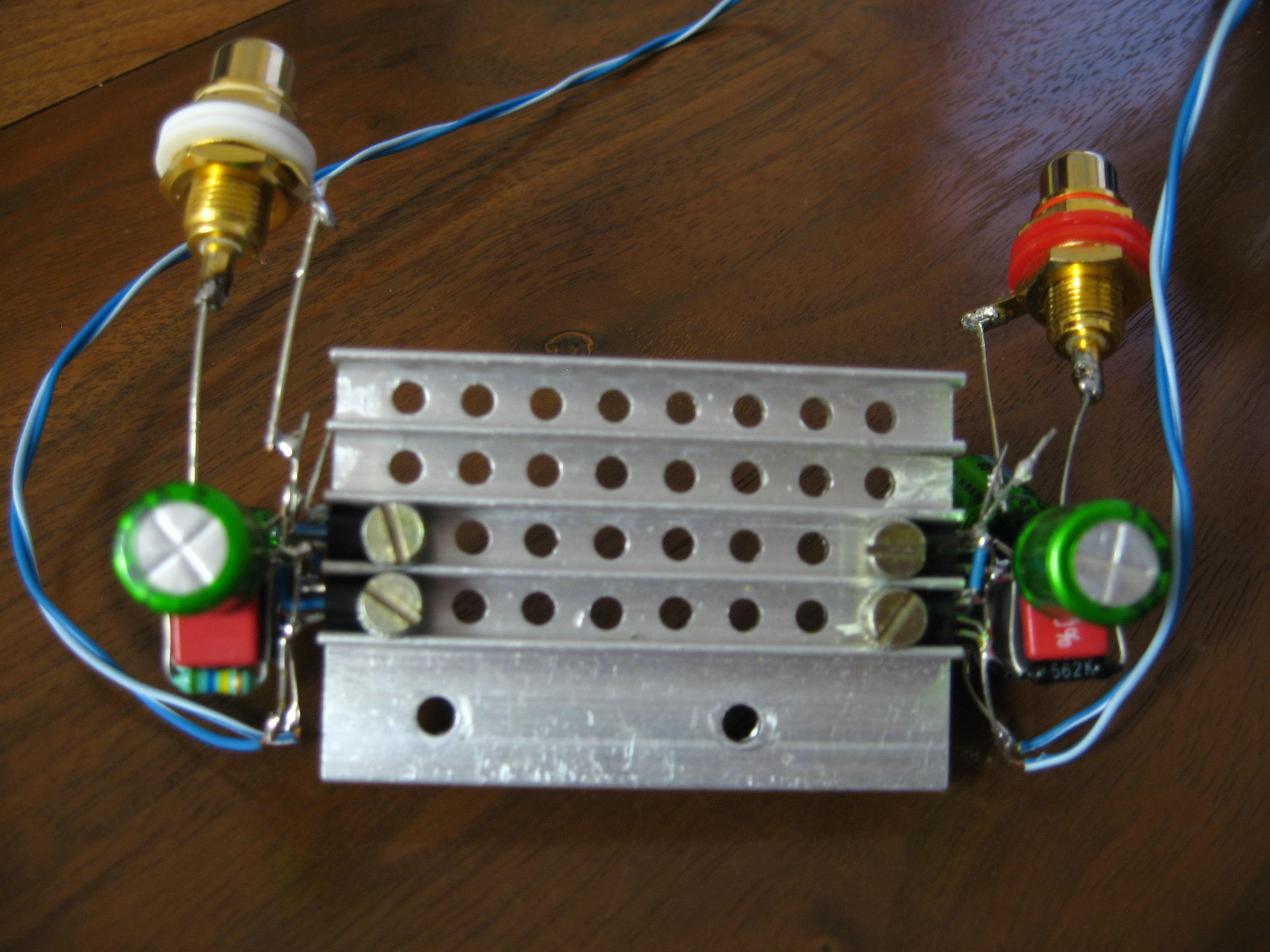

I have built this sen circuit using P2P. I also still have problems with getting it to operate with both channels connected. I am using PCM1702s and the original circuit design. Must be in the player as If one channel is connected, it operates fine(the other channel with a 1K on it). When I connect both, the working channel get's "jittery" and the new channel has high speed modulated signal wave and half the amplitude of the working one. Have not put in the stopper yet. Thought it would be easier but still working on it.
