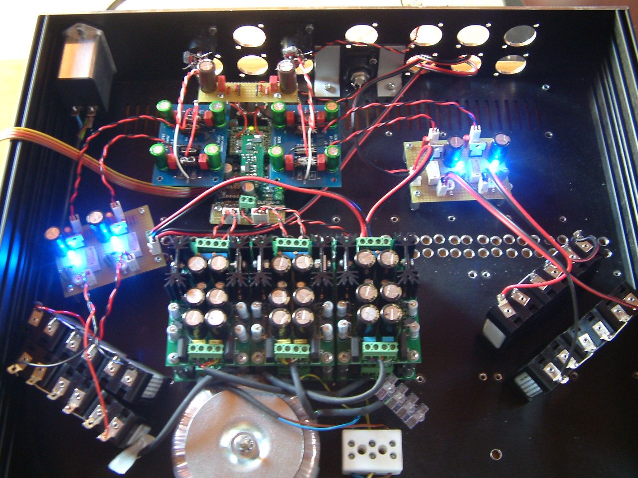

Ok. Here are a couple of photos. As you can se it looks like s...😱
What you cannot see with your ears is that it sounds divine despite the fact that this is so very much an alpha build🙂
First photo show the "off" situation where the batteries are getting charged and some amber power LED's light up. They actually serve the purpose of dumping the charging voltage to what I wanted. They also dim in accordance with the degree a charge (can't really take the honor for this useful feature😉).
Second photo show the "on" state. There are some blue LEDs on the pre-regulated side to indicate that the rails are powered.
The rest should be pretty obvious as I have posted it before in this thread.

The I/V-resistors and filter caps.
This is a very convenient configuration as you don't need to route the DAC ground to the SEN boards.
