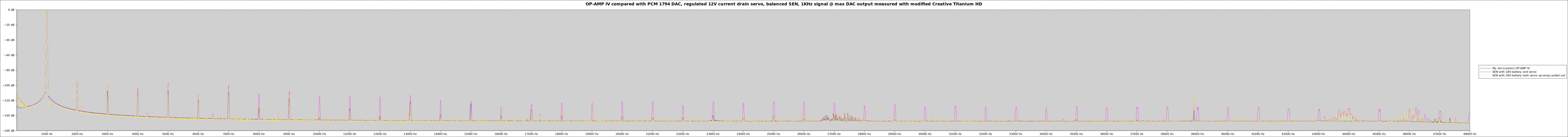

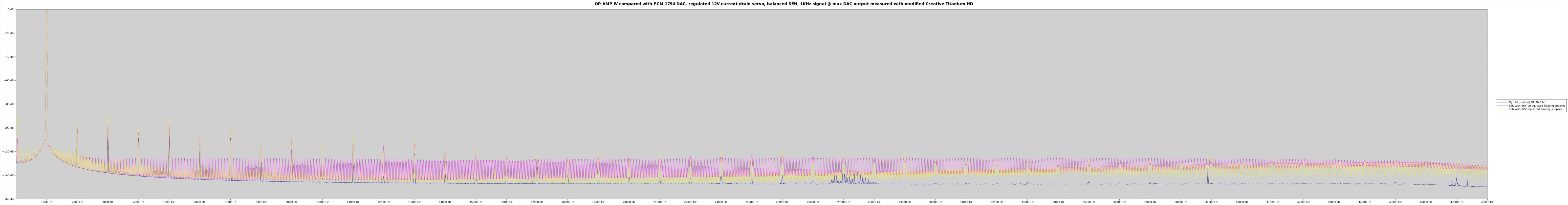

More measurements of PCM1794 with balanced SEN
I have replaced a toasted op-amp on the sound card I normally use for measurements (which is better than the UA-25 aside from a couple of spikes of noise) and it is working again.
I also worked out how to get it to measure a balanced signal using L+R channels for each half and then calculating the difference in software afterwards.
My normal measurement card is the one with my DAC so there is a chance that the toasted op amp had been affecting the performance of the DAC chip in my previous results. Probably not though because it was on the ADC input and nowhere near the DAC.
Here are the new results including a comparison with my previous IV which is a balanced OP-AMP design I hand-crafted.
There's an argument to be made that the lowest of the three lines at any frequency indicates an upper bound for any distortion introduced by the ADC (the counter argument would be that the signal might be canceling out some of the ADC distortion at that frequency).
If you subscribe to the former argument then that would indicate that most of those early peaks are measured distortion values for the PCM1794/SEN combination where it is worse than the PCM1794/OP-AMP solution.
I haven't done any work on optimizing my SEN circuit yet.
While testing, I did notice a little distortion either introduced by the servo or perhaps by the regulated power supply: the sudden change from no signal to a full amplitude 1kHz sine wave results in a little dip in the signal level followed by a correction - the little dip contains clipping distortion. I did a warm-up stage before getting the results for the graph so they don't include this.
The ADC has a couple of OP-AMP buffers in front of it which are the same type as the ones in my OP-AMP IV so there might very well be some cancellation going on.
AP1 is good is it?
I should mention that the 12V and 18V measurements are for my left and right SEN channels, they were not done on the same channel so it's not clear whether the difference in distortion is due to the supply voltage or the different circuit under test - I was comparing the power supplies for noise rather than distortion - sorry.

AP1 was at its time industrial reference. It is still one of the best you can get with reasonable money.
The red curve (SEN IV 18V) in your measurement above indicates 2nd & 3rd harmonics in the order of -95~-100dB.
This is about the same order as what we published.
http://www.diyaudio.com/forums/digi...on-minimalistic-iv-converter.html#post2688676

PCM1794/SEN on batteries with servo op-amps removed
I was a bit suspicious of all the high order distortion in my previous measurements - normally it's the result of lots of negative feedback somewhere - so I pulled out the servo op-amps during the measurements and took the spectrum from just afterwards before the circuit had drifted.
The difference is particularly clear in this second set of measurements which I have taken whilst running the floating supply on batteries (one channel is batteries, the current drain and other channel are still regulated 12V supplies).
I don't believe the 2nd harmonic distortion result in these measurements - the only way they can all be the same is if it's from the ADC. A lot of the other even harmonics are also less than the odd ones. The rest of the harmonics are more interesting.
So my hacked together servo is introducing some high order distortion - not that surprising given that it is amplifying the signal way past the point of clipping and then applying that to the input (even if through a low-pass filter).
I need to design a better servo.
I also measured the balance of the floating supplies at rest and they are out of balance by about 5% because I didn't match my jfets well enough (I should probably have waited for them to warm up; there were 100 though). Spice indicates this is enough to cause some distortion as well.
I have a design for a second servo to fix the mismatch which works in spice (3rd harmonic down to -140dB with mismatched jfets and Riv reduced to 250R) but I also need to work on that one to make sure it doesn't introduce high order distortion.
So it looks like there is plenty of scope for SEN to beat my OP-AMP IV on measurements as well as the listening test
