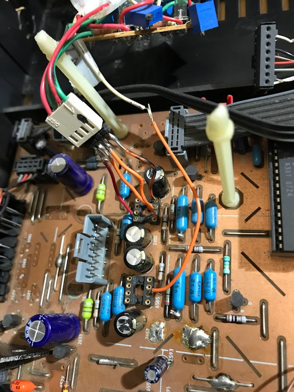

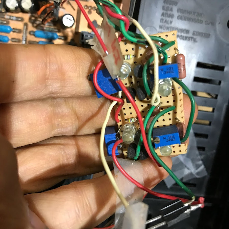

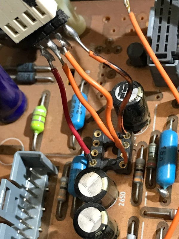

Yes, all of the above! I've only just glanced at the Sen, but it "looks" similar to Jocko. Similar number of transistors , etc. They are both cathode, correct?Were you asking for a technical comparison of circuit topologies? About reviews or opinions on perceived SQ? Suitability for use with particular type of dacs? Cost to build? FFT measurements? Input Z? Something else?
IAC, which -- Sen or Jocko -- would would be better for one I/V vs another I/V? I'm guessing Jocko's may be a bit better because of the Sen's single-rail design ???
I did build the Jocko I/V over a decade ago with VERY good results in my TDA1541-based CDPs. The Jocko's are used essentially as discrete drop-in op-amps. I'm only using the default +/- 15v rails (instead of Jocko's suggested +/- 18 v).

IAC, my above query about which -- Jocko or Sen -- which would be more ideal in a classic CDP (see images I posted), such as TDA1540 or 1541 , still stand 😉
the Cen/Sen suites well DACs with a symmetrical current swing wo. offset current., while the Jocko circuit suites well DACs with an offset current (sinking in the above linked circuit).
For current sourcing DACs with offset current like the popular TI PCM179x series a 'inverted' Jocko utilizing PNPs fits better.
In that case one could not only omit with the biasing current source Q3, but overall current consumption, resp. heat power could be reduced also.
The DAC output would only be connected to the PNP-Emitter (Q2).
Since the offset current is always larger than the peak output current -never reaching, let alone crossing 0mA- the circuit remains biased under all circumstances ... hence the extra current source (Q3) is not required.
Also not required would be the positive supply line, making things even easier.
