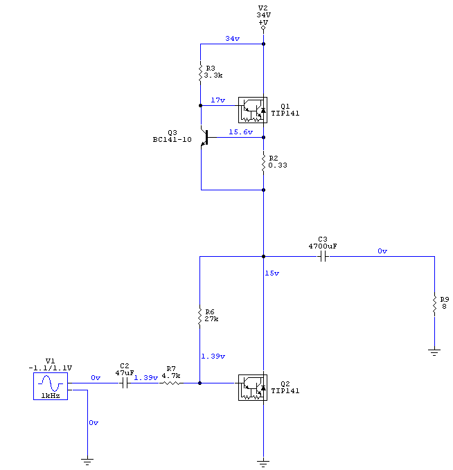

Here's a 15-minute design:
I didn't bother with a literal 1-transistor design: I knew from years of blunt pencils that the input impedance would be impossibly low, and bias would be too sloppy. So I used a Darlington, which is a lot like a single transistor with higher current gain.
Here is a SPICE-simulation run. Never trust SPICE, but it sometimes get the right answer on simple circuits like this. And from my experience, these answers are about right.
The top trace, 2.0V in, is giving 11.3V peak in 8 ohms, or 8 watts (for 178 Watts supply power!). It may not look like it, but distortion is 11% THD: 11% 2nd, 0.65% 3rd, 0.6% 4th, 0.2% 5th, under 0.05% 6th thru 9th.
The bottom trace shows how it will clip horribly, yet stay round on the bottom. Actually the bottom is badly distorted, much weaker than the original. It is more like "the shape of the transistor" (its Gm curve) than the shape of the input.
Also note that the input impedance is a little over 1K ohms, which many folks would call "too low". Not just that it is low, but it varies over the cycle.
Damping is not large, but may be ample for many uses.
Bias stability is poor (though maybe no poorer than the simpler Zens that need a trim-pot).
I made a small attempt to optimize operating point. I expected 8 ohm DC load and 20V collector, but it likes the higher resistor and lower voltage better. It could be a little better, but not a lot.
Much of the distortion could cancel push-pull. But then you have to arrange push-pull drive, still into an annoyingly low input impedance.
And historically: if any 1-transistor plan worked, in days when transistors were expensive, it would have been done. In fact there were 1-transistor megaphones, but they used carbon mikes (VERY high output and DC tolerant), ran DC through their speakers, worked poorly, sounded awful.

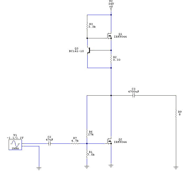

I've compared the BJT and MOSFETs in some simulations.. I such a simple circuit, the MOSFET seems to have about 6db less THD (0.5% cq 1% at 1Watt) , slightly higher gain, but slichtly lower output..

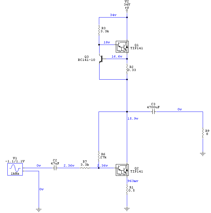

I just realized that the 0.5 Ohm resistor is'nt needed sich the upper transistor determines the Iq.. Allthough it does stabelize Vdc, but this is less critical..
The THD measurements with Spice of the MOSFET evrsion are very accurate, as most of the circuit performance parameters. I don't know if BJT models are as accurate..
Now I could raise the input impedance a little. BTW.. damping factor is higher compared to MOSFET version..

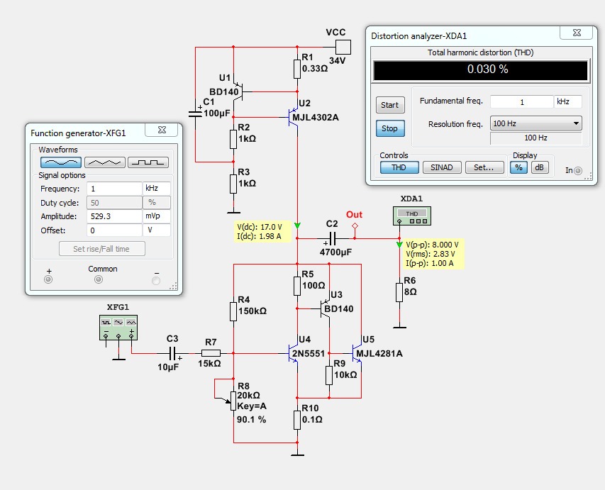

I use tripple darlington in my schematic.
The gain is x7.5.
The THD is less than a normal ZEN amplifier. THD = 0.03% at 1 Watt.
Reactions: 1 user
PRR
Joined 2003
Thanks, interesting design, but...
Quote from 2004?
THD "should" be lower because BJT transconductance is much higher than any other device.
Why is your R5 so small and your R9 so large? IOW U4 (1st stage) runs rich and U3 (2nd stage) runs lean; normally currents increase stage-by-stage from low-power input to high-power output. (Or is this to damp the radio oscillations of a triple Sziklai?)
