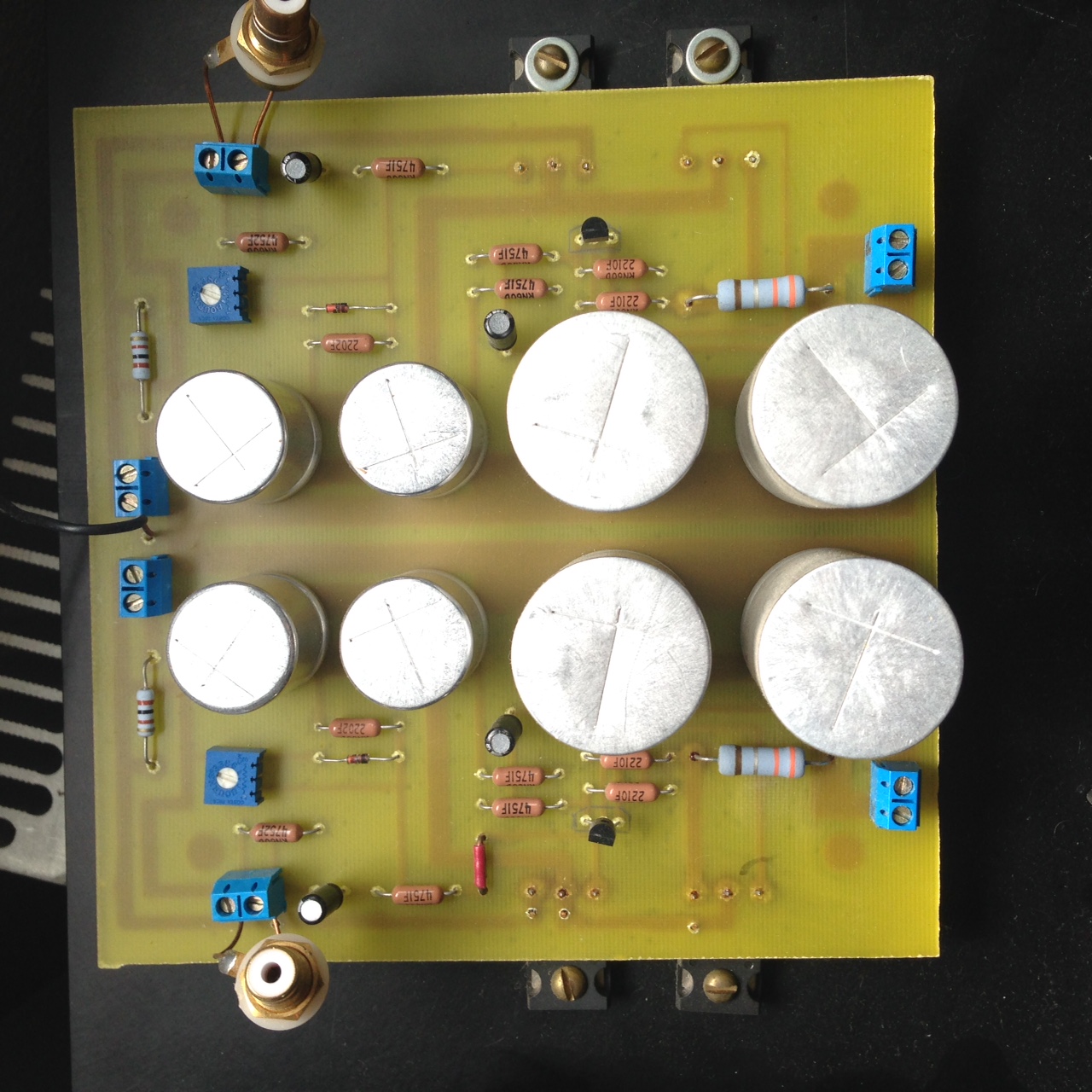

I build this one few years ago, penultimate with higher power, with all modern transistors. Sounds great.

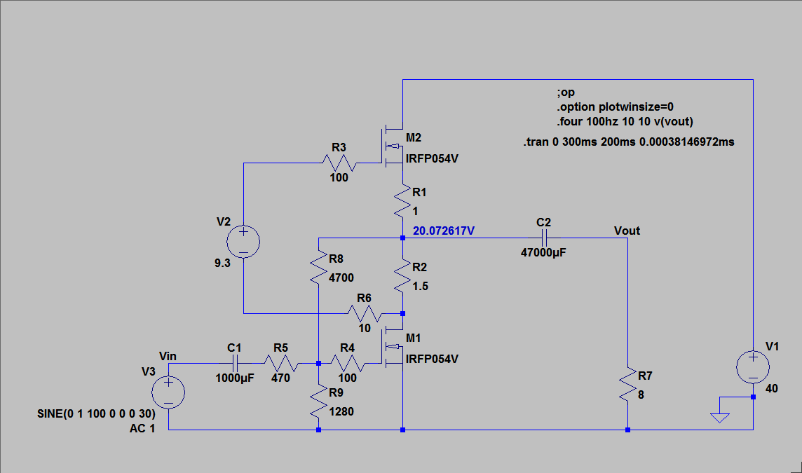

Here is a slightly simplified Zen amp with a mu/SRPP dynamic current-source based on a simple cheap 9 volt battery (V2).

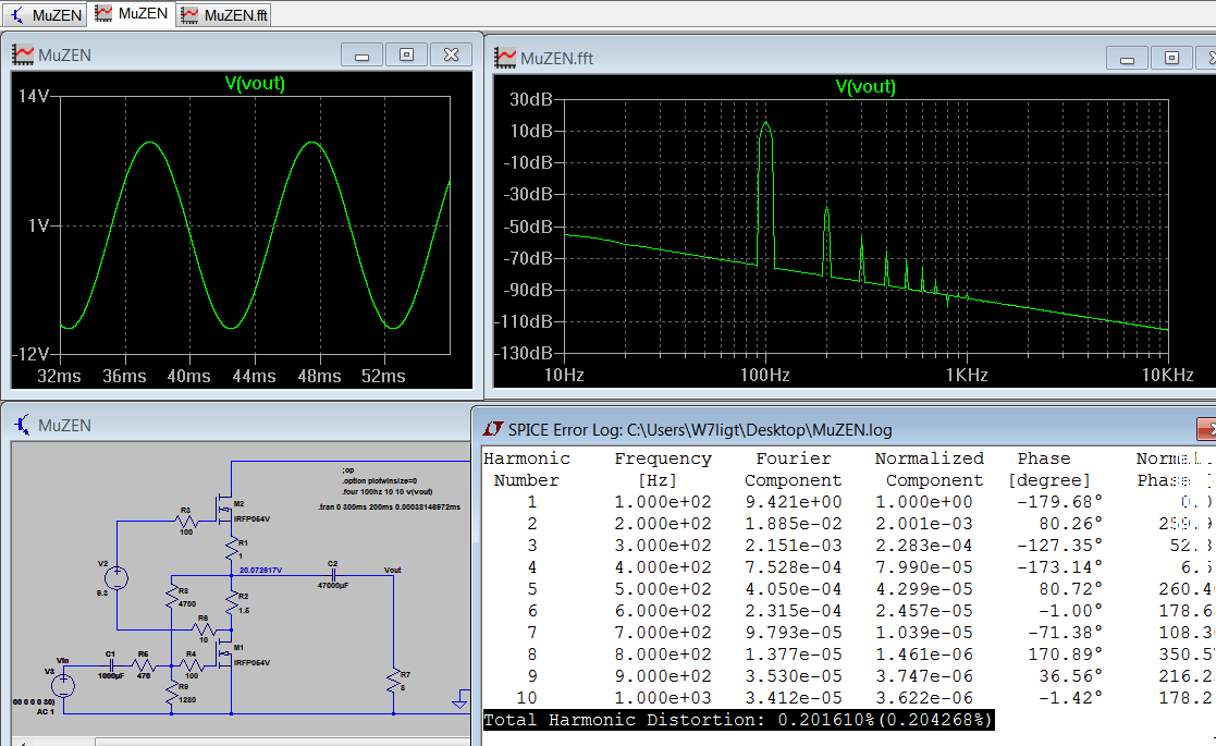

With two IRFP054 you get quite low THD.
LTSpice says 0.204% THD @ 6 watt output into 8 ohm load. With real speakers and real reactivity in the load I would be happy with 0.5% measured THD. This SRPP-Zen-amp simulates much better then the stock normal Zen-amp.
With slightly higher voltage over the sensing resistors in the SRPP current-source you get less distortion at lower output-power but the amp will start clipping at slightly lower output-power.
M1 and M2 can be IRFP054, IRFP064, IXYS IXFH110N10P Polar mosfet or similar.
I would without a doubt go with the IXYS mosfet. They sound absolutely superior in simple class A amps in my experience.
