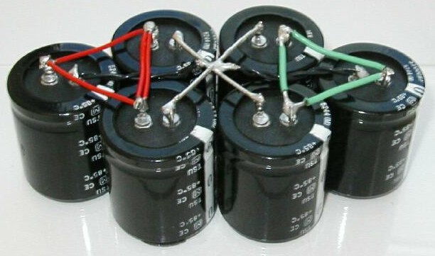

Caps
Can I have someones opinion on this issue:
If I decide to use two beer cans only the total capacitance will be 33000uF per channel. If I use all four of them on the first pic it will be 60000uF per channel.
My trafo is 800VA. Nelson recommends 25000uF per channel as minimum (?)
My case will be quite huge if I use four. Easier to build with only two of 'em.
1. Not a good thing to place the caps on top off the trafo ?
2. Do I get a better sounding amplifier using 60000uF per channel ?
:dunno:
1.
No idea if good or bad. But, my amp has four 22000uF caps arranged in a row about 1 inch above EI tansformer (300VA). I don't catch any problem.
2.
Well known is that the bigger the caps are, the smaller ripple and that the smaller the ripple is, the better. I however suspect the caps bigger than the amp designer's calculation would improve the sound.
Hoping this will help.
Here's a thought. If you don't mind having two boxes.
Put the transformer and one pair of caps in the first box, and the second pair and the amps and heatsinks in the second box. The first box can be ugly and hidden away, and it solves the possible problem of the transformer flux causing hum. I've also had a problem with the charging current peaks inducing hum.
You can add a small amount of resistance between the two pairs of caps (in addition to that of the wiring itself), to get a pi-filter.
Capacitors
I'm planning to use 33,000uF per channel on my Zen v4. It might be on the small side, but given that the v4 contains a regulated supply, I think ripple won't be a problem. It should still be very quiet. Though maybe the power supply won't be quite as "stiff" as it could be?
