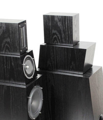

5 liters ? Maybe with some damped holes in the back. I may also mount the midrange slighty angled so that it is closer to the tweeter.
I used this trick in my Sonics Allegria speaker and got a nice off axis behaviour for free.
The midrange already a little off axis i got a more homogenious output over angle.

This is also a low difraction design but i used the minimum baffle priciple without any roundings. Nevertheless the speakers " disappear" well. In the ZDL i will try to go closer to the ideal.

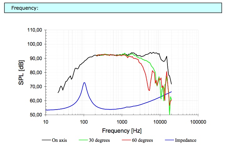

When you compare my measurements of the Scan Wideband to the measurements in the Scan Speak lab you can see that the samples i got have a higher breakup frequency. Maybe in the meantime they where able to improve the coating.

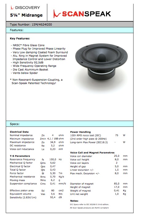

I looked at the specs of 10F/4424G00 a bit more, the cutout hole is only 3mm larger than what I normally see people call 3" drivers. Sd seems to be about the same as what I use, F0 is also about the same. So maybe 3 liter enclosure is fine. Calling this a 4" driver is exaggerating it, no?🙄The Scan wideband can go surprisingly loud. It has a very strong neodymium motor and a wide linear throw. When it reaches the end stop it makes a short burst of sound that is not too unpleasant but that has to be avoided though. I think for nearfield listening under 2m it will be loud enough. If that is not enough i have an alternative strategy with an aditional upper midrange dome from Morel and a 15cm midrange, also from Scan. I will look up the catalogs and post the specs. You have not answered my question about the volume for the Scan though.
Since the size is similar. I think the CSD is not so good as shown on Zaph Audio site. The flat on-axis response means more beaming at the higher frequencies. The driver I use was like that until we changed the dust cap.
Could you send me an ULR to the Zaph measurements on the Scan ?
I can not find them on the Zaph website.
Other then a small discontinuity in the 1 to 2kHz range i see no reason why the CSD should be bad.
That measurements look fine to me and my sample does not have the 8kHz peak. The energy storage over 6 Khz is normal and i will not use that range anyway.
