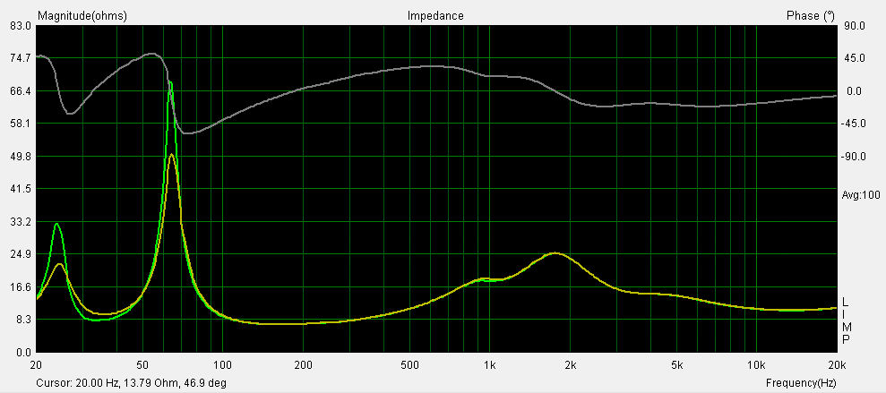

I've just setup my measurement jig for LIMP, so I gave it a go on ZD5. What came out is a huge mismatch in bottom end impedance curve. Could stuffing be causing this, since I double checked the crossover and imaging is spot on?

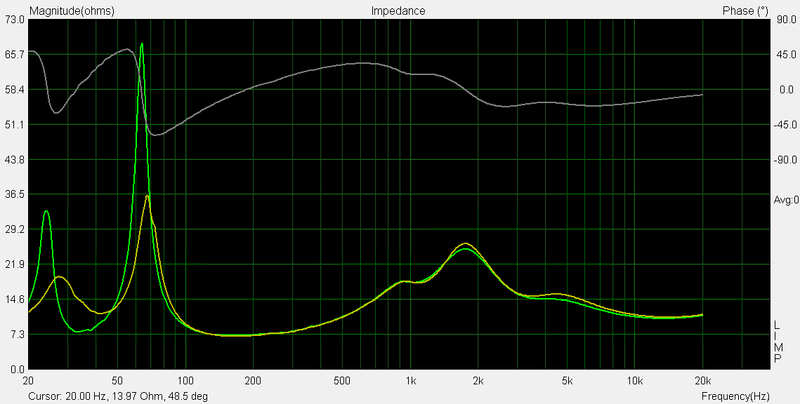

(yellow curve with more mechanical loss).. Could stuffing be causing this,..
Huh, I am really scratching my head on this one. Boxes and stuffing are now identical, and I still have a peak height mismatch. I even scalloped some more around the driver.
The one with higher peak definitely sounds more open and detailed. I am about to redo the crossover so that I can switch them between the boxes, to narrow down to box or crossover.
I don't know if it makes sense to switch XT25s...
