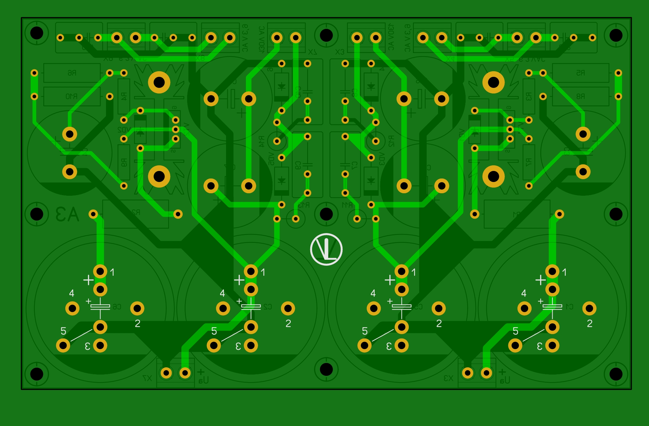

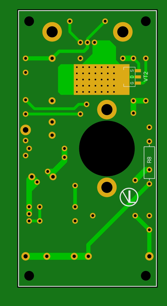

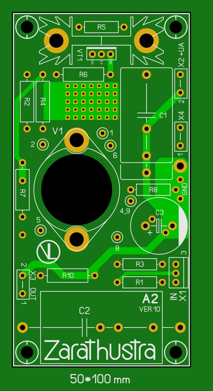

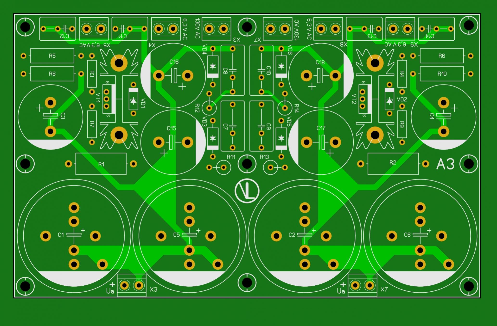

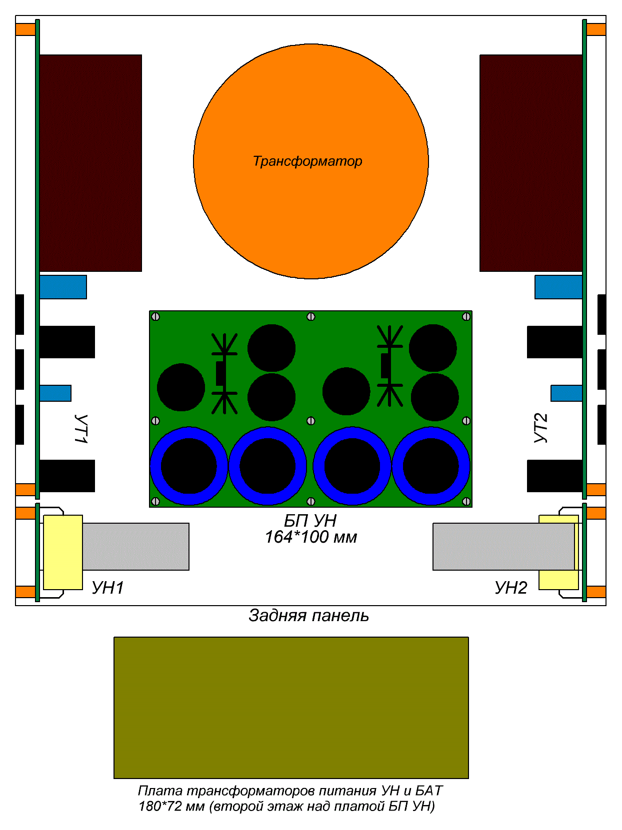

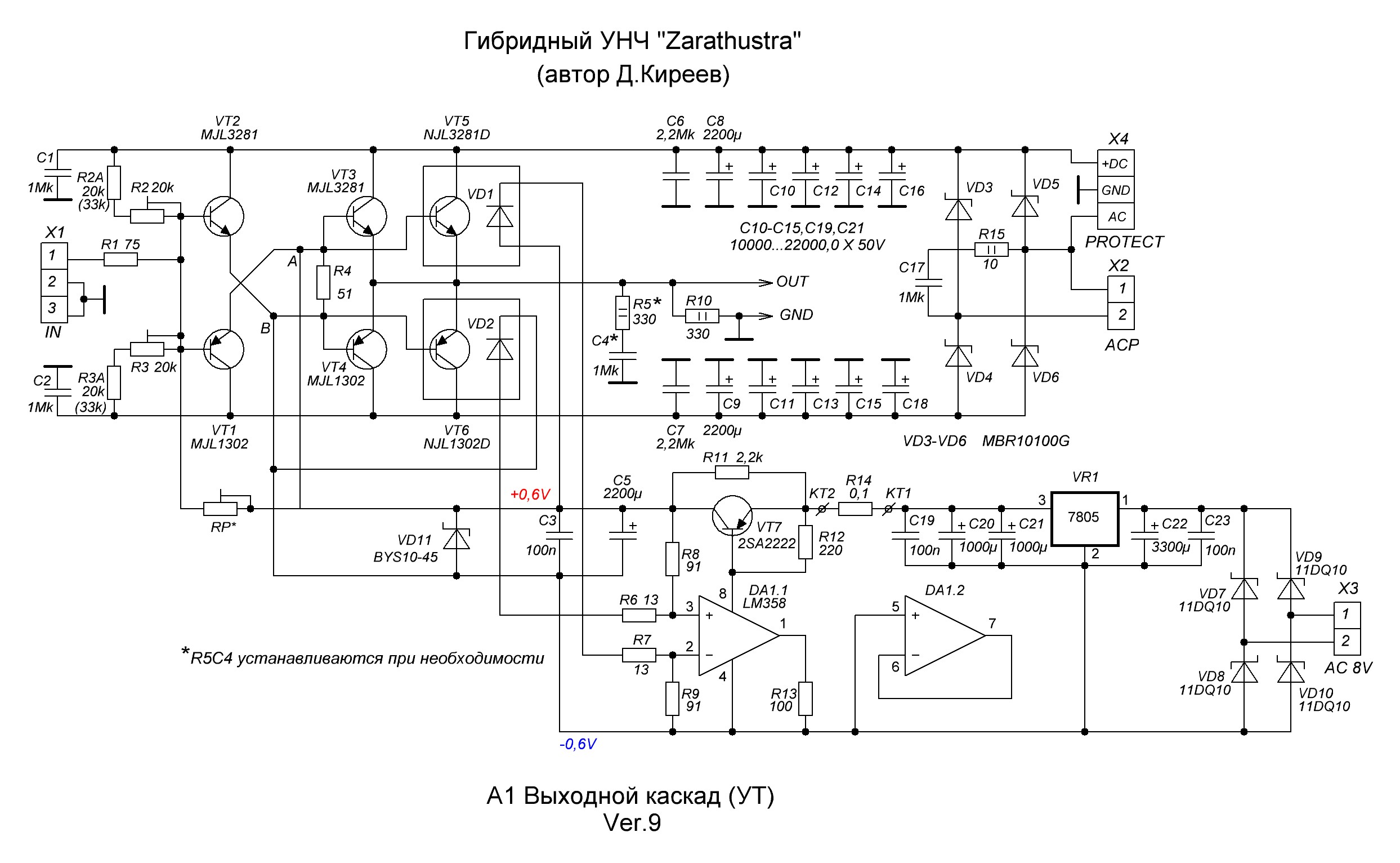

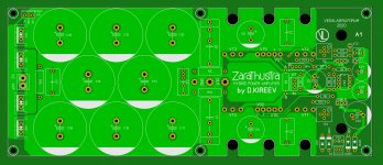

Hello everyone.

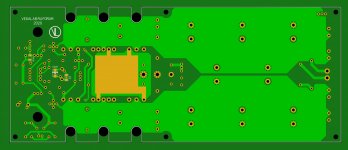

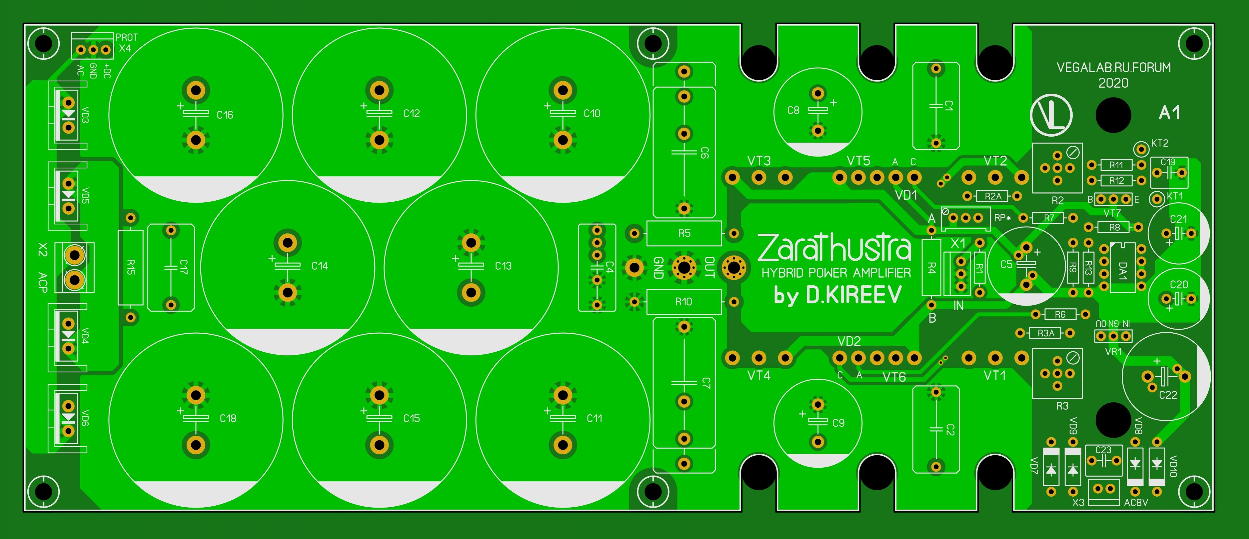

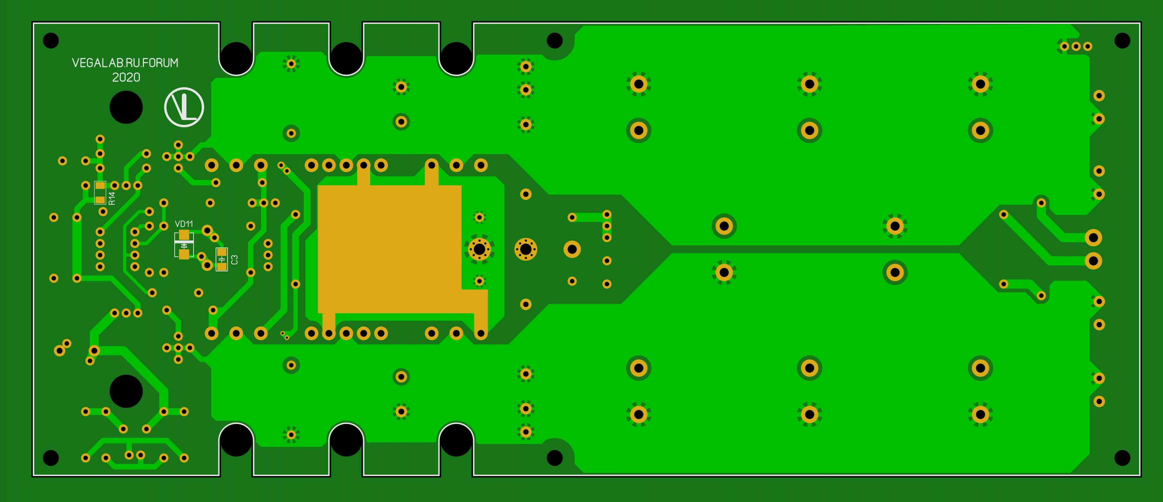

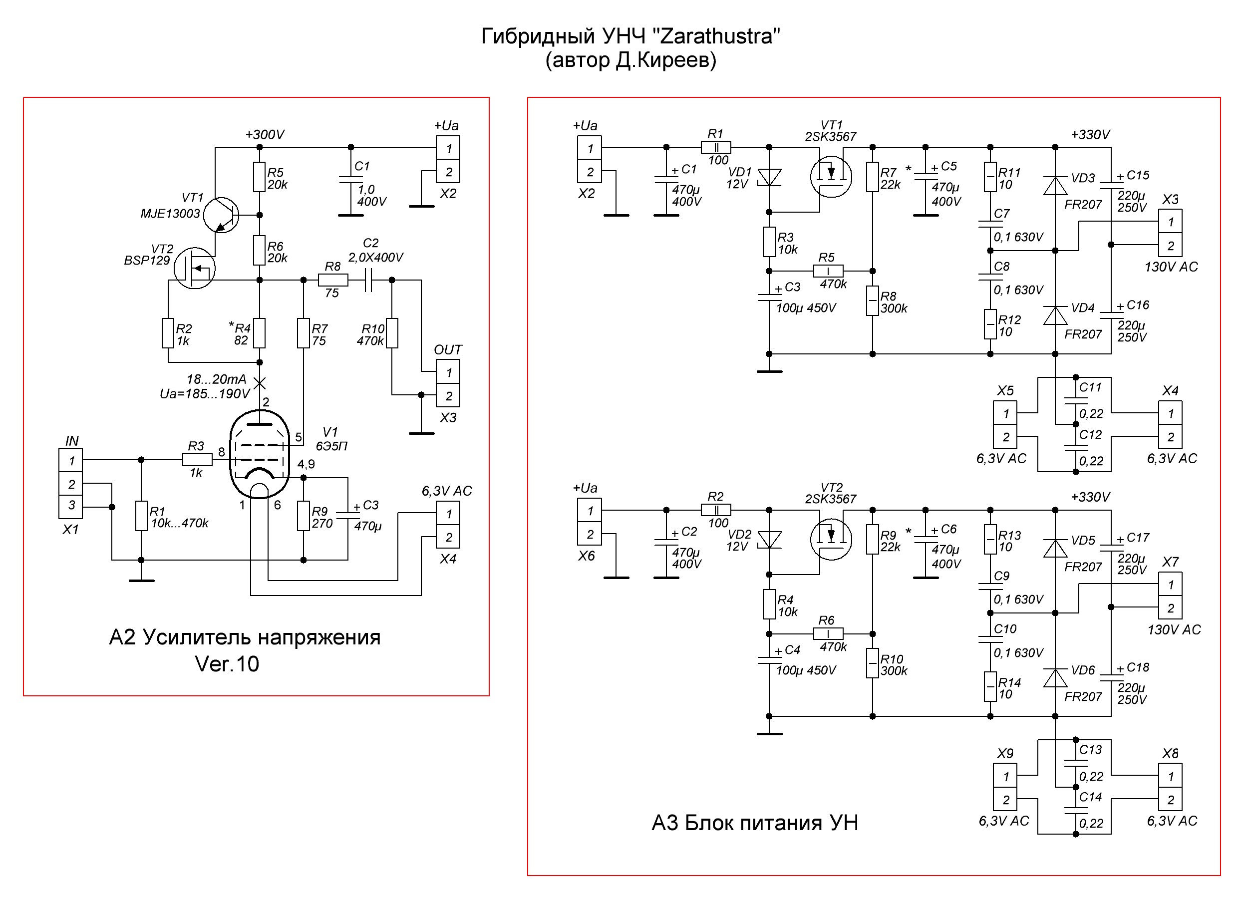

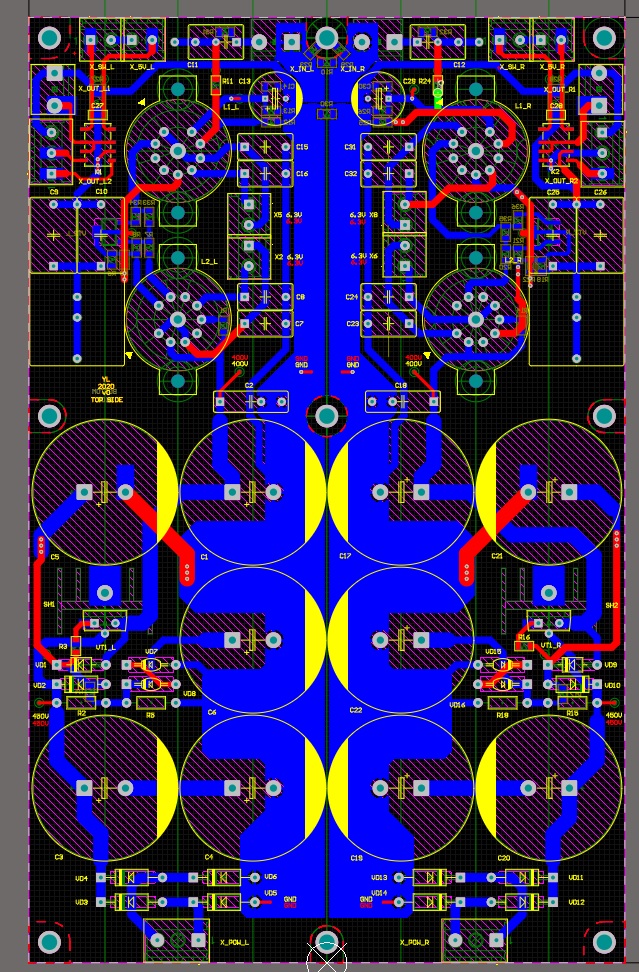

Perhaps someone will like this idea and he will want to assemble an amplifier according to these schemes or build his own individual design.
I would be glad if this topic is useful to someone.
Sorry for my English.

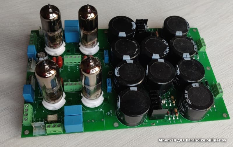

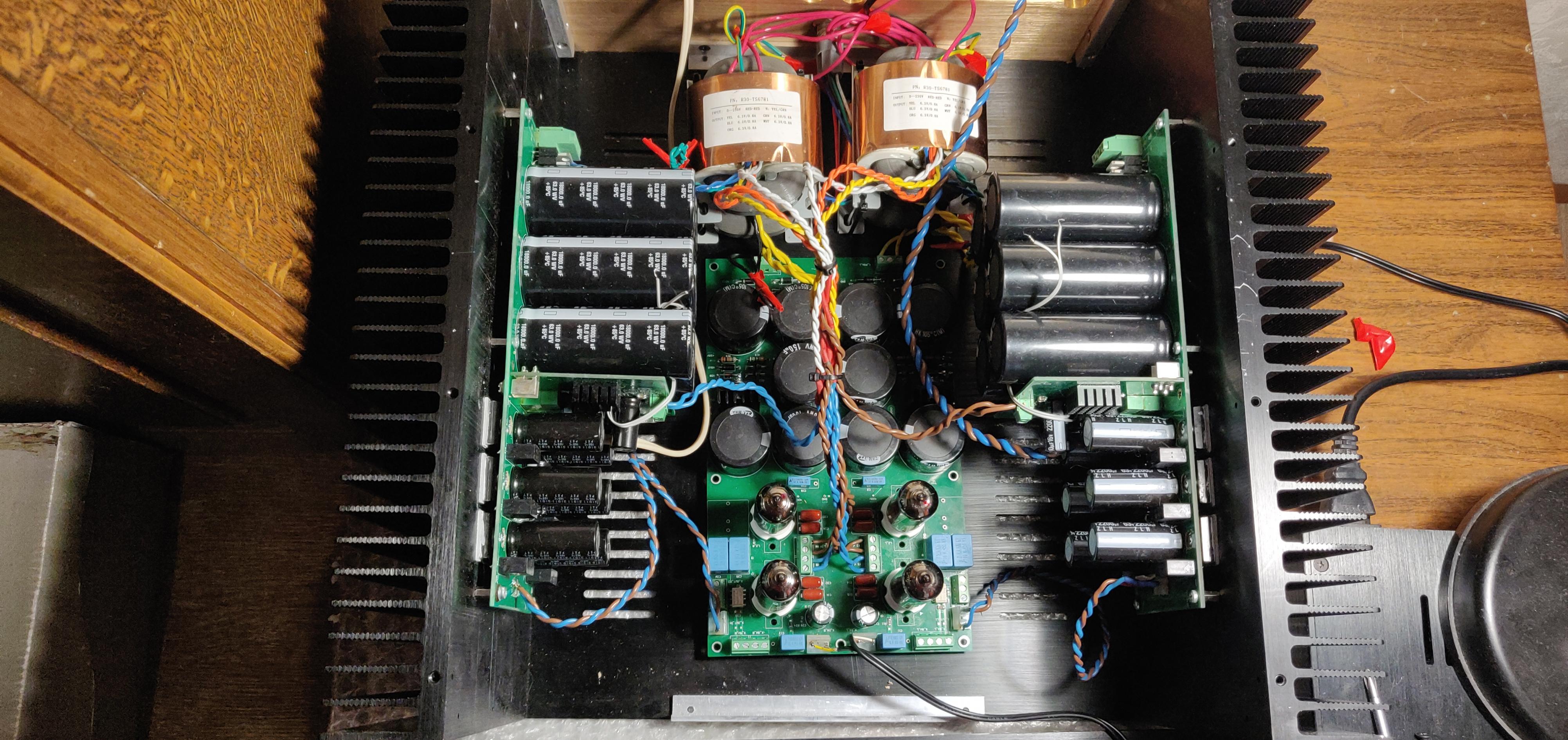

For example, a photo. This is a slightly different design, but the circuits are identical.
