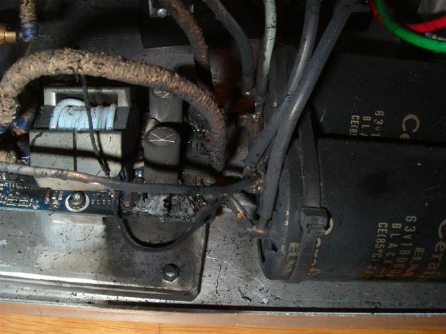

Speaking of this. When I woke up this morning, my left speaker was dead. It was a smell that was not to be mistaken.
One zappulse module had exploded totally. My zappulse monoblocks have performed flawlessly for several years but today - on my birthday-- :angel: , it was gone. I was really shocked how it looked inside the chassis. Not only the 2.2 ohms resistor but many more components was totally smelted and was all around the chassis. I will take some pictures and post it here.
I hope none of the speaker drivers have been destroyed.
Why not? Cannot see any reason why it should be turned off every day. If I travel I always turn it off. Some manufactures even suggests that the equipment should be on 24/7.
Here is a picture. Not a pretty sight.

Wow, that looks really nasty. I always turn my amps off. do not want to risk starting a fire in my house by keeping amps on while I`m not around.
Gertjan
One more picture.
BTW: The preamp is fine, I will analyse the PSU later.
I have blown a couple of speaker elements some years ago. 2* Dynaudio woofers, and 1* Scan Speak 10" woofer. That was because of a faulty v4p psu module from lcaudio. Returned it, and made my own psu. Never had any trouble later. Until today.
bambadoo said:
One more picture.
Are those ELNA Cerafines OK? I have them in use as well. Hope they were not the cause?
Gertjan
