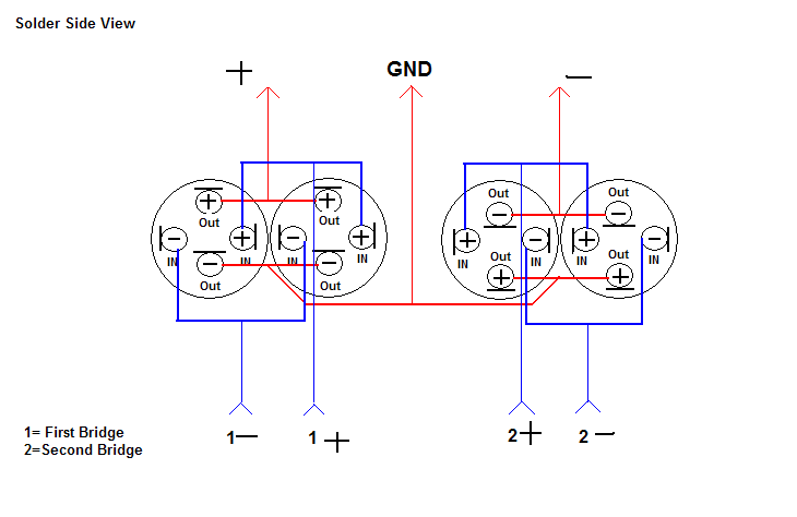

classd4sure said:Hi,
I still haven't tested this, still wiring. I can sure recommend not trying this P2P, some kind of fire/shock hazard!
I'm using 12AWG solide core.
Hi Chris
Nice diagram. That is the exact way that I thought you would be wiring them up. Whew ... 12awg solid wire will be a bit of a handful. I think that it will be worth it though?
Yes and don't want no kind of fire/shock hazard in the PS thankyou very much.
Look forward to hearing the results

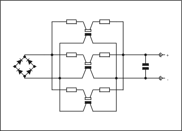

Lars Clausen said:
Well the V4P setup was originally designed in 1996 with the purpose of replacing real 4 pole caps, such as the T-Networks.
However KLe's idea of combining the two is not that far fetched.
T-Network caps in parallel will not give an intrinsic solution to simultanous charging and discharging, and thus may also suffer from current wobbling. In fact i cant see how you can device a solution with simultanous charging and discharging with T-Networks alone, not using the V4P circuit. So the V4P circuit is just as applicable to T-Networks as to normal caps.
Actually the two technologies combine nicely. There is a bit more wiring involved, but it shouldn't be a big problem.
See below:
That looks like two resistors in series on either side of the foil, couldn't you do away with the one on the output ?
Chris
No, it's about making one capacitor 'invisible' to the other cap, so to block charge transfer from one cap to another. But still allow charge flow to the amplifier and from the rectifier of course.
The moment you do away with the resistors on the output, you have no control over where the amplifier takes the most of it's power from.
Lars Clausen said:No, it's about making one capacitor 'invisible' to the other cap, so to block charge transfer from one cap to another. But still allow charge flow to the amplifier and from the rectifier of course.
Isn't the purpose of parralled caps to create lower impedance? Wouldn't the resistors increase resistance instead? What kind of value would be the balance?
soongsc: Maybe i can illustrate it by an analogy:
You are builing a car, and you want more power than the one engine can give you. ( = lower impedance).
So you put in two engines, and connect the drive shafts together.
Now you have more power, but now you have no control of the powerflow in the two engines. If one engine sparks a millisecond before the other, you have a huge amount of power flow from one engine to the other. None of the engines have optimal op conditions.
So in this case we have solved it by connecting the two drive shafts through a soft joint ( = the resistors) The power flow now only goes from the engines to the gearbox, and no power is transferred from one engine to the other. I think you can imagine in this imaginary analogy, that the engines now work smoothly together, to provide a clean driveforce.
