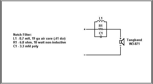

Hello,
can anyone tell me if these are the same values that Zaph used in his notch filter for the Tangband W3-871?
6.8R,
3.3uF
0.7mH air core,
were there any special requirements reguarding the inductor DCR?
Thanks if anyone can help

Hi Mark,

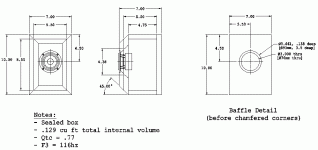

According to his article, and if you're using the first box suggested then the notch requirements are:
L1 - 0.7mH, 19 ga air core (.41 dcr)
R1 - 6.8 ohm, 10 watt non-inducitive
C1 - 8.2 mfd poly
The second/third boxes use C1 - 3.3 mfd poly
If you haven't got the article then email Zaph, I'm sure he'll email it to you, or I can email it you for that matter if Zaph has no objections.
I am building the one shown in the diagram below.
It would be nice if you could send me the article, for some reason I only saved the box designes and not the crossover designs, probably assuming that Zaph wouldnt remove them from his website.
Mark🙂
