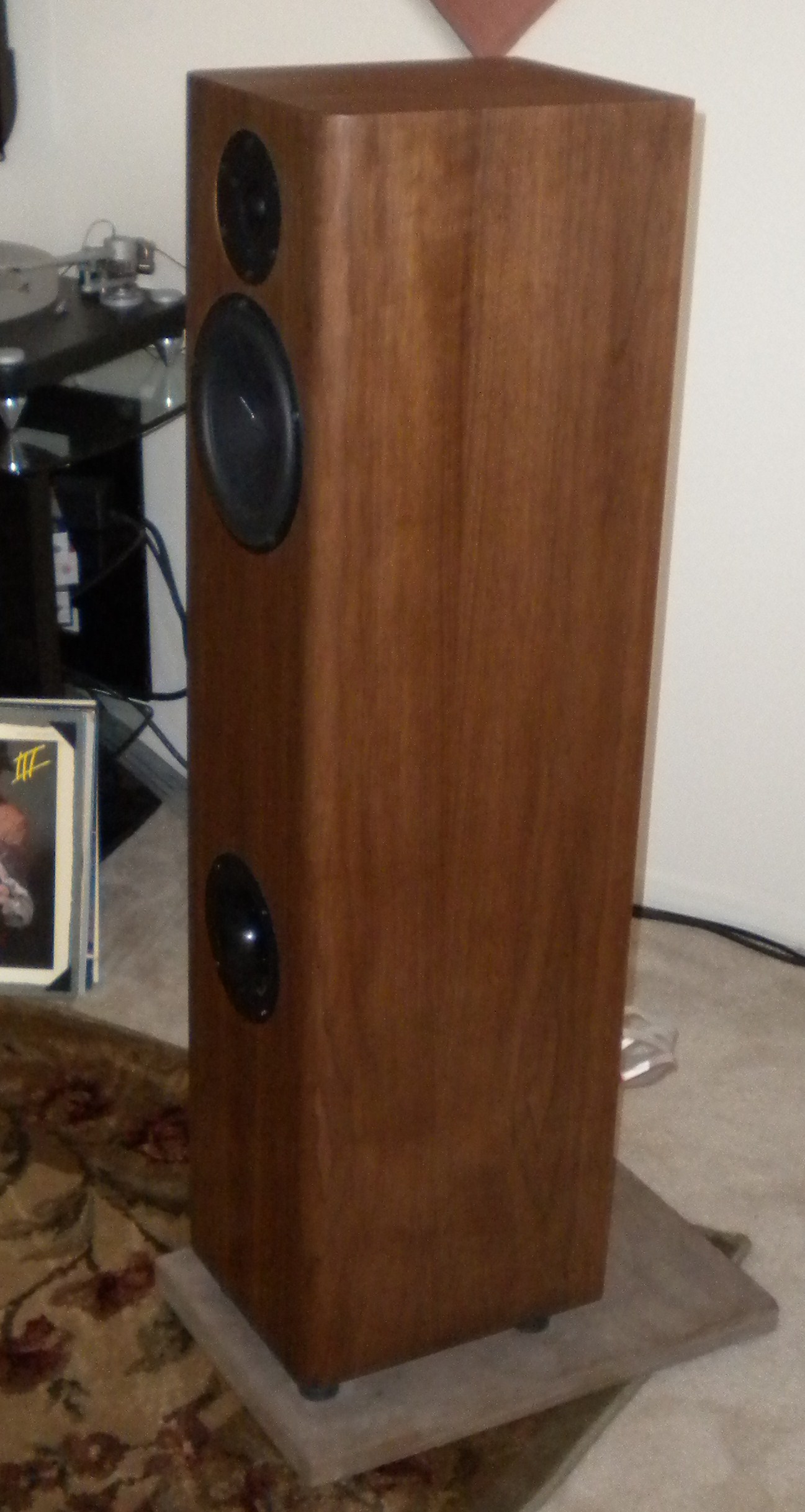

hi franco , I strongly suggest reading Zaph's "2-way options" for this build. I ended up cutting out the woofer coil after completion and unwinding it to 2.2 mH. At 2.7mH the midrange seemed a little recessed on most pop-rock cds in my room.
For the woofer coil I used 10 ga air-core from North Creek Music.
I've had these speakers 6 months now after Maggie 3.6Rs and have never looked back.😉
regards,tom

Right, i've read this part of Zaph's reccomendations but i'll wait to hear the results of original values in my room and then eventually i'll make changes according to my tastes. Probably i'll go for reducing the coil value anyway, I normally like a more forward-sounding speaker. Once the burn-in has ended, i'll go for tweaks (woofer coil and probably tweeter series R adjustment).
You wrote that in your speaker you use an (huge) AIR coil. This coils are really expensive and really thick wired... why have you choosen this way and not a cored coil?
Are ferrite core/transformer coils not enought for your purposes? Do you think that the difference (distortion, core saturation) is worth the extra expense?
Thanks for your feedback.

yes -they were expensive and worth it. I wanted air-core after reading about hysteresis losses and the ability of coil to change it's magnetic field with the signal. As long the desired DCR was met-I was willing to pay.
I wonder if any hi-end manufacturer uses 5- 8 lb inductors with their woofers?
Thanks! 🙂
