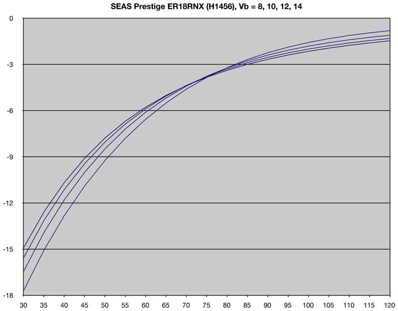

I rewrote the spreadsheets to compare multiple volume options, I and played with versions of the formulas in Mathematica. The bottom line is this: Enclosure volume doesn't matter that much. Larger enclosures are described as "leaner, deeper bass". That's a wine tasting notes version of "it's the bottom curve at higher frequencies, and the top curve at lower frequencies" in the graphs that follow.
I give response curves for different enclosure volumes, for this woofer and the woofer used in the ZA-SR71 speaker project. Clearly, this woofer is larger, and has better bass response.
The curves don't all cross at the same point. If so, this would be a very interesting way to classify woofers for sealed use, as the curves all have the same shape, so one could guess the curve from the "pivot point". However, one could use the approximation given by where the curves cross for two reasonable Q values, as a way to classify woofers. I'd love to see this plotted for either the Madisound or Parts Express catalog, or Zaph's next woofer survey.
The Linkwitz Transform itself is clever, but soon to gather dust as time marches forward. Many of us are moving functionality to the computer source that used to require physical components. For example, a preamp now just needs to attenuate, and there are many other ways of doing that. One can now bi-amp with the computer as crossover. A useful calculation would be the best single parametric equalizer that boosts and flattens the bass response of a speaker, as measured in actual use. I find myself wondering if a speaker port is a clumsy mechanical gimmick, and instead all speakers should be sealed and digitally equalized?
In any case, here are the graphs, and my version of the spreadsheet:

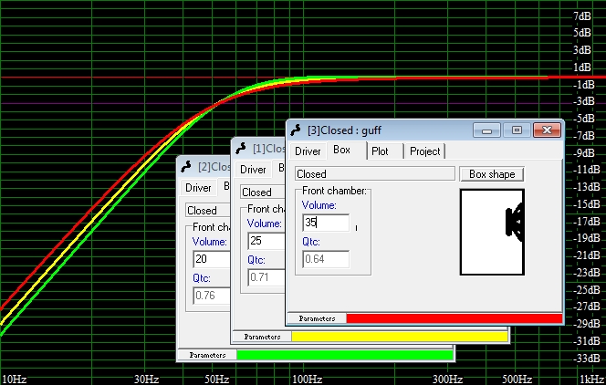

Your not telling most of us something we don't already know, and can
knock up in about 3 minutes using any drivers given Vas, Fs and Qts.
WinISD is the simplest quickest (free) tool.
anyway back to the ZRT, 49.5L, 30.4Hz and 0.41.
Attached are the options.
Very straightforward, 1cuft or 28L will be more than fine.
1/4" extra width on a rounded baffle is fairly meaningless.
rgds, sreten.
