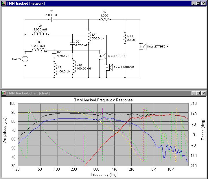

In the efforts of simplifying the TMM 2.5 way Zaph designed....
What would happen if you took the original woofer circuit in the TM design - and duplicated this circuit for the second woofer, increasing the series inductor for W2 to allow for BSC?
Impedance doesn't change significantly through the xover region so I'd expect the crossover point to stay as designed. Modeled phase alignment seems to hold true (well consistent with what speaker workshop predicts of on the original TM). Minimum impedance (not shown) is approx 3.3 ohms around the 100-200 Hz region.
Have a look at the following, and please feel free to point my lack of knowledge / ignorance (I'm just learning!).
Thanks,
David.
Thanks,
David.
