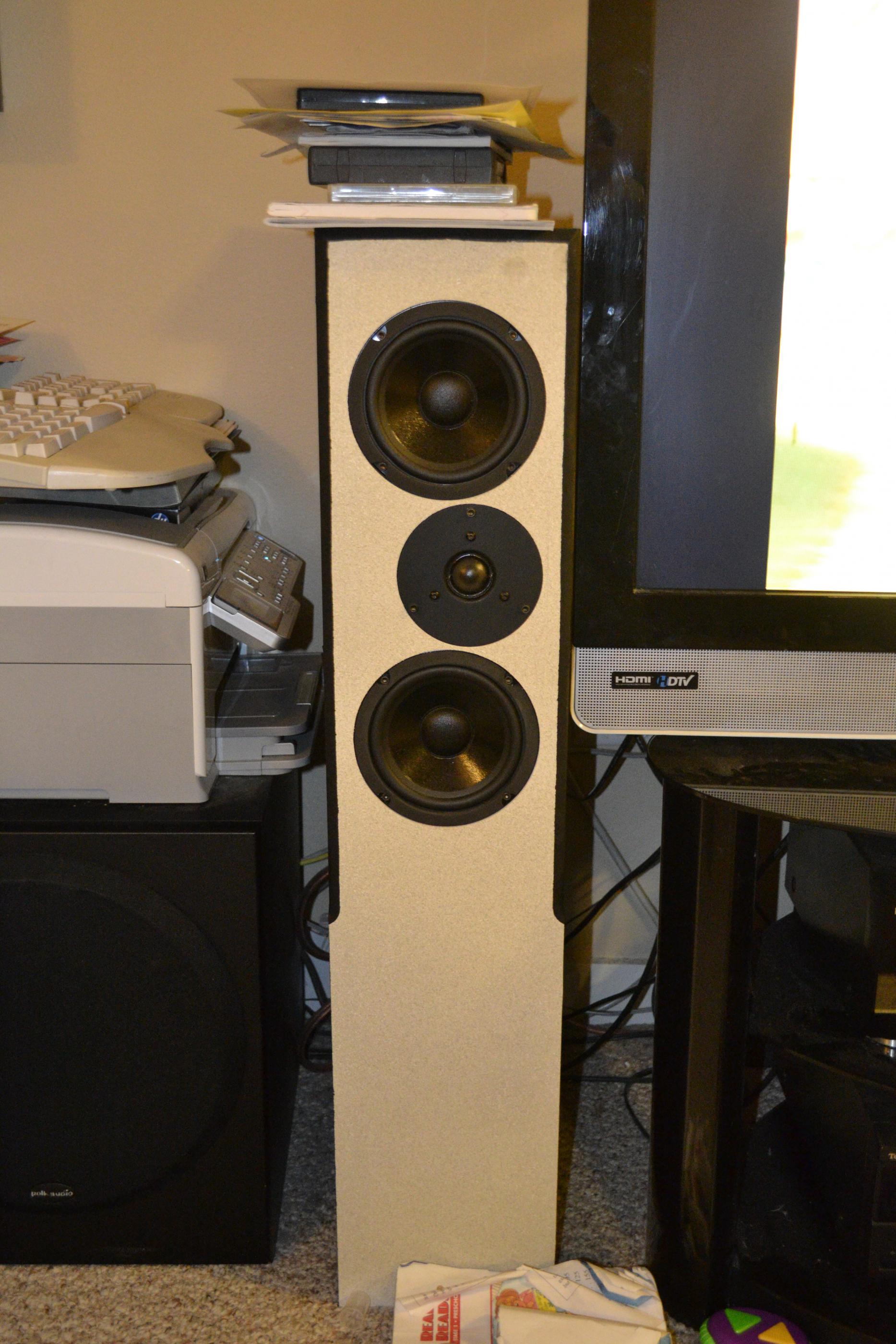

I've built the 5.2 ported, 5.3 MTM and 5.3c center.
Unfortunately I haven't got any other builds complete yet. And I don't feel a need to.
Within the restrictions of a 5" mid, the ZA5s simply rock. The MTM play louder than the TM, of course. They'll be going in my office.
Overall I'm really impressed with them.
Between the tritrix and za5, you still need a sub. I'd never hesitate to recommend the za5.2 for a small system and the 5.3 if you have room to pull them off the wall a foot or more.
Sorry I can't be more objective, but I felt the value was very very good on the za5s. I built my own boxes though.
Don't have any better pics sorry. I'm also not a fan of the mahogany (was free) or the 45* straight bevel. This was a crash coarse in woodworking. 🙂

I like your mahogany actually, awesome it was free. That bevel doesn't bother me either. You could have done MUCH worse. Looks great to me 🙂
Thanks for posting. I'm still very much considering the TA5.3 MTM's at this point.

I built the Tritrix MTM TL's and those sound really good for the money as well. I'd build another set of the sealed Tritrix for my HT application but I want to do something a bit different this time.
After reading through more of your post, are you just looking for a 2.1 application? If so, the Overnight Sensations might be a good option as well. Fairly cheap and they sound very good for the money as well. You can see those on the link I posted if you click on the DIY part at the top of the screen. I like the Swopes because of the front port, mine will be against a wall. The Overnight Sensations use a rear port so they'd have to be spaced out from the wall behind them.
