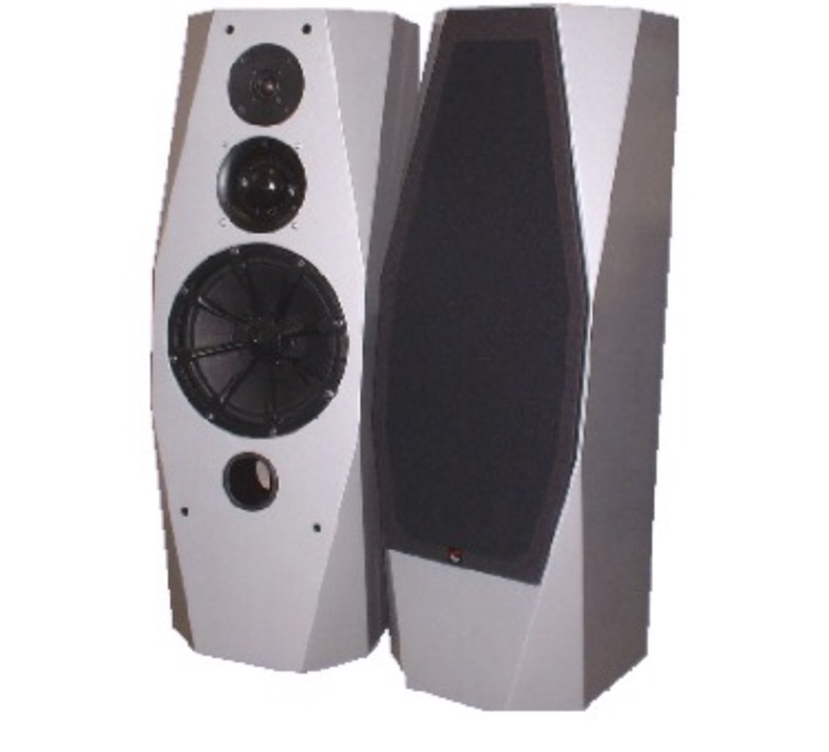

Hi there,
Thanks for taking the time to reply, I was looking at Osborn Audio and that is true they make similar speakers what’s mean they not to pretty, except slim version :)
I was thinking about the design from that photo below my post of course with Zaph 12.3 speakers placement, what you guys thinking it’s possible?

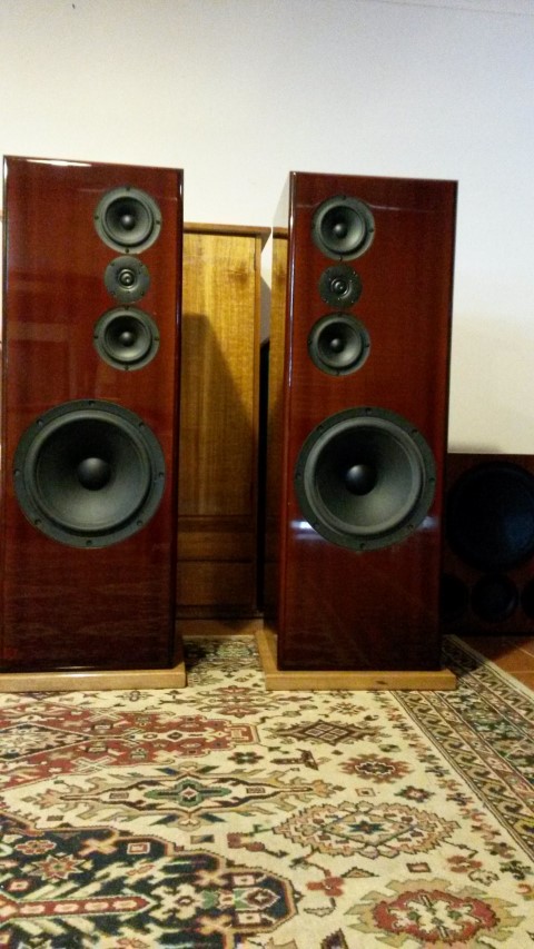

Hi Smithie I have built the SB 12.3 and love them, Big clean soundand the bass is very clean and tight but not over the top. I think some people expected more doof but there not like that.

That would probably change the sound too much.You would need to redesign the crossover for that baffle arrangement..Troels Gravesen emphasises that you cannot change anything about his baffle designs without changing the crossover to suit.
I am a furniture designer/maker.There are things you can do to make things that shape look less bluff.A name badge positioned about half way between the bottom and the woofer would also help.As would a recessed plinth type base.
Lovely to see somebody take the time and have the skills to french polish.
I have done small pieces but nothing that size!
They look great.
Would have been more impressive modeled by a small women though!
Kylie Minogue would have been perfect.

As other members have stated, you will need a new crossover if you significantly change the cabinet shape, or the driver locations on the front baffle. Zaph even warns about moving the MTM drivers to the baffle center line from their current 3" offset.
Because of the polar pattern from the MTM alignment, Zaph also recommends placing the SB12.3 speakers with about 5-degrees of physical tilt-in, which means Zaph wants you to listen to the SB12.3 MTM off-axis.
I have not modeled nor simulated using the MTM on a narrow front + side woofer design. Posts on this thread discuss TM designs with modest diffraction cabinets which integrate well with the SB_Acoustics SB34NRX75-6. Posts discuss proven TM designs with a 6" midbass and 1" dome tweeter which can be "low risk" converted to a 3-way similar to the "The Kairos and Continuum Three-Ways pdf"
Your dream speaker picture is the 3way TMW Wilmslow Prestige which uses a ported 12" woofer with a 311mm frame vs. the 364mm frame on the SB-Acoustics. If you favor this Avalon style truncated pyramid cabinet using a sealed box 12" SB34NRX75-6, you should study 6" midrange options like the
$75 SB17NRX35-8 with paper cone, SBMFC35 plastic, or $150 Satori MR16P papyrus cone plus short coil.

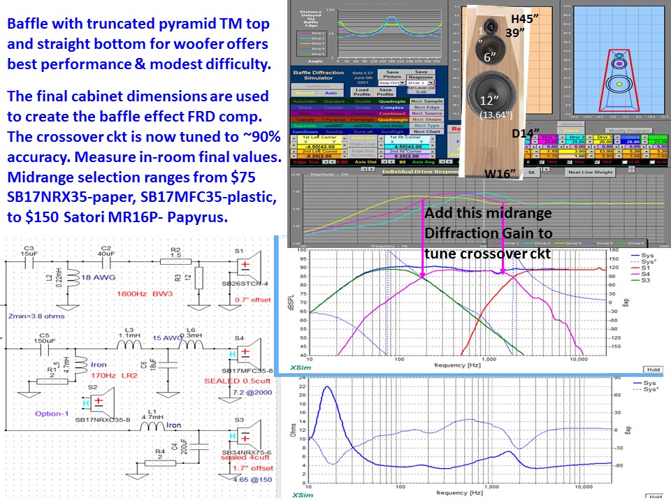

If you LOVE the ATC cabinet style, you could look for a well reviewed 3-speaker, 3-way design which fits that shape and volume. It is desirable to have the tweeter around 36-39" high. Good ear level, and then typical tweeter dispersion also covers standing listeners. A SEALED 4cuft volume for the 12" SB34NRX75-6 delivers -F3 ~35Hz with SPL ~87db after a modest baffle step. Replacing the two 5" midrange with one 6" is a better match for the ATC cabinet.
1.1" Dome SB29RDC-4
6" Satori MW16P-8 or lower cost SB17NRX35-8
12" woofer SB34NRX75-6
There are several free designs using the SB29RDC-4 tweeter and SB17NRX35-8 or MW16P-8 midranges to which you can add the 12" SB34NRX75-6 woofer. An LR2 electrical circuit works well because the Le=1.8mH for the SB34NRX75-6. I can post examples if you go down this path.
You can also Bi-Amp with an active crossover for the woofer. For the best sound, the crossover must be tuned to the baffle shape, woofer height, and room placement.
Meniscus Audio has a few 2-way kits like Jeff Bagby' Adelphos and Mandolin, plus Jeff's write-up on extending them to 3-way by adding a woofer.
What is your budget for raw speakers + crossover parts?
