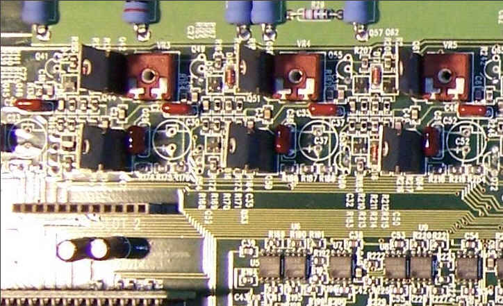

Finally installed the two A06 and two A56 SMDs on the problem channel. I circled them in the pic. Also, gisewhcs, the fan needs to blow into the amp and it does speed up when the volume goes up. I made a short vid of the amp working in my car, sounds decent. Thanks for all the help everyone. 😎

They are old and they ohm out ok but with them in circuit the amp struggles to start. Plus these boards are so fricken delicate, when I was pulling two of the caps, two of the circular feed through that sits in the hole came out. The positive rail has the main trace in one of the inner layers and that sucks to fix. The ripple with the old caps was about 30 mv, now its down to 2 or 3 mv. I may get larger value caps at a latter time.
