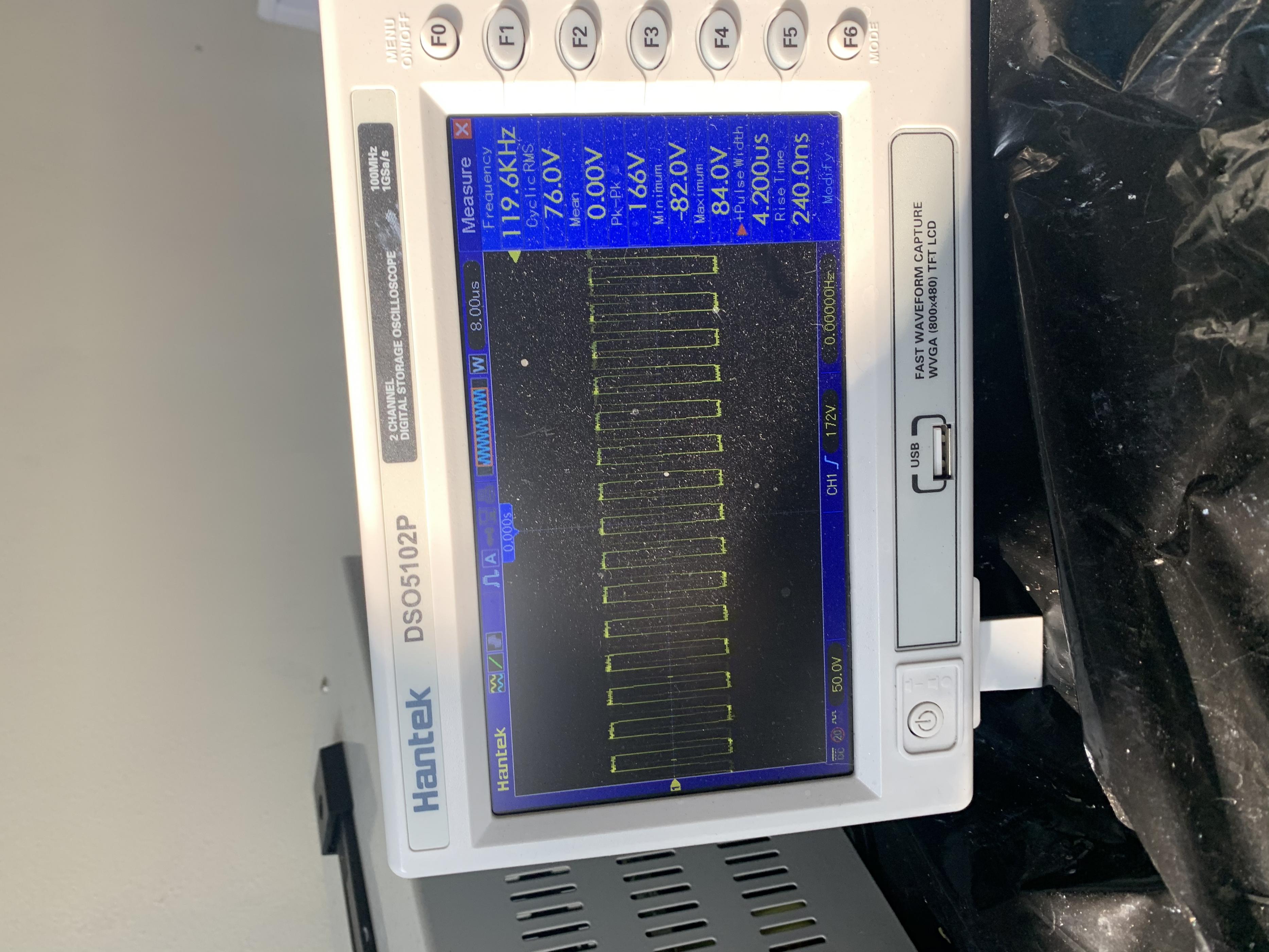

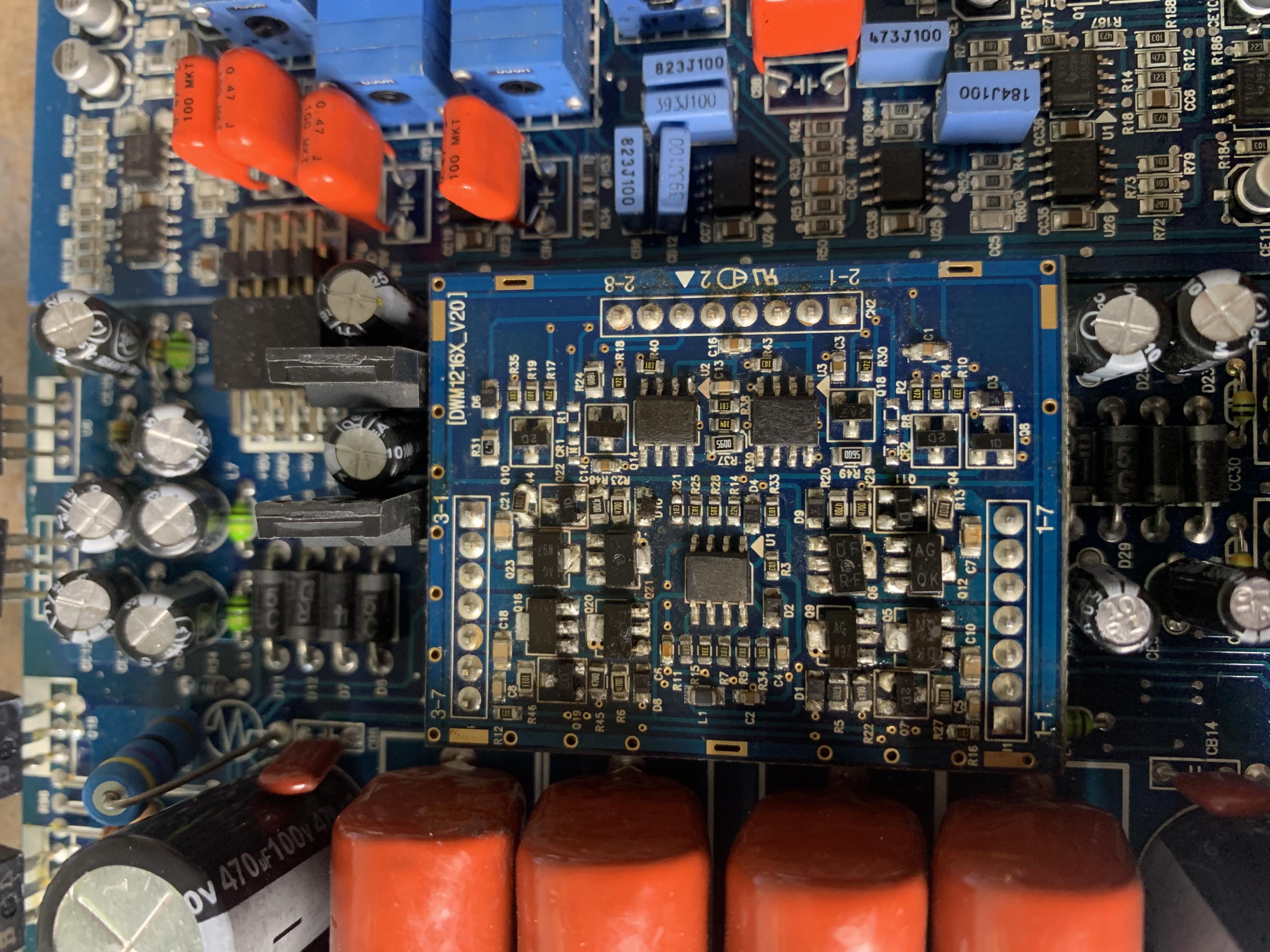

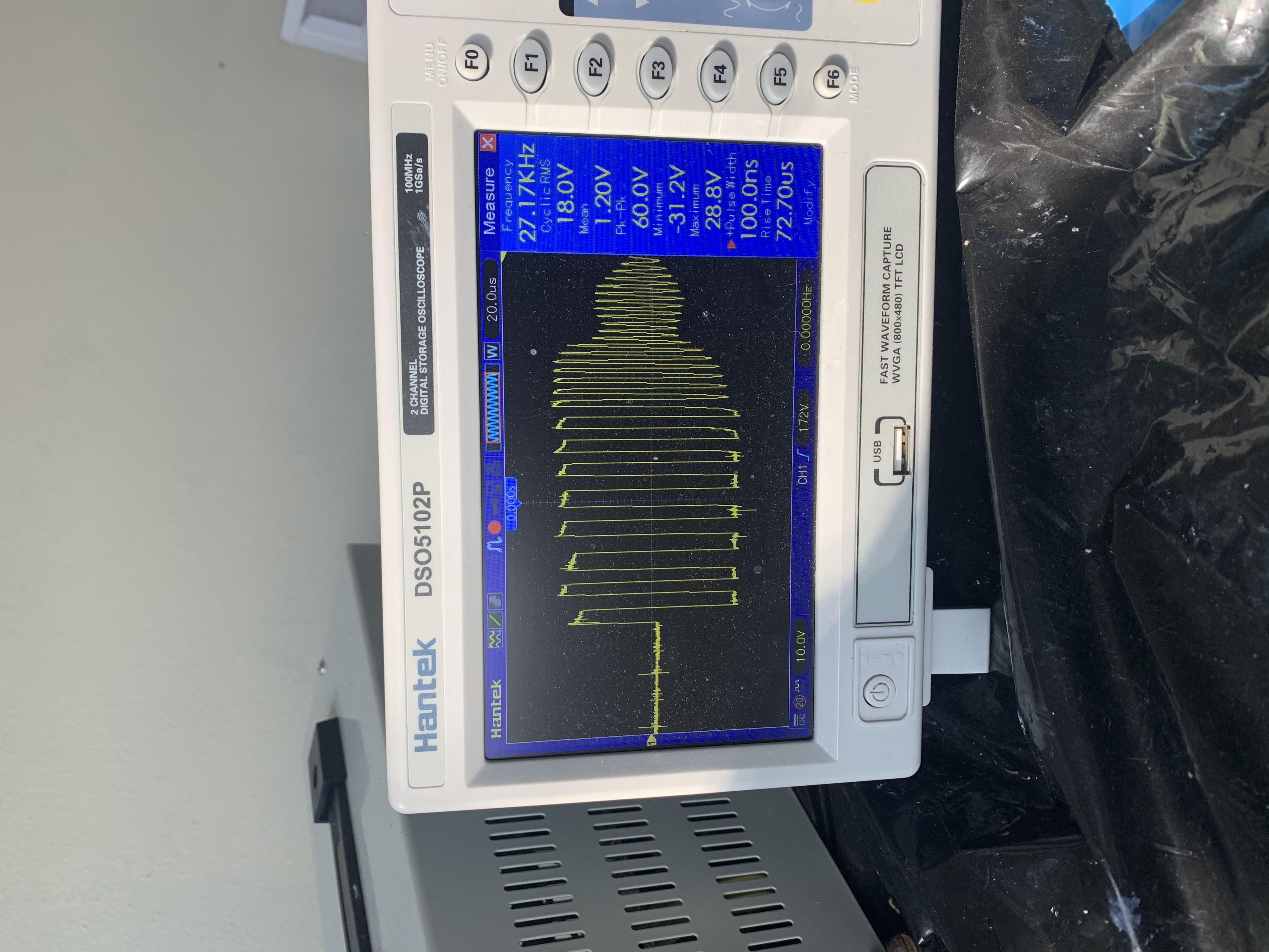

Remove all of the outputs that are being driven by that side of the driver board and reinstall Q7 and Q11. Do you still have r-r oscillation on the other bank?
Is R13 within tolerance? Have you confirmed that the other resistors in that area of the driver board are within tolerance.
Are Q7 and 11 new?
Are Q7 and 11 new?
