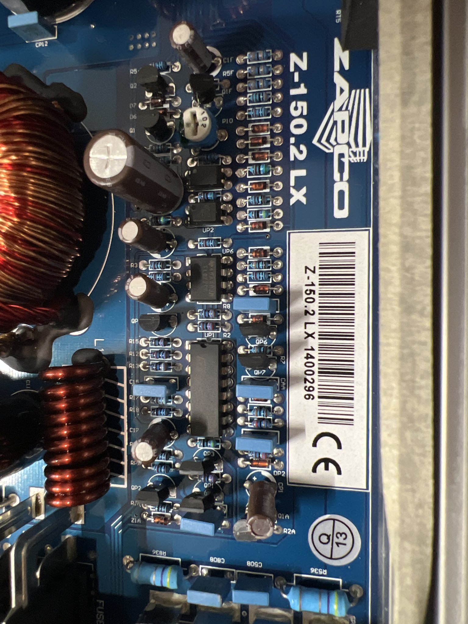

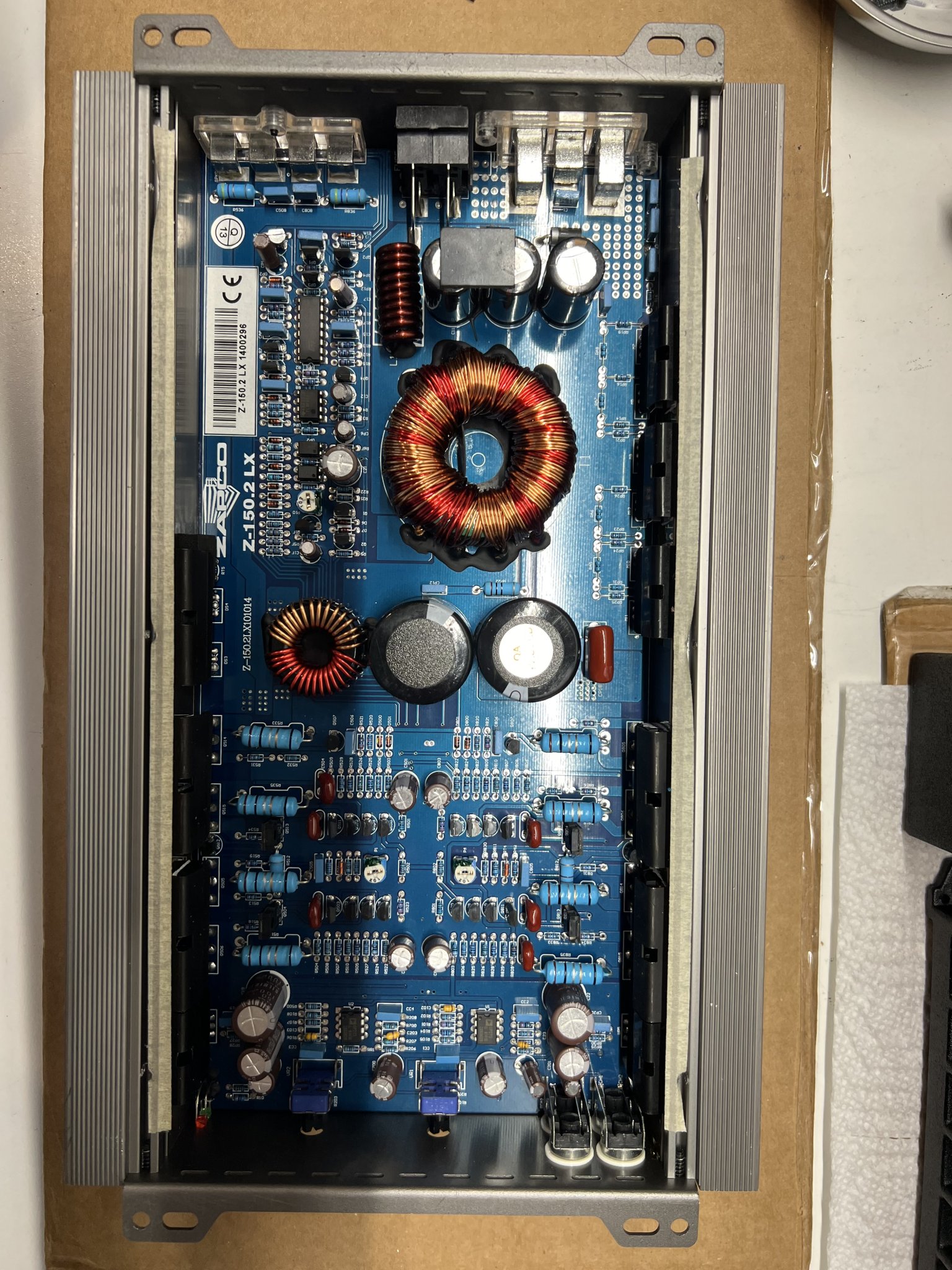

Zapco z-150.2 LX
I have 40v of rail voltage on all the out puts

Do you have DC on either of the bridging speaker terminals?
If not and you connect speakers to the two channels, does either channel ever produce a pop or loud click?
If it will power up, does pushing/pulling/twisting thee various components change anything?
Does heating/cooling (inverted canned air) change anything?
Why aren't you switching remote?
