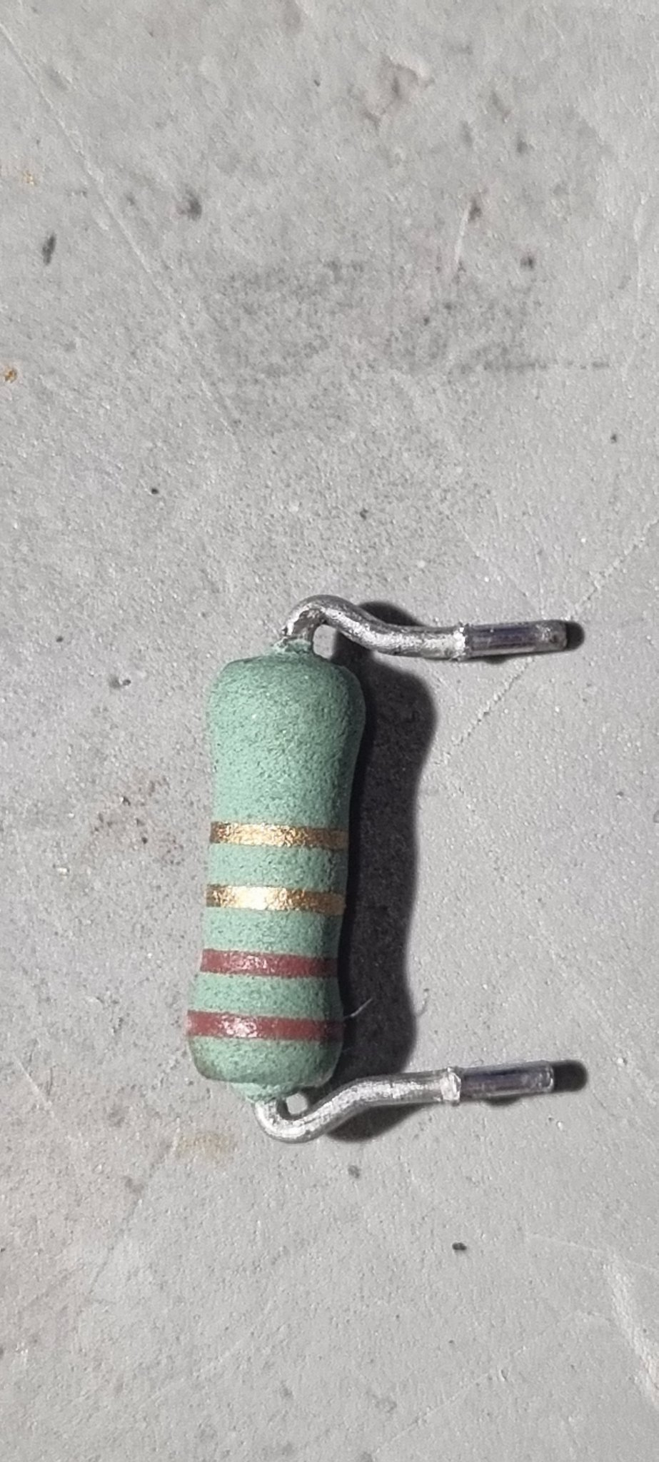

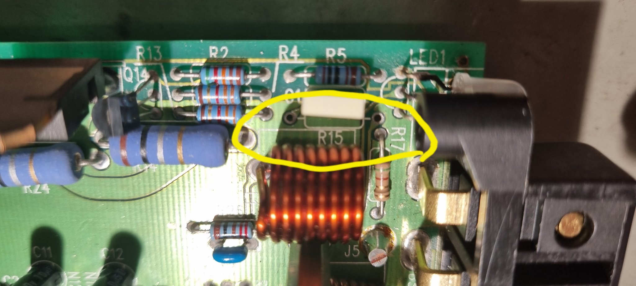

P picco76 Member Joined 2010 2025-05-26 7:24 pm #1 2025-05-26 7:24 pm #1 Hello, i need output R-C filter value for Zapco Studio 300X amplifier. The resistors are broken, and i can't see color bars.. Thanks in advance P Perry Babin Member Joined 2003 bcae1.com 2025-05-26 7:41 pm #2 2025-05-26 7:41 pm #2 If you're referring to the Zobel, the older Zeff class AB amps commonly used 5.1 ohm resistors. P picco76 Member Joined 2010 2025-05-26 7:46 pm #3 2025-05-26 7:46 pm #3 Yes, the zobel, thanks Perry P picco76 Member Joined 2010 2025-05-27 4:37 pm #4 2025-05-27 4:37 pm #4 Resistors Are R15 and R53? Measured are 1.1ohm, can be possible? You must log in or register to reply here. Share: Facebook X (Twitter) LinkedIn Reddit Pinterest Tumblr WhatsApp Email Link
