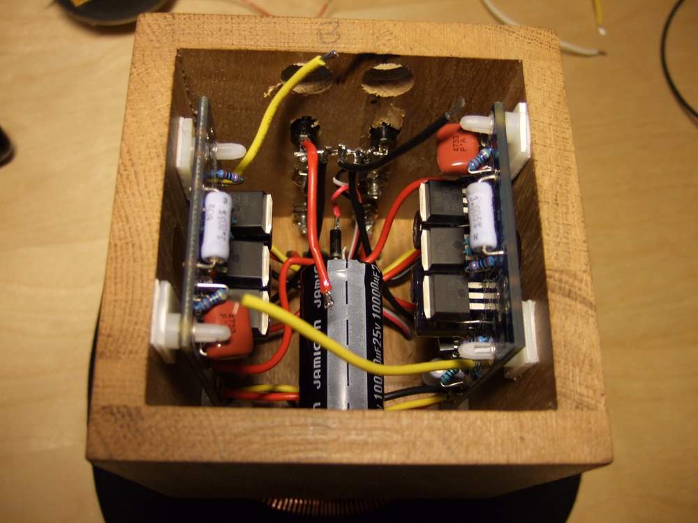

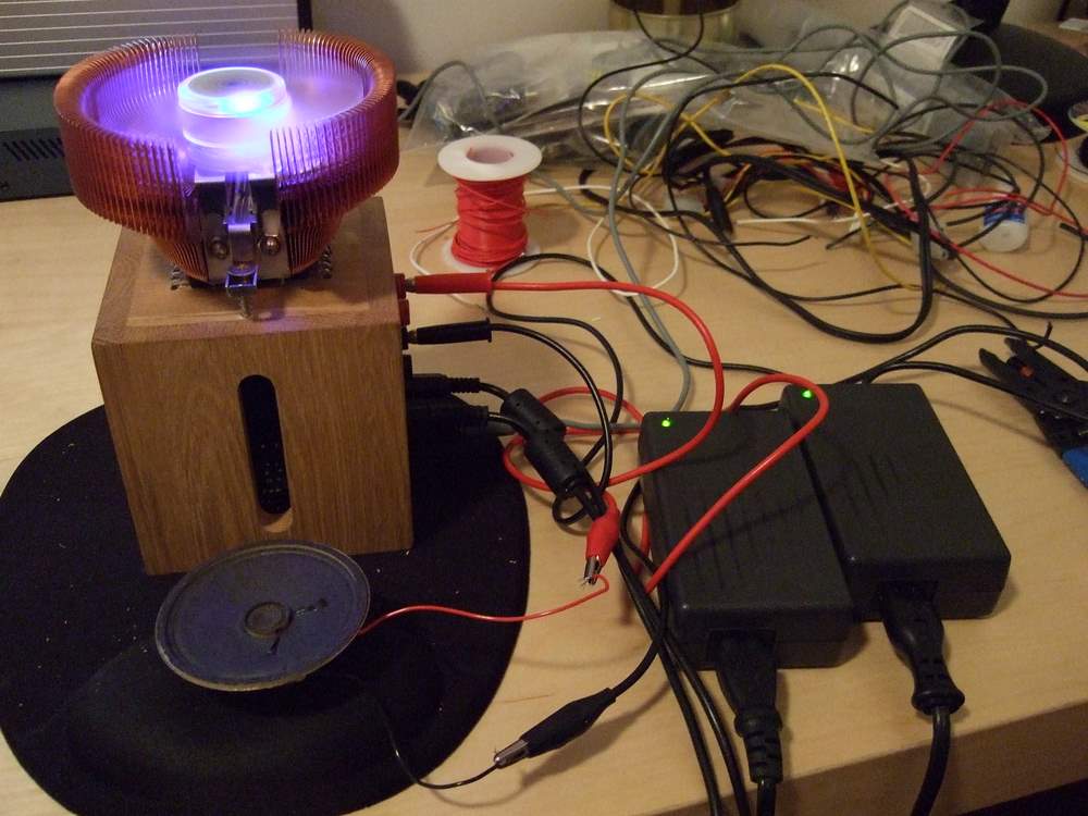

Wow, nice amp. Small, simple, neat. But say, did you mutilate the IRF9610s? They look kind of...short?
And I especially like your implementation of fancy parts, like the pencil holder, great idea.

ojg said:

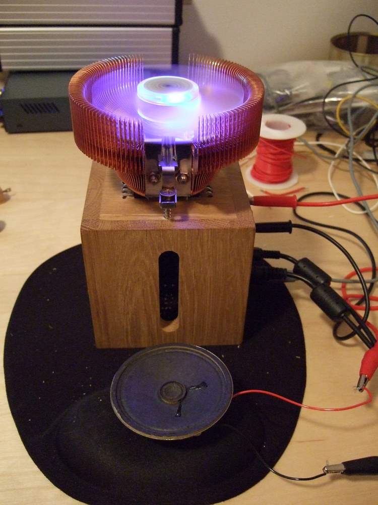

They use a Zalman CNPS 7000B-Cu LED as a heatsink. It's very efficient even with the fan at minimum
I hope that heatsink is grounded by a very low impedance connection, and even then I'd be concerned about EMI from the fan motor.
This thread made me smile actually, as I was considering switching my computer's cooling system to massive copper heatpipes to two large passive heatsinks forming the sides of the PC's tower case--total silence. It's the exact opposite thing of what you're doing--using active cooling for an application that almost always sees passive cooling.

ojg said:
They are working very well. In my opinion SMPS are much better suited for this kind of class-A amplifier than transformer-based supplies.
I used two 12V supplies in series to make +/-12V. I made sure they had only a 2-pin power cord to avoid any grounding problems.
Stupid me ..Am trying to figure how series connected 12v supplies provides +/- 12 volts. Perhaps you could help out with a simple sketch.
sounds like a great idea!!!!
As long as the supplies do not both use ground as a reference (which is why he had the only-two-pin power connector mention), just hook up - of one to + on the other. That gives 24 V from the free - to the free +, with the common connection in the middle (which can then be referenced to ground).

I did something similar with my Zen V5 with the sj74/sk170 jfets on the front end. I connected two 19.5V 3.5A laptop power supplies together to make a +/- 19.5V SMPS (two laptop supplies/channel). I dialed in a 1.5 - 2 Amps (around 25 watts/channel??) on the bias and she actually sounds good.
I also took four 4"x6" heatsinks and arranged them like an aleph 5. I bolted them together with 1x1 angle in a square fashion. The four sinks have one of the four IRF9240/240 bolted to it with a KAPTON Isolator.
Under the sinks I have all four laptop supplies in a Hammond 1650 enclosure. The four sinks bolt onto the top of the enclosure.
The amp is driven via a jfet BOZ with a Lightspeed attenuator in front all in another smaller Hammond enclosure.
She looks and sounds sweet.

Ha. I'm so happy I found that thread. I was planning to use 2 newer model Zalman heatsinks, But I wasn't sure I can run them at low enough speed so they don't make much noise.
If you can cool all 4 transistors with one, I definitely won't have issues.
