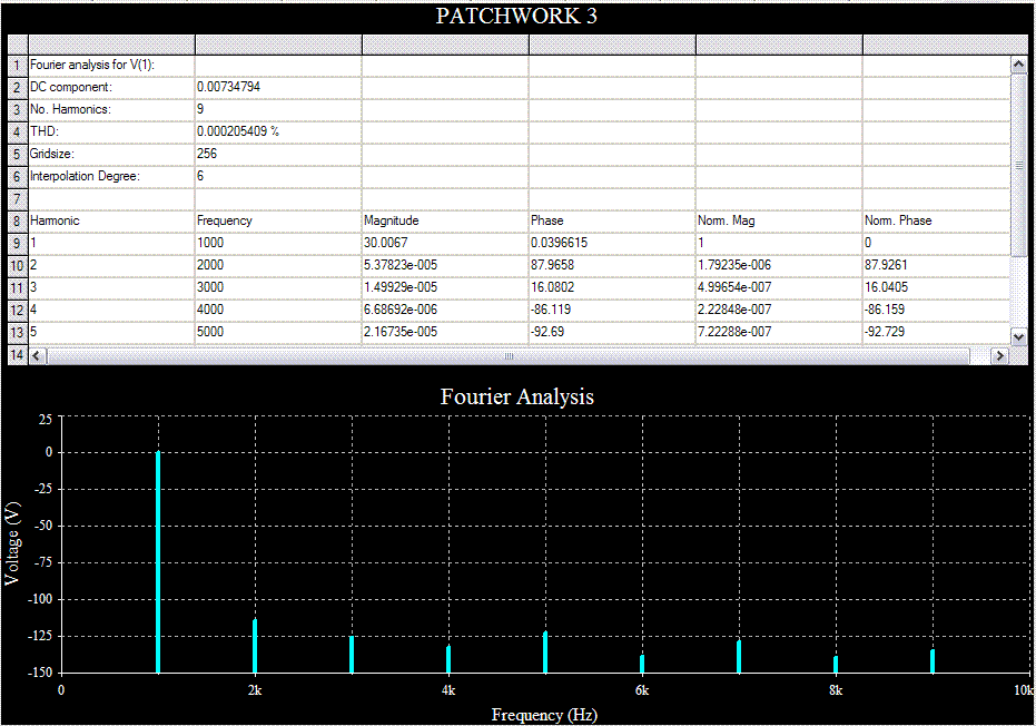

MultiSim. How I make my FFT.
Good luck!
You are the MAN, Lineup! Thank you.
My first results:
Quick learner 🙂 MJL21193

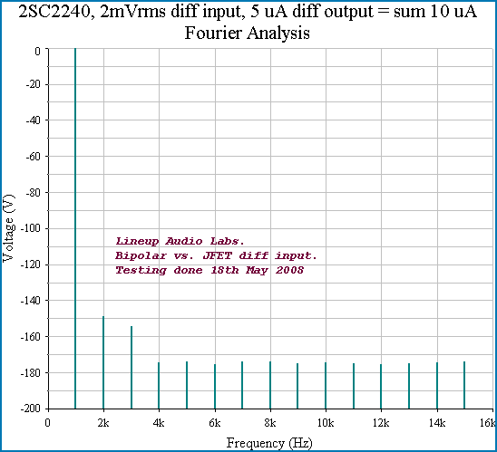

You may prefer some other format of output, but
my settings are the following:
Fourier Analysis
Results
V Display as bar graph
V Normalize graphs (refering all to zero)
Display: Graph
Verical Scale: Decibel
Will give the following style of results output:

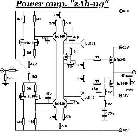

lumanauw said:
The 800ohm joint connected to 150ohm joint, is this making positive feedback?
As I see it.
An attempt to equalize C-E voltage across the both Diff VAS BD140 (and BD139).
The voltage will follow output signal.
The effect is a kind of Bootstrap.
If voltage across each 800 ohm resistor is ~4.x Volt,
we may end up the C-E stays rather equal and constant.
Sorry for hi-jacking your thread....

darian said:
Hello
I think you should think about something better to set the bias of your output mos... The Vgs on of these devices is not really reliable. Other than that it's just the super classic amp topology... Look at this one from France, very good sound indeed, simple schematic but the cascode on the VAS is a nice addition
http://pagesperso-orange.fr/jm.plantefeve/nrds2.jpg
Sorry did not see the circuit from France. I simply used Nikwal's circuit and reduced it to a more basic circuit. Took me about ten minutes using MicroCAP and another four to optimize. No big deal and no authenticity claims - for me, it remains Nikwal's amp.
I have no idea why you claim Vgs of the devices not to be reliable. Imagine Toshiba writing in their data sheet, Vgs unreliable???

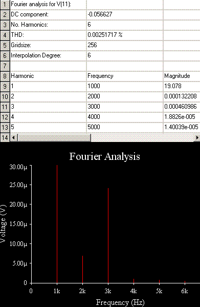

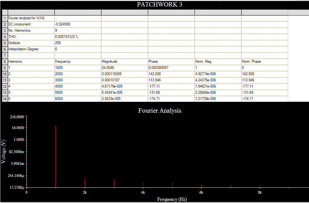

Thanks again, lineup.
I have made the adjustments and the result is below.

Nikwal, sorry for this other stuff. Your amp looks very good and I think I will play with it as my first non-bjt project. I like it simple.
