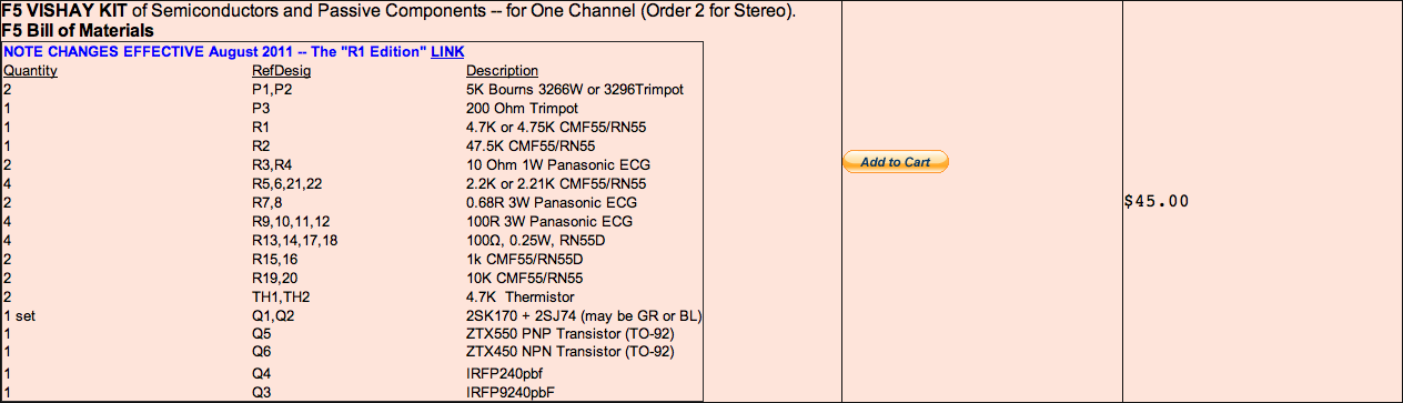

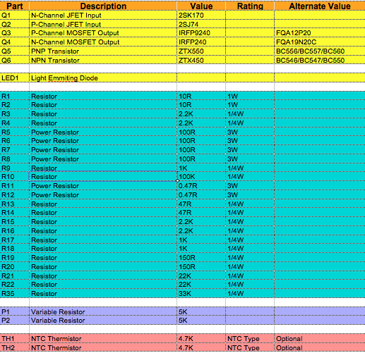

So I have the BOM
Attached is the BOM, and I have several questions. I plan on just throwing all the board components into a Mouser project, and ordering. They don't seem to have all the transistors, and I will discuss them later.
Just one questions for resistors... well two actually. I know K means 1000, so 100K=100,000
But what does R mean? Like 10R, 100R, 0.47R 150R, etc?
Also, I'm going to use metal film resistors? Is that okay?
As for the pots, P1, and P2 are both 5K. Can someone point me to the mouser part number (or digikey) for the pot? I can find a lot of 5K pots, but I need one that fits in the holes. One with the right spacing. :)
As for the NTC thermistor, its 4.7K.. whats the wattage? Can someone point me a link or something?
Also, what about LED1? What should I use for that? Again, a link would help me.
Now onto transistors.
Q1: 2SK170
Q2 2SJ74
Aren't these transistors difficult to find? I heard one of them was discontinued with no replacement.. I have a source for them, but do they need to be matched? If they do, what is it for? Low DC offset?
As for Q3 and Q4, what website has them?
What brand should be used for them? Any matching needed for these? I know they are the outputs.
As for Q5 and Q6, Mouser has them.. nuff said. But do they need to be matched?

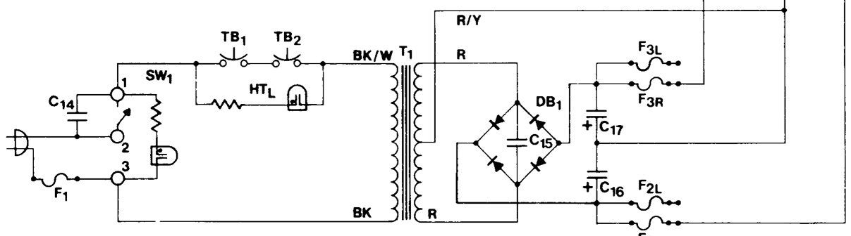

Transformer should be a 18-0-18. What VA would work? Can I simply wire up the power supply like in a Hafler DH-200?
I would simplify if though. I would get rid of the thermal breakers, as they would be on the PCB, and get rid of the high temp lamp.
The center tap of the transformer is connected to the ground bus between the two filter capacitors. For filter caps, would two 22,000µF work? Also, having an B+ and B- fuse for each channel. Thats my plan for the wiring. The ground of the RCA jacks is grounded to the bus bar, and so is the negative output for the speakers. Fuses will be put inline with the positive speaker output.

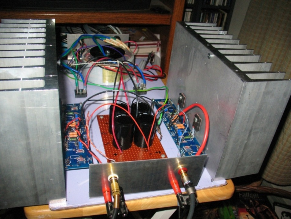

I just got my F5 running last weekend as a breadboard setup. I've probably got 15-20 hours on it so far. It was rather harsh and shrill for the first few hours but I ran it for 8-10 hours yeasterday and it really started to settle in. I used Toshiba power FETs and a 400VA transformer with cviller boards. The power supply is all DIY on a perf board. You should enjoy yours when it's running.

The 'standard' Pass PSU is a 18v+18v transformer with at least 60,000uf of capatance per rail. (120,000uf total) The Hafler schematic you posted is not necessarily wrong... but there are much better ways of doing it.

From what it looks like, you have a dual mono power supply. As far as grounding, it looks like I can use the Hafler power supply method, and Hafler type of grounding.
Correct me if I'm wrong though. I'm better at repairing things than building.

Attached is what I will buy for the boards. I understand these have all the components to install onto the boards I bought.... One kit per board though.

It's not a dual mono supply. It's bipolar with a dual secondary transformer, and 2 bridges.
Since you are planning on using the Antek 4218 you really should make the supply like the above diagram.
The caps you chose will work, but you are paying extra $$ for the 63v rating which you don't need. PSU caps are expensive, you should get the right ones first.
