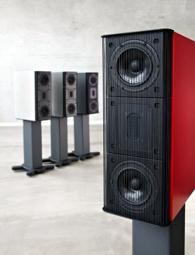

And another slight variation, the Gryphon Mojo:
Whether these 5" midbass speakers have enough deep bass to satisfy is debateable. But a top 5 idea, IMO.
