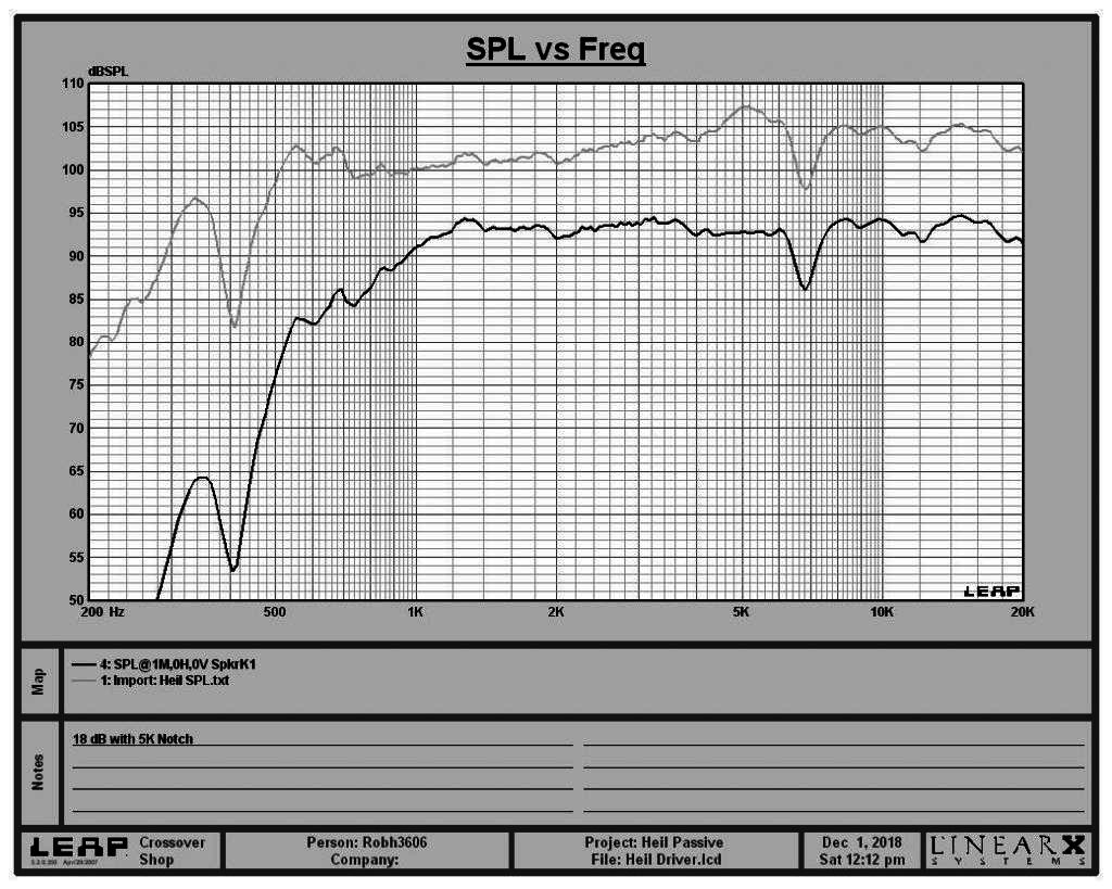

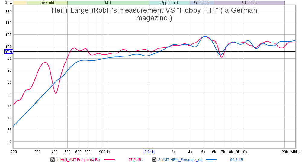

Here's a version I translated to English. I bought a pair a year or so ago and they didn't have the big 7 KHz dip. The Heil AMTs have undergone multiple design changes over the years so the dip may have been fixed.

Could post the off axis curves out to 90 degrees horizontally and vertically? Actually 125$ a piece is a steal considering the current prices of the better domes.
Can't do that only looked to 40 degrees after that your pointing at the side of the driver, I will post what I measured there is another in a thread @ Lansing Heritage can't get into the site.

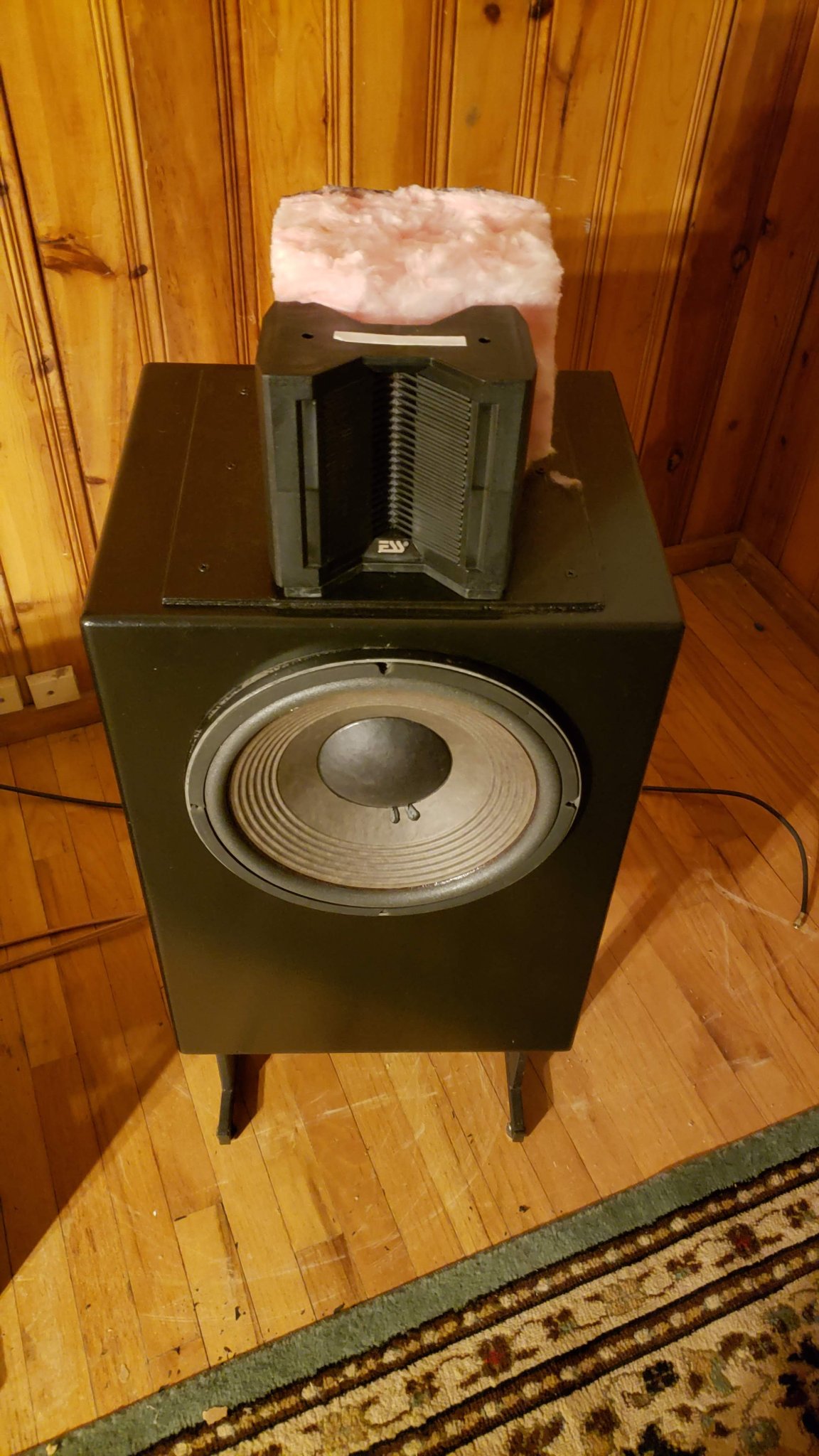

So it begins..
I was pleasantly surprised to find the mounting kit contained nice rubber wedges which puts the AMT's on slight upward curve.
Fired up for the first time and had a big scare, as one channel was playing less loud than the other!
A bit of investigating and found out one of four AMT's came wired out of phase internally. Reversed the colored lead wires and Voila! Man, what FANTASTIC sound.
I suggest people check thier Heil's before using.
I can see what people are saying about 5kHz peak but sounds pretty pleasantly sparkly to me, especially with Heils replacing 1.4" compression driver/horn which has less pleasant peak 1-3kHz 😀

Woofers are 8" Seas Curv cones and sound great in midrange with me switching among 1.4" compression driver, 1" compression driver, Beyma TPL150H, and now Heil stack using active crossover.
I already have the velours. Trying to see if I want to try adding wings before or after velour so velour covers the wing too...
I tried damping the backwave in monopole, but I prefer the dipole sound. I do have pretty good mix of diffusors and absorbers in this room already..
Kind of reminds me of big Magnepan panels in that bit larger-than-life, rich, natural midrange. Not pin-point imaging but air-infused pleasantries.
Running 12" sealed sub below the double 8's.
Crossing to AMT at 1kHz. I do want to avoid issues crossing lower.
