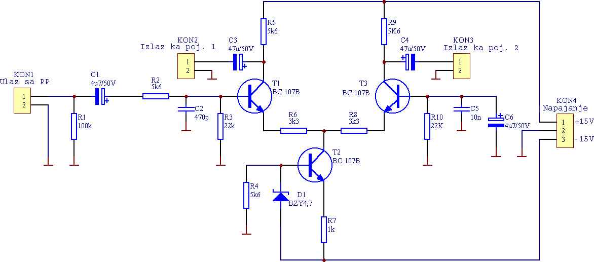

don't mean to butt in here rather rudely, but I think Mooly and another user did explain why: becuase of instability with the midpoint voltage, and the need for a phase inverter (mind you a transistor with taps on emitter and collectro would work fine I suppose).
But mainly for this reason, which is my own:

I know that will need me to phase inverter for bridge amplifier.

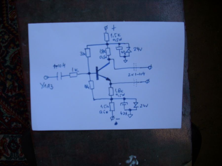

I send you a scheme very simple inverter.
Edit my sheme with the differential pair of transistors requires a good knowledge constructors.I do not have to.
If I had the offset of the 2-3V, I know that it is more complex and spam.
Then I have a big problem to make the bridge amplifier
I hope so that I don't have that big ofset.

I would not use that method on this amp as the different gains and feedback resistors will cause different offsets.

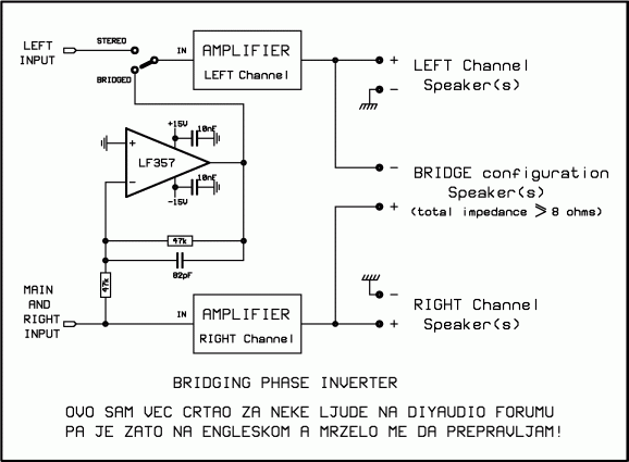

There is a balanced line output project on my website which would be exactly what you need to produce identical but phase reversed signals that will happily drive the amp.
R5 is capacitively coupled, the DC gain is 1. How bad could it be with just a little resistor selection? 50 mV?

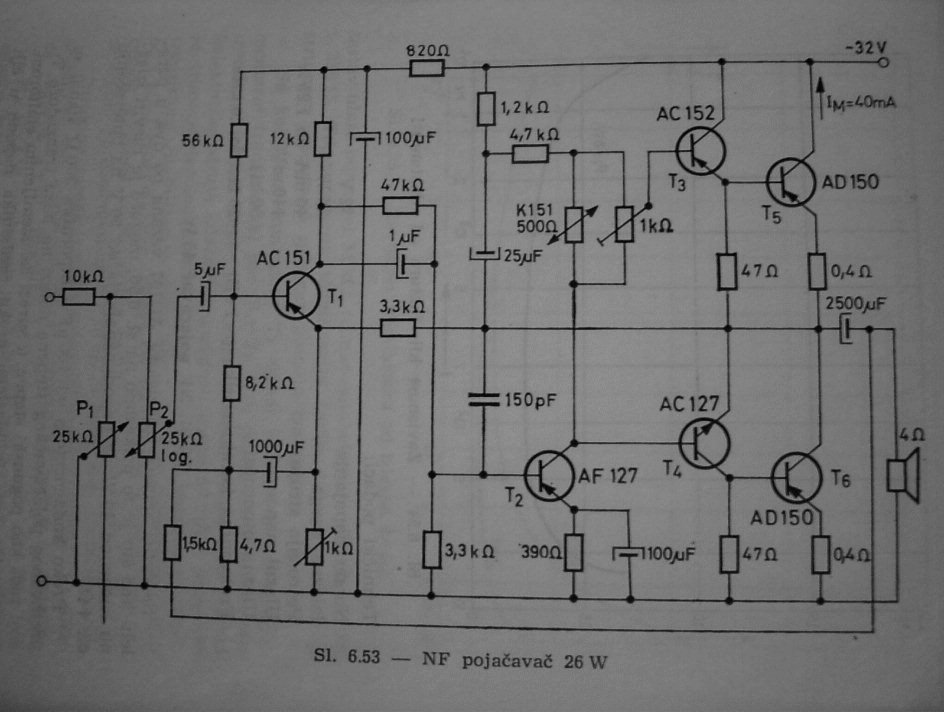

Frend, could you help me when and if I bild this amplifier in bridge mode.
I build first in the kit,with 2N3055( my first shematic),than later I wont build with AD150.
If I am satisfied with the sound than I make as bridge mode(AD150- second shematic).
Can I count on your help?
I like to do in bridge mode ,bacause in 8 ohms amp give me only 10-12W(this is too small power),and I like to build with Germanium transistor.

The second is curiosity value only... germanium devices...
Build the first one as per the circuit. You will be amazed at how good it sounds, and from a kit you have a better chance of success if you take it slowly and check everything along the way.
Forget bridging it too.
Why do you want to use Germanium... ? It would be so prone to problems, possible unreliability and thermal issues. Anything warmer than a cold cup of coffee and you would be in trouble
