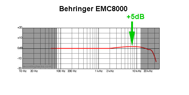

John (and some DIY guys) often use a Behringer EMC 8000 mic. Its cheap (around 50 dollars) but its not accurate to the level needed to reliably measure wide bandwidth (graph shows grey areas of pick-up range variation + 5dB uplift). Given this mic's likely performance limitations, And the use of a non-anechoic environment, its by no means certain that the 10F's high response was accurately measured.

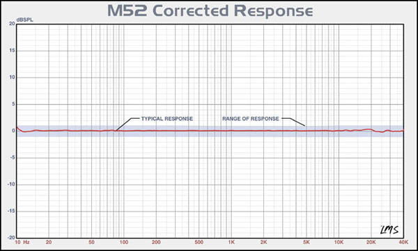

Using something like an M52 mic in an anechoic environment (graph illustrates 10Hz to 40-kHz @ +/-1dB flat response) is expected to deliver a more reliable result. Such mics are in anechoic use in most of the industry. I use this mic and an Earthworks M50 in a walk-in anechoic chamber with a suspended wire floor. It' the only way to reliably isolate the driver and get an accurate test. I'd encourage all DIY testers to do what they can to upgrade mics and gear when money permits; And to fully pad out a room (wife/partner and bank manager permitting).
I would belive someone like Zaph would calibrate his Behringer mic before making any measurements.

Finally Zaphs mic is CALIBRATED! ..and if you bothered to read that it was the Behringer unit mic, then it really shouldn't have been that difficult to discover that it was calibrated.

Hi Mayhem,
Thanks for your comments and I do value your opinions. As far as I know, I'm the only driver maker on this forum precisely because I do take on board DIYers opinions.
Your first sentence is right and explains why I'm advocating the use of better equipment and the use of anechoic or well-damped environments where possible. I'm rather surprised by the rest of your comments. The prime reason for the use of anechoic environments is that external influences do affect driver test outcomes. All DIY speaker builders deserve access to accurate and reliable data upon which they can make a judgement call.
Re you comments regarding John (Zaph). I'm very surprised that you've "glossed over" the reality of the situation. John's using his "Zaph" name to sell drivers and kits. He's not doing doing it for love, but for commercial gain. Zaph's commerce does compete with mine because DIYers make buying choice's between multi-way and full range drivers. I also produce a woofer and tweeter (Woofer No.6 - EL166 and Tweeter No.3 - ERT26). His commercial activity means he's no longer neutral, yet he continues to judge products that compete with his a driver and kits that bear his brand name, its a clear conflict of commercial interest.
I'm not quite sure what your inferring when using the term "educated consumer". Are you saying that only "educated" consumers follow John's work, that I'm not educated, or those consumers who may disagree with your position aren't educated?
