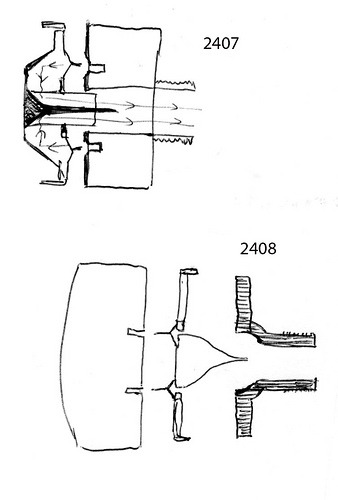

Is there a version with 1" exit and 1.75" VC from JBL similar to the 5530ND?
I searched but didn't found one.
2406H , very similar to the BMS 4552ND, does have your desired 1,75"VC, screw on.not 1 3/8" thread.
2407H, 1.5"VC pretty identical to the BMS 4540, is/was made by BMS, rebranded.
2408H- is JBL's own 'evolution' of 2407H.
Different diaphragms and phase plug, etc. They're beefier own version(compared to -1/-2) that JBL has produced overseas.
And so are the following -1 /-2.
Following they're usual trend in later times, they look for ways to shave off cost with similar performance.
As can also be evidenced by the lower prices of the 2408H-1 and H-2 even more so compared to the 2408-H.
If the D2430 is to your liking.
The D2415 0.75" exit is a smaller version.
There was plans/development of DA2420, but never seen the product used or for sale anywhere.
