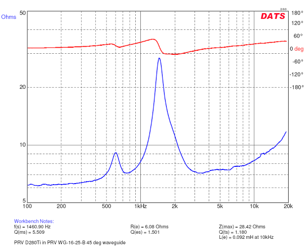

One of the things I think is particularly important is Impedance. Many compression drivers (lower and higher priced offerings) have Impedances that require so much compensation for a decent result that using nicer passive components in the design results in a compensation network that is more expensive than the driver itself. This is that "cart before the horse" thing that can make an otherwise inexpensive build turn into something costly (both monetarily and quite often subjectively - ie. poorer sound).

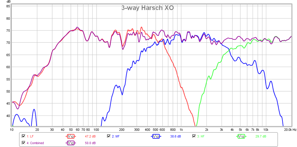

The D280Ti measures very close to factory curve with a kink in the LF but smooth above 1200Hz. If you look at a photo of the replacement diaphragm, it looks all titanium with a what appears to be a pattern of diamond shaped dents around the surround to allow the metal to flex.

Here is the measured impedance in a PRV WG16-25-B waveguide:
Here is the measured response (in green) but with a highpass at 3500Hz for the Harsch 3-way XO. I did not save the response below this XO frequency:

Shame on Tymphany for not stating waveguide used. PRV does on their data sheet. On my measurement you can see what the waveguide did to the impedance - put a big peak at the 1500Hz design cutoff frequency.
