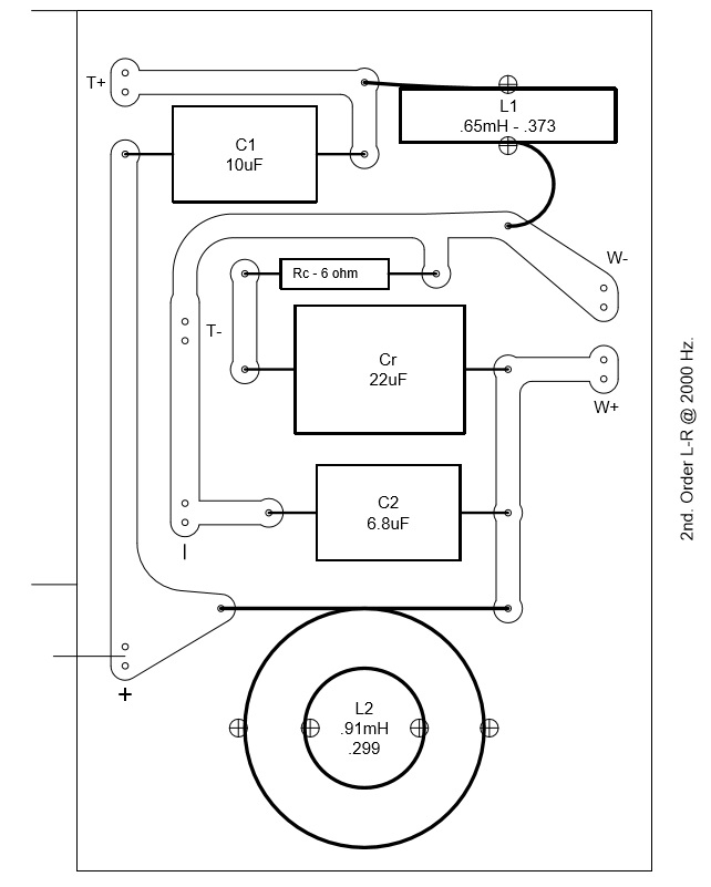

Here is my 2nd. Oder L-R @ 2000Hz.

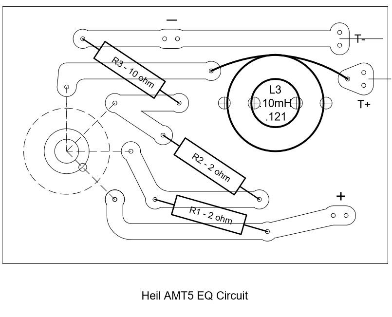

The board is 6x9 and the HF EQ board is 4x6. It has a select switch that is not clear on the drawing. (I know what it is).
I have an alternative design for 2nd. BW.
Can't decide between them. Leaning L-R.

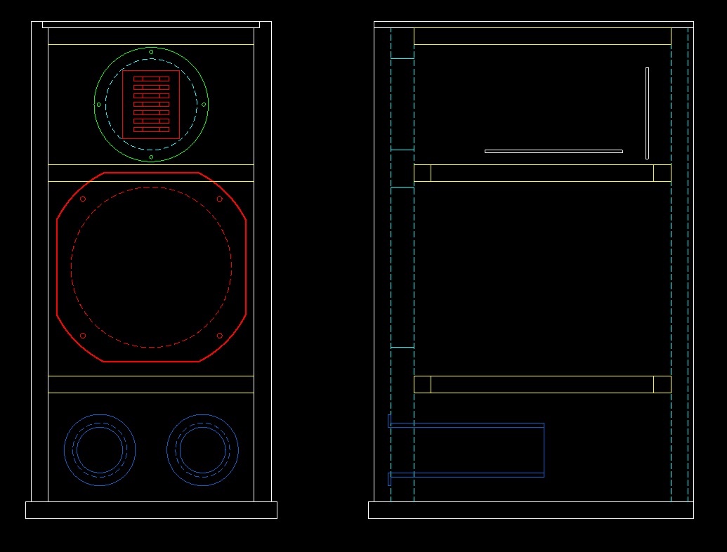

The main board will sit horizontally in the top of the cabinet.
The smaller board will sit vertically, attached to the back and aligned to the main board for jumpers.
There will be a heavy piece of smoked glass that will sit atop the cabinet.
This can be removed to access the boards and mainly the select switch.
I know the switch usually goes on the back of the rear panel, this is a little different.
To simplify in Newbie terms...
Does it matter if I connect the little black wire with the (-) label coming from the woofer to the little black binding post? or should I provide a terminal on the crossover board (W-) and connect it there?Does it matter?
