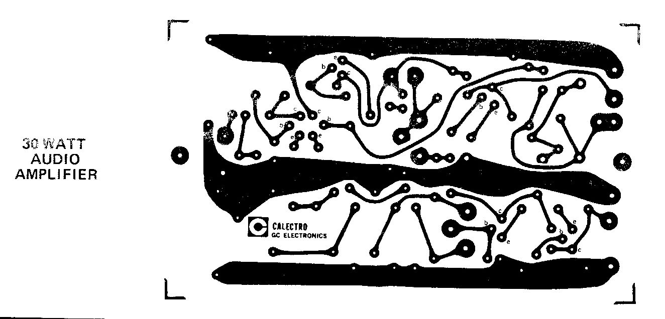

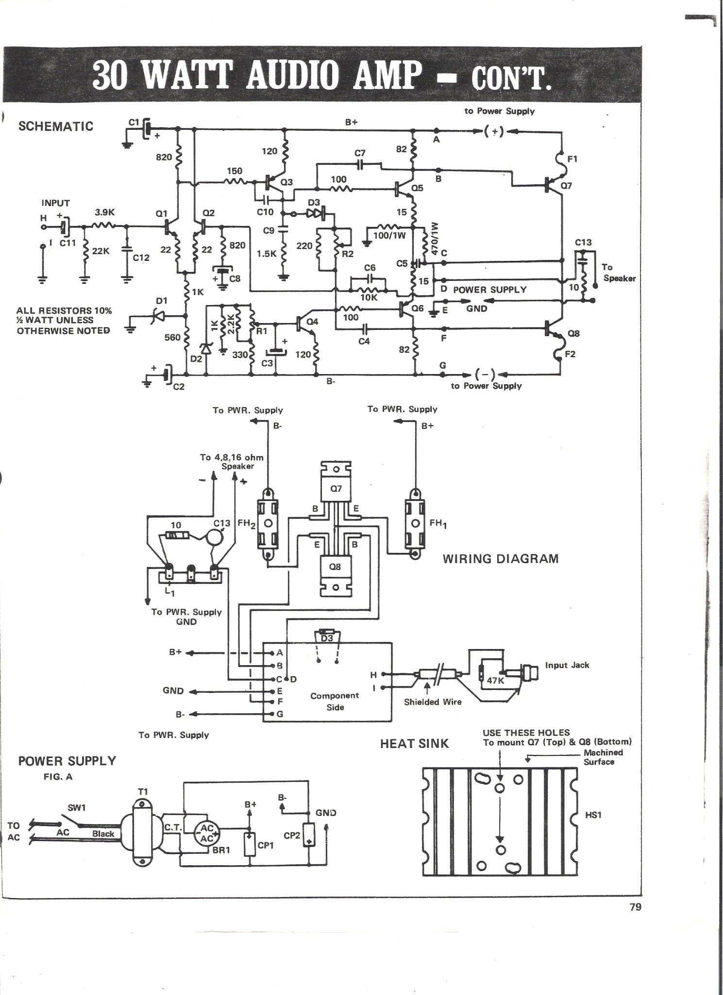

Hi Everyone , It might be interesting to see what kind first projects have been built to enter into solid state amplification. I'll get it started with mine. Lab work with amplifiers in college never got past 5 watts. I remember the adjustable bench supplies as being 1.5 A at up to +/- 15 V. So, after graduation , I came across this Calectro / GC project in a 1980s hobby magazine. I built it with the horrid TIP series devices and all, but it worked. I got the DIY bug , days latter I bought the proper Mototrola devices ( MPSU , MJE , and MJ series power transistors) to rework the whole amp into a much upgraded 100 WPC amp. Once the front end was upgraded to a proper current source , I boxed it up into a nice chassis, along with a preamp from an op amp "cook book". I wound my own transformer with laminations salvaged from a TV transformer. Years later, I found out that the Calectro project was a knock off of a better , and more well known build from a 1970s magazine. Can anyone identify it ?

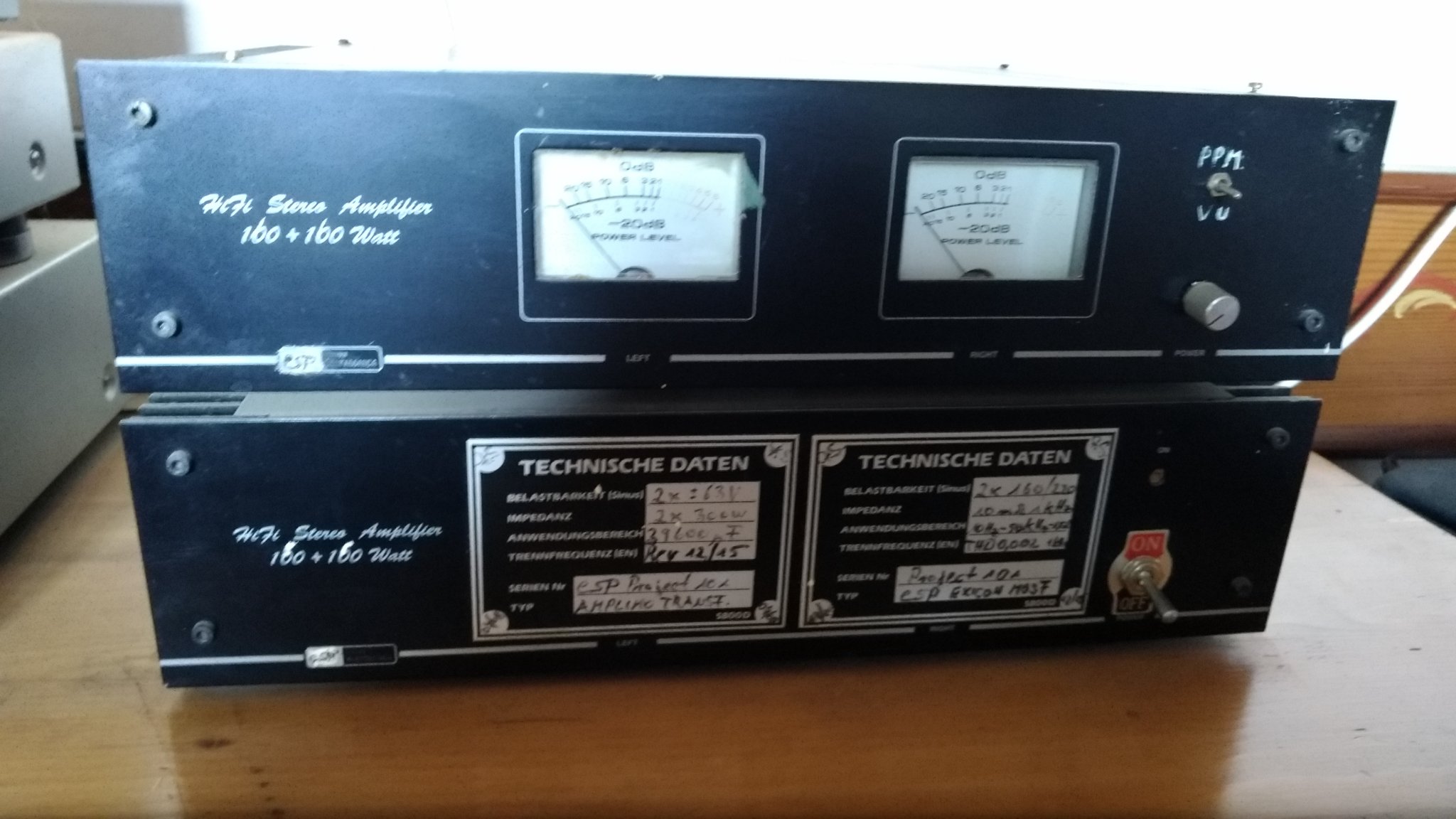

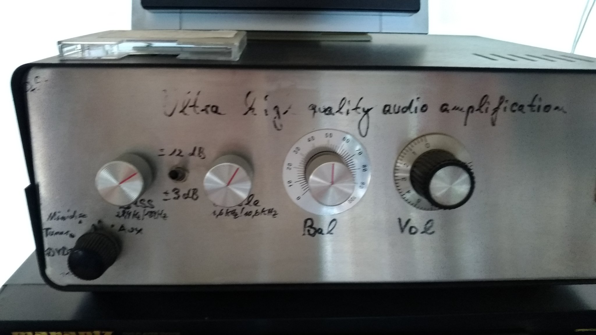

Hi @njswede ..Have a look at Elliot sound projects in australia.Project NR 101.This one I've first build almost 10 years ago and I've recently reordered the boards for a complete redo....It's a lateral mosfet amp using Exicon ones specially designed for audio,very reliable and very robust.I did a slight adjustment to the org. layout for this reason(soldering and resoldering a view times) I decided to redo the whole thing again. I was astonished of the smooth and clear sound it got.I also did the Project 97,which is a lovely preamp with tone controls.Both projects can be assembled within days ,if you got the necessary case,heatsinks and so on.Best regards.ps the front panel of the preamp was changed...it looks now a lot neater....

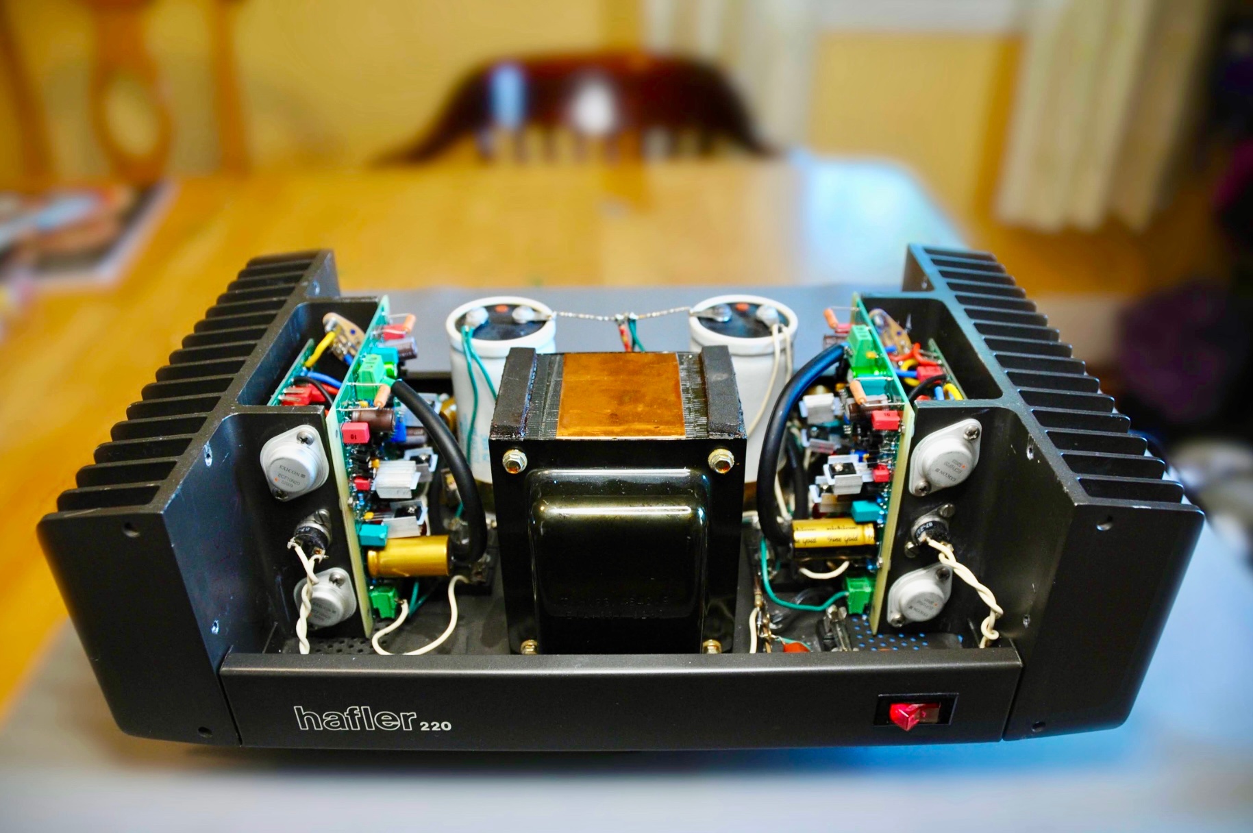

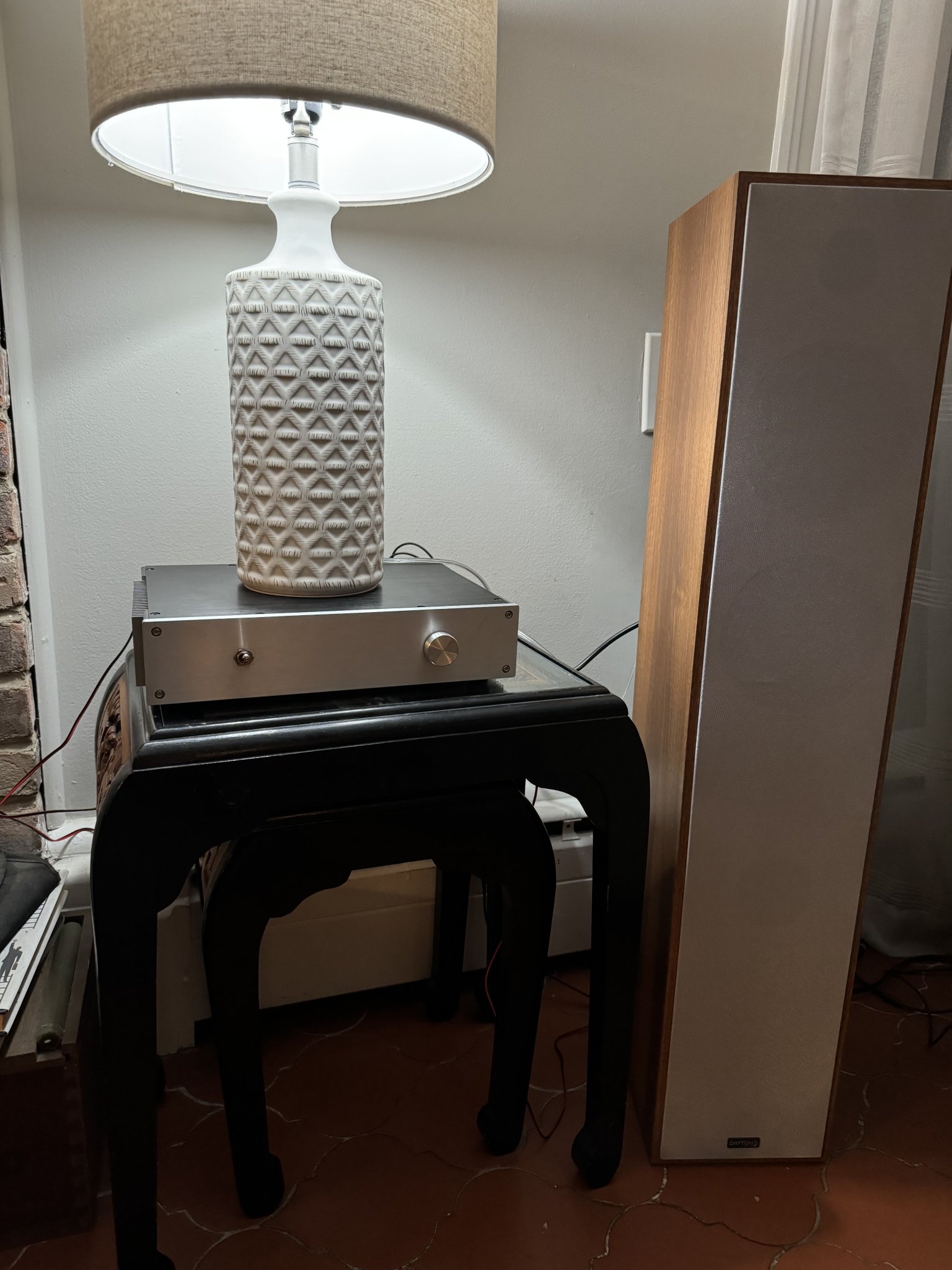

It’s hard for me to believe it, but my first true power amp build was my DH-220C in the late summer of 2020. I had only played with vintage amps and simple Class D modules before that. I updated that amp further with a stout SMPS and it’s been cycled through my systems many times since then, operating wonderfully. How time and projects fly…

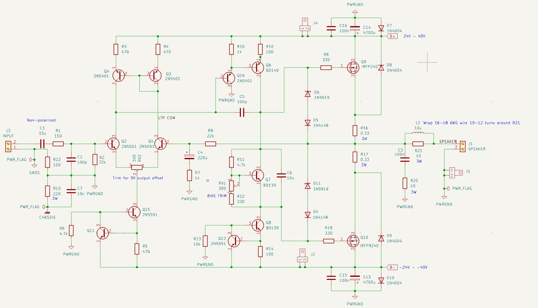

Thanks! It actually looks similar to my MOSFET design, except that I have active current source and VBE-based biasing. And I'm using plain old IRFP(9)240. Attaching the schematic for giggles. I've been thinking of making a version of it with lateral MOSFETs.
I think a more immediate project is that preamp. I've been looking at it for a while.
