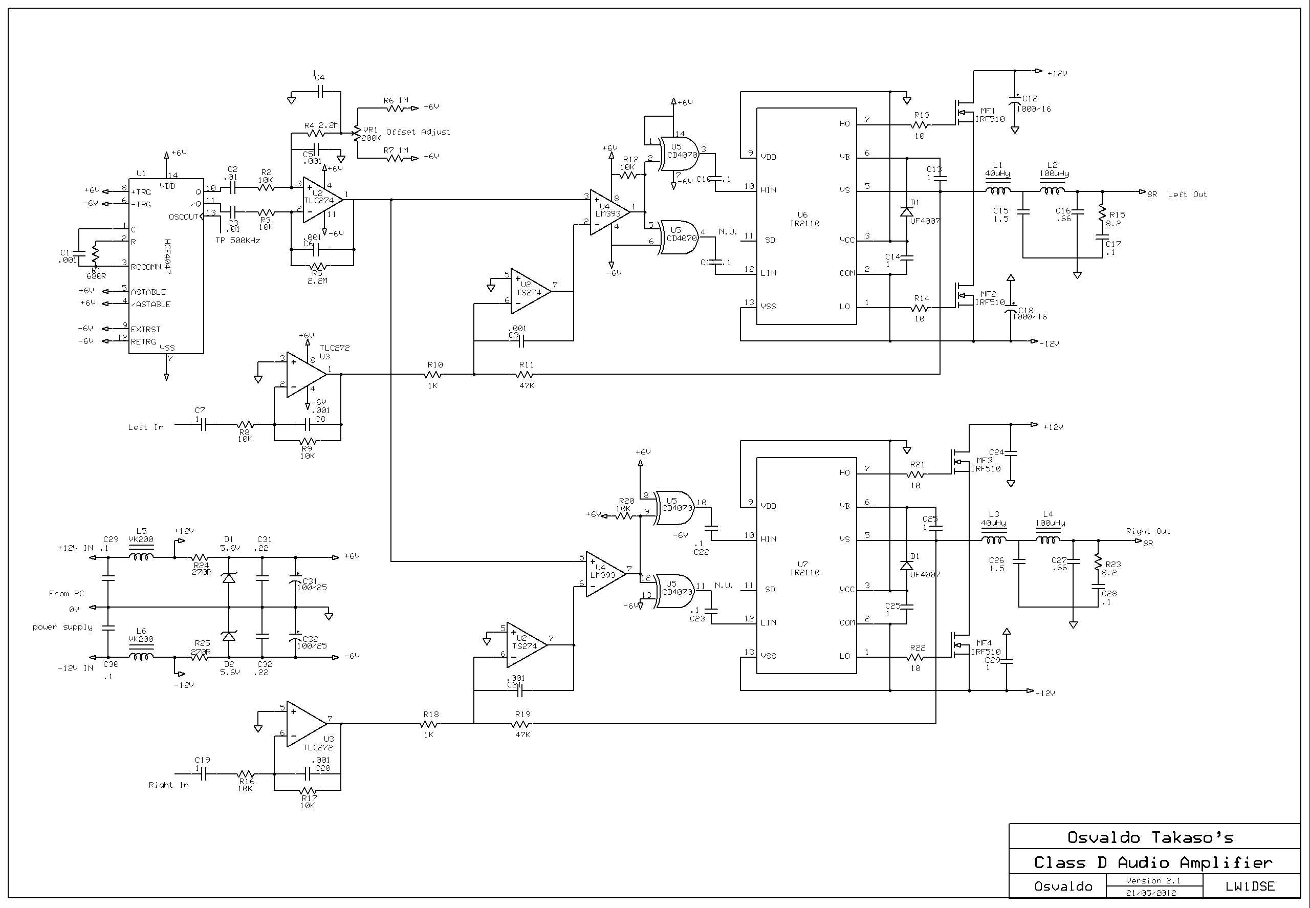

4047 is oscillating at 560KHz, and then main frequency switching is 280KHz. Tho anti phase outputs of 4047 are added at the integrator's output. It work pretty, in this moment I'm listen internet radio using this device powered from the yellow (+12) and blue (-12) of this ATX PS of this computer.

Keeping the class D carrier inside the amplifier is a matter of proper design, not topology.Self oscillating may be easy to design, but they're strong electrical noise generators as frequency varies with signal, not too adequate to use near an AM receiver.

You can't notch filter a fixed frequency class D amplifier output - the carrier has harmonics which a notch won't take out, and secondly the carrier is modulated by the audio frequency. You're stuck with lowpass filtering.Ok, but let's to agree that it is easily to eliminate or filter a narrow width frequency variation that a large one. I can say it as ham radio from 1987.
