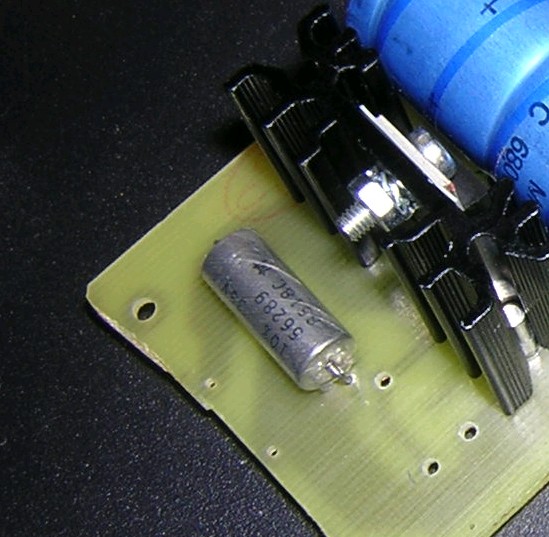

I have a Ba tube for a customer that is still getting far too much noise in via the filaments. Right now I have a LM317 as voltage reg followed by a current reg LM317...but there is still a huge amount of noise coming in through there. Diodes are Schottkey's.
You don't have a filament hum problem, you have an instability in your regulators. These IC voltage regulators have internal frequency compensation, however, it only works if you connect 22uF (tantalum) -- 100uF (aluminum) across the outputs. The 100nF capacitors the schematic shows are too small. One or both are oscillating and feeding that signal into the tube via the cathode.

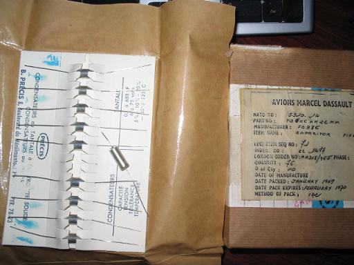

Quite right,
Bas you need these. They are 22uf tantalum at 35 volt.
Spares from our old airforce bases, made for Dassault .
I use them in the same pre-amp although with different valves
If you send me your postal address i'll send you some to try.

I would gladly buy a bunch from you. I have those exact same tantalums in there already. I'll send you a mail.If you send me your postal address i'll send you some to try.

I've put 22uF/35 tantalums in there already.it only works if you connect 22uF (tantalum) --

Thanks for all the suggestions guys! Here is a pic of the tantalums I am using..just in case you guys don't believe me
