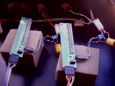

My own creation... The Discrete
1) Discrete DAC revs. 1, 2 and 4 (or perhaps that should be Discreet for the latest iteration)... don't make me choose... they all have their own character.
2) Discrete DAC
3) Pros - Complete control from the CD source data to the analogue output, remarkable ability to play music. Cons - a pain in the **** to build due to necessary extreme resistor matching, requires an unusual source format to work... and some good DSP to achieve best performance.
4) The sound - compelling without being fatiguing... achieves the old cliche of not "sounding digital"... if only the linearity was a *little* bit higher for that last ounce of ambience (remnants of nagging audiophilius nervosa). There are certainly DACs out there with better detail retrieval, but I don't get as excited over that as I used to, frankly.
Is it the best DAC I've heard? Hard to say... I haven't had the opportunity to compare directly with the only other contender I've had a lot of time with. What I can say is that it doesn't make me want immediately rush off to develop something better, which is pretty high praise in my book.
It'll do. For now. 😀
- Tom.

Hi hagtech, I was just wondering why it wasn't good enough to just leave it with 5ns risetime. It seems to me that the addition of an energy storage element would make the timing of the edge more indeterministic... in other words, would add some jitter even if the L is down in the small nH range. Sounds to me like fine tuning is absolutely necessary.
Swings and roundabouts
Spartacus,
Unfortunately, that would only give around 9dB at best. Not really worth the expense and complexity, to be honest. Some dedicated signal distribution would probably be required... the bitclock is already being sent to eight chips, but the wordclock is what really matters.
The big limiting factor in technical performance appears to be the switches. It doesn't matter how tight I match the network... the Ron matching isn't critical for the applications these logic parts are designed for, so it's a battle to trim without resorting to making your own half bridges (I have been tempted, but it makes for a much larger and expensive PCB - and you might as well try a PowerDAC if going that route, since ultra-low Ron MOSFETs designed for DC/DC don't care much about current, though the gate capacitance is an issue).
You can put the network impedance way up, but then you have no driving capability (or bass, in the case of going directly into TX102s - my preferred option), and every active buffer I've tried directly after the DAC only degrades the sound. They might just be not wide bandwidth enough, perhaps... the Meier HA-1 (with its LM6171s and filtering) has no problem...
Curiously, I have found an inverse correlation between lower high order harmonics and better sound after a point, which goes strongly against general consensus, it would appear.
Either that, or the mods I made to improve linearity were adversely affecting performance in another area (19+20K IM and jitter tests didn't show anything obviously untoward).
The first revision Discrete had a noticeable (but not severe) harshness to pure female vocals, but performed well on just about everything else.
The second revision had less harshness and more linearity... and here's where it gets curious...
The fourth revision has no harshness I can hear, but is less linear than the second revision.
I'm curious as to why, but not concerned... more fun to listen to music... 😀
- Tom.
