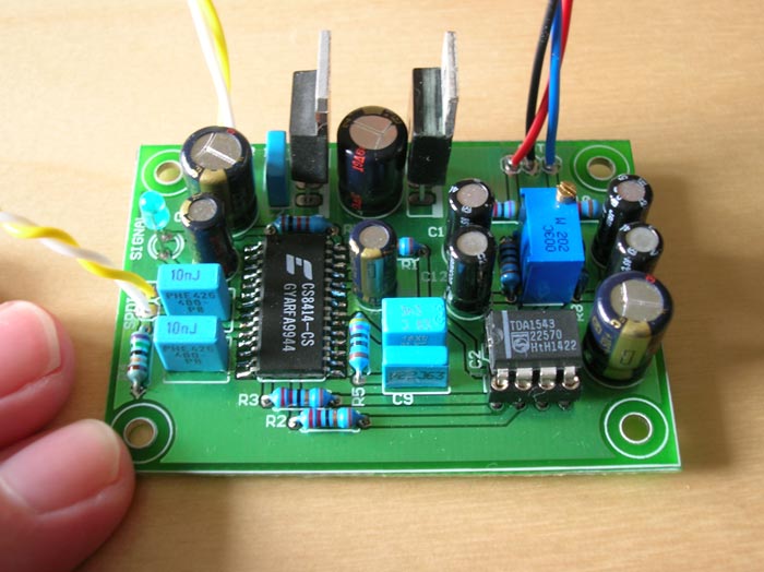

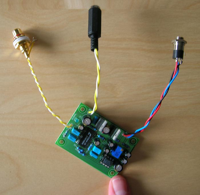

Fedde Bouwman's NONOZ-III
1) NONOZ-III
2) http://jwg.student.utwente.nl/fedde/nonoz3.html or via http://www.fedde.tk/
3)
Pros: Low cost, good sound, easy to build.
Cons: No PCB-layout (had to do my own), CS8412/8414 difficult to source.
4) I absolutely love this little DAC. Performance is very good (especially for the price) and it's easy to build and so cheap that you can basically fit it anywhere. The board only requires a single supply of 11VDC or more, so stealing the supply voltage for it inside existing equipment shouldn't be a problem in most cases 🙂
Pics of my prototype. The PCB is my design and measures app. 63x45 mm

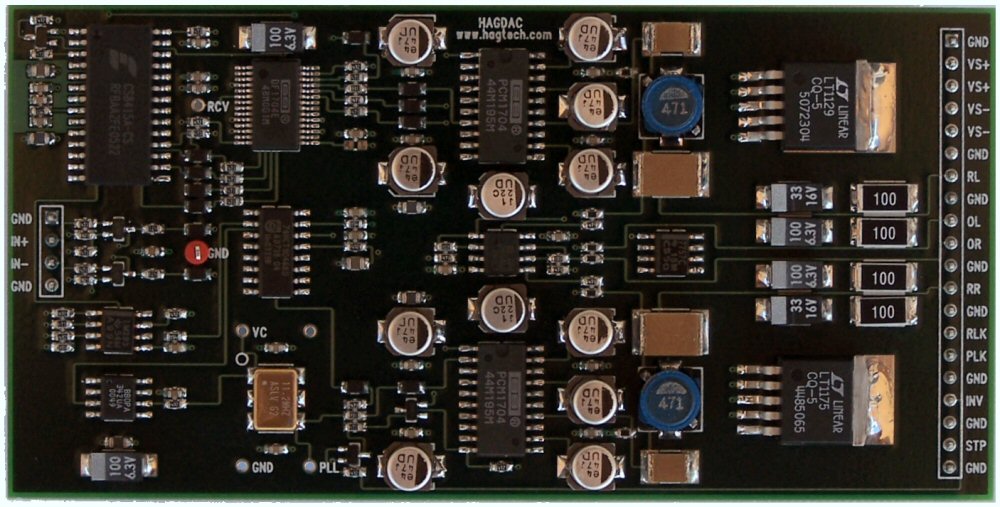

Evaluation board
Has anyone tried the AD1853 evaluation board sold by ADI?
http://www.analog.com/UploadedFiles/Evaluation_Boards/Tools/73140863EVAL1853EB_a.pdf
The price looks tempting and it seems to be well designed.
The output chips are not so great but could be upgraded to better ones.
Any flaws or problems you can predict on this board?

Re: Evaluation board
the usual flaws: analog, like you indicated, and jitter, and decoupling and board layout (ferrite between analog and digital ground because they don't get it right the default way.......)
cheers

Re: Re: Evaluation board
it's even worse, they put a PAL between the IR and the DAC..........
every USD you pay for such a board is too much, better do your own design after carefully reading through DIYaudio

Re: Re: Re: Evaluation board
OK.
Changing the chips
Improving the clock
Improving the decoupling
Are probably things I can do.
Not so sure how to go about the ground layout and solve its problems.
Yes, I see it. What's that for?
Agreed. Any suggestion? For my application, inside a Pioneer DV525, this DAC doesn't need to be too sophisticated. I2S might be an option, but I am not too sure if I can implement it.
Carlos
