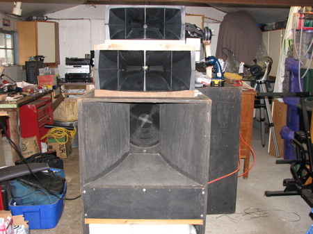

kevinkr said:I also listened extensively to the Altec 511B, 811B <snip> atop the A7.
Well speak of the devil. not exactly hifi but it's the latest to come out of the garage. Just working on the XO and padding now. All Selenium but not their good stuff.
You might want to consider the higher end Selenium stuff. I hear it's a good price point.
