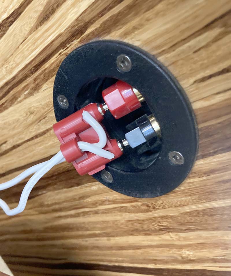

I don't believe in "sound quality" of any fancy binding posts, but fancyness is of course a valuable aspect. As I can't afford parts like WBT, Furutech, Cardas etc. I went the cheap route and use lab-equipment.
Paired with these

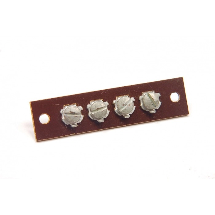

Even 1950s terminal strips had an anti-rotation feature for open lugs.
Scottmosse mentioned those early on. never liked using them (you can’t use dual ponomas with them), but they are effective.
Fine if the speaker wire isn’t overkill, and you keep everything in place. We had some with those connecters in the early days, really difficult to quickly swap things about.
dave
dave
When using these terminals, you can tin the speaker wire so it won't splay out when tightening down.
Wire should go around the screw CW. Just shape the wire into a U, and loop it over the screw to the right
of the flange (if the flange is on the bottom).
