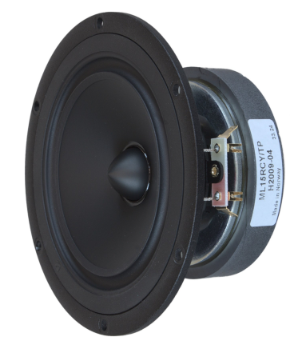

Some fresh 5" mid from Seas, the ML15RCY/TP:
https://www.seas.no/images/stories/prestige/pdfdatasheet/H2009-04_ML15RCY_TP_Datasheet.pdf
Looks promising and catches me somehow more than a MR13TX. Have a TAC/GB here, should give a nice combination...
Interesting driver. Re is low - 3 ohms. A sign of the times, I suppose. The figures for coil length and xmax don't add up.
Must be a math mistake since the geometric peak to peak is half that.
For a pure mid the sensitivity is only about 1-2 dB higher than the SB15NBAC black alu cone with a copper sleeve.
The ML15RCY/TP is the driver misses in the titan range to have a cleanner midrange, easy to imagine 2 x L19rnx3 +ML15 (300-3000)+27tac.
Wait for the price and test bench...
For me everything is fine with xmax. It's 6,8mm p-p. Coil is 9,4mm, so 3,4mm each way from 6mm air gap. It would be probably better though with underhung neo motor.
9,4 - 6 = 3,4 / 2 = +/- 1,7 mm coil overhang. So the datasheet value is wrong as ianbo and tktran already pointed out. For a mid to be used from 250-300Hz upwards fine for me.
Yep, the NBAC also came in my mind first as a competitor, great midrange and cone breakup is even higher (10kHz instead 8kHz) thanks to the stiffening ribs. I assume that the Seas will be at least double the price, expecting ~150.- € or so.

IMO it's yet another manufacturer missing the mark on what a dedicated midrange should be. FR is usable and I'm sure it's distortion performance is quite good, but...4 ohm, barely touching 90dB/2.8v/1m at 1kHz, we can do better. It claims to be designed for closed box use, while also having 48Hz Fs and Qts of 0.32. I've no doubt that this driver is simply a midwoofer with motor xmax cut in half. A dedicated midrange only needs to achieve ~300Hz bottom end output, Fs can be 2-3x as high, tighten that thing up, increase sensitivity a few more dB so that little 1" VC plays effortlessly through the midrange.Some fresh 5" mid from Seas, the ML15RCY/TP:

This speaker honestly looks like they took MCA15, added some more copper in the motor, change cone to Aluminum, add phase plug, and then VC needed to be 4 ohm to keep sensitivity up. There's 20 years improvement of loudspeaker RND in there somewhere, I'm sure.
Given that there is no official way to specify xMax that is not surprising,
dave
Eh, that's a fair amount of things 😎 I'll wait for price and reviews. Their writeup implies they designed this for an entire Titan 3-way (with new Titan tweeter, also), which may limit its broad appeal, but is fairly interesting of itself (compact box with homogenous materials and modern drivers at less than Excel prices), and may indeed complement / be quite OK for those parameters. The Titan L16 and L19s are oddballs without this partner.looks like they took MCA15, added some more copper in the motor, change cone to Aluminum, add phase plug, and then VC needed to be 4 ohm to keep sensitivity up. There's 20 years improvement of loudspeaker RND in there somewhere, I'm sure.
dave
Have you ever looked at the Seas website or at one of their datasheets? Like most manufacturers of drivers in the hi-fi market, they give a figure for linear coil travel based on the geometry of the coil and magnetic gap. Simple but useful.
Yes, we all know that it's not the whole picture, that BL is a curve, not a straight line, and you can specify linear xmax in all sorts of ways, based on BL variation or distorion percentage or whatever.
If you took the trouble to look at what Seas do, you'd know that they always present their date like this:
Voice Coil Height: x mm
Air Gap Height: y mm
Linear Coil Trave (p-p): x-y mm
The maths isn't complicated. (Though when the coil is underhung the calculation becomes y-x, obviously.)
However, this particular new driver, the ML15RCY/TP, has the following instead:
Linear Coil Travel (p-p): 2(x-y) mm
Can you spot their error? Or do you need me to explain it further?
Seas playing the PA manufacturers game with weird Xmax values is a pity.
And yes - sensitivity is pretty bad for a real midrange. Just using a smaller coil to save some weight and that's it ... a pity again.
Membrane and frequency response looks really good.
Qms is not very high - I would like to see a less stiff surround. Membrane resonance is very high and the rest seems stable, it should be fine.
For the usual 84,3dB sensitivtiy HiFi Speaker that's for sure a great midrange. For big speakers ... no.

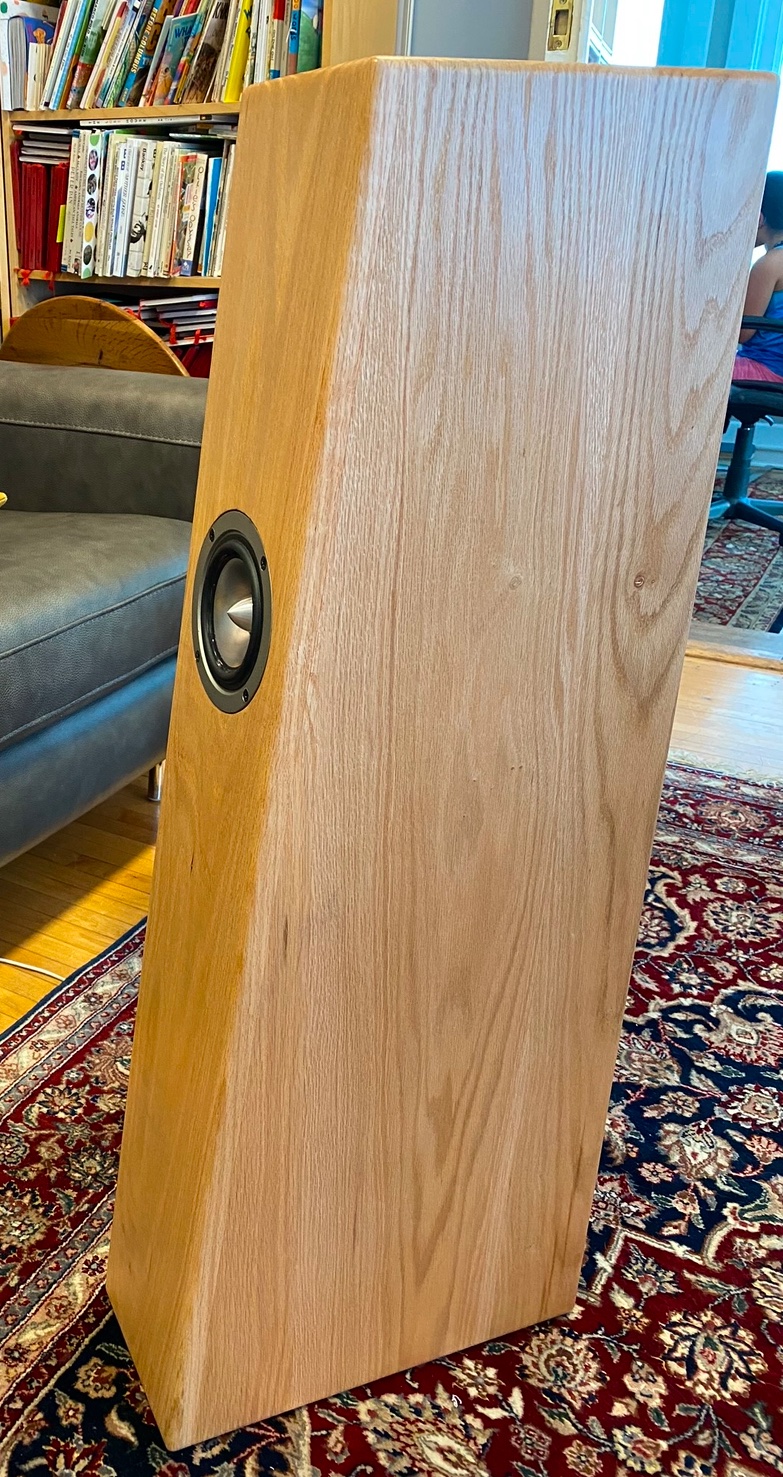

PHILIPS XH 1730 > with the center tweeters removed.Looking for folks experiences with 4-5” drivers used as dedicated midrange/midwoofers…..doesn’t matter if it’s a commercial speaker system or DIY effort. Purely subjective of course……since it’s covering the most important part of the frequency spectrum, to me…..that’s all that matters.
- 50 watt RMS
- 93 dB/W/m
- IMPP cone
- Butyl-rubber surround
http://www.hifi-forum.de/themen/produkte/philips/xh-1730
Used as 6x units per channel in an open-baffle vertical array with crossover frequencies of 600Hz and 4KHz.
A 6 ohm load able to be driven to very high SPL with very low distortion.
Very smooth & coherent midrange performance over a wide range.
- Your favorite 4-5” midrange driver?
