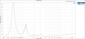

(normally there is two impedance peaks, but the secound one seems to be suppressed on some drivers)

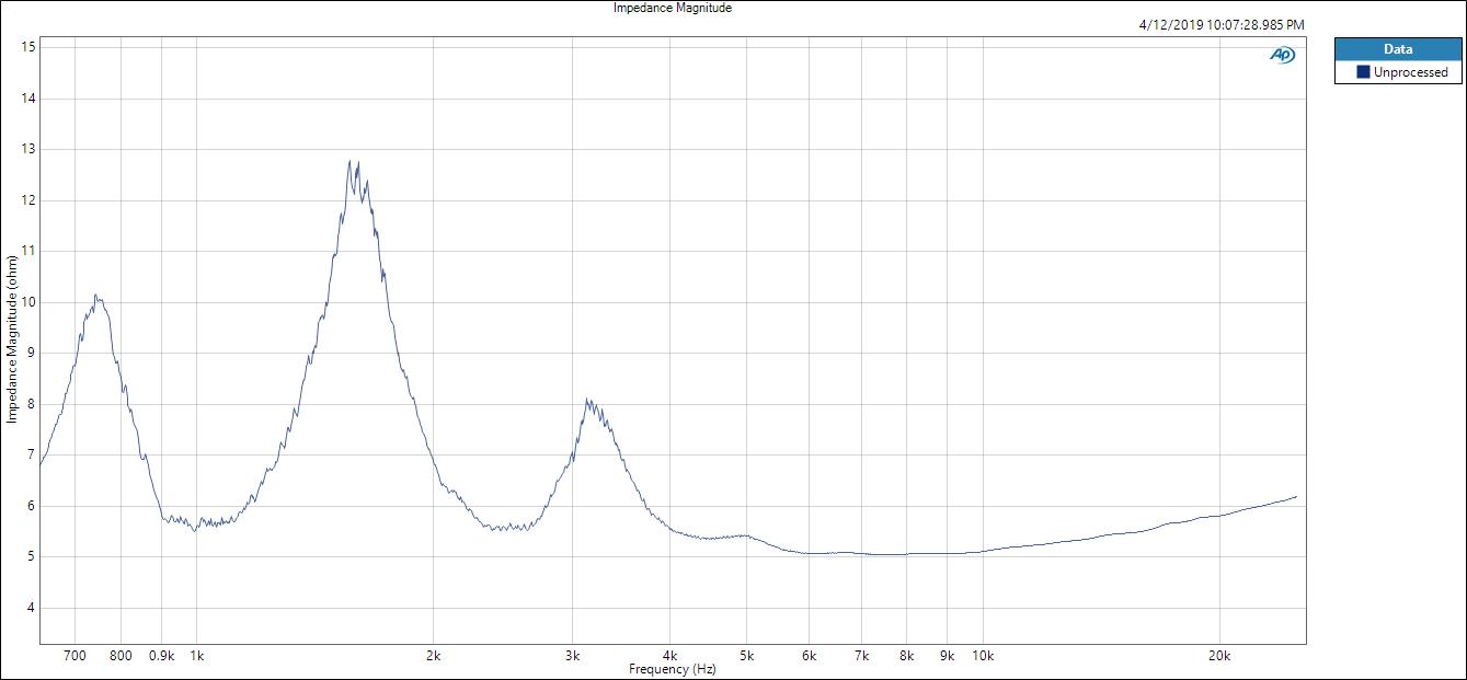

Often CD / waveguide combinations have 3 impedance peaks.
See the first plot below of a JBL D2 CD on a JBL PT H1010HF-1 waveguide. The second impedance peak is even larger than the first.

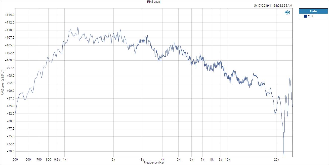

The second plot is the JBL 2425HS (screwed) CD on a smaller Baby Cheek JBL 4342.
The third plot is the Frequency Response of the JBL 2425HS CD on a JBL 4342 waveguide.
Note that the impedance peaks can be largely reduced by placing a resistor equal to the impedance of the voice coil in parallel with the voice coil and placing a resistor equal to the parallel resistance of the Voice Coil plus the parallel resistor in series with the Voice Coil. This is a fixed L-Pad. The fixed L-Pad resistors will damp the original electro-mechanical-acoustic impedance / resonance peaks of the CD Waveguide combination.
Next trip to the lab I make and post some of the L-Pad damped impedance plots.
