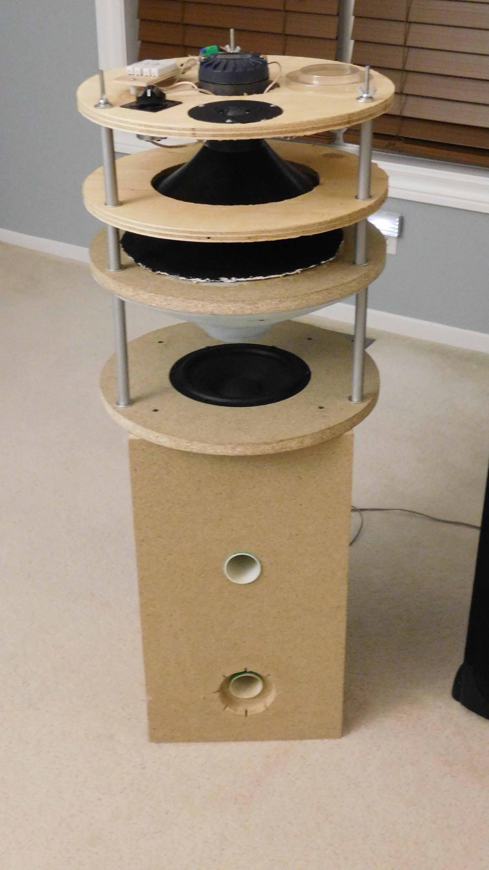

Omni
I've been experimenting with OmniDirectional speakers (my sandbox prototype model) in an attempt to increase reflections, in particular lateral ones. I thought I'd add a few observations because these issues have been mentioned w.r.t stereo image location, soundstage and spaciousness. These speaker have been measured and have a omnipolar constant response 360deg.
Observation 1: single Omni operating in mono. You can walk around most of the room and tell where it is blindfolded when your ears hear equal SPL (ie. you're pointed at it). I say most, because if you stand between the wall/alcove and the speaker the location appears to be between the two. The reflection off the wall tricks your ear, generating a phantom coming out of a wall.
Observation 2: two Omni operating in stereo. They fill the room and you still will hear loudness differences if you approach a single speaker but you still hear both speakers regardless of where you are. If you are 2m away from them, they are very hard to locate with any precision blindfolded. The first reflections are in the 7-20ms range depending of the path (5mx4mx3m). The reflections make the sound spacious and diffuse, sounding good nearly everywhere.
Observation 3: two Omni operating in stereo. The stereo image is best anywhere in a line between the speakers (equi-distant). However it can also be found if you are off that line as well. In walking right to left at 2m in front of the speakers you will still hear the soundstage and phantom image but it will of course shift as relative R/L levels change. The sound level changes as you move are very gradual and the tone stays even.
