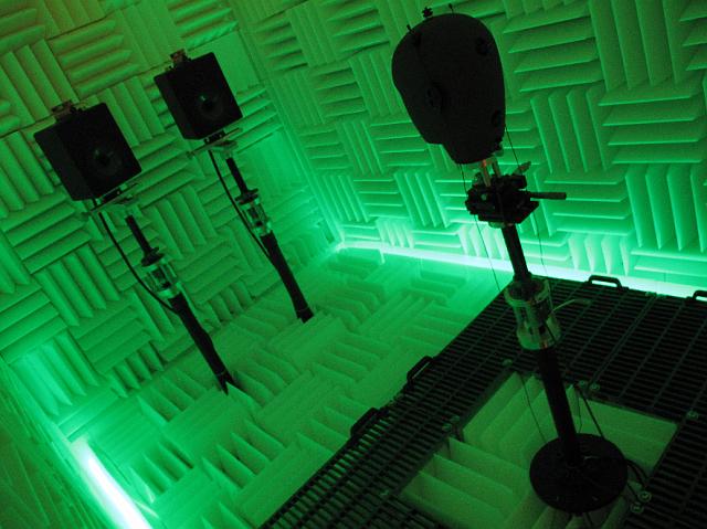

BACCH 3D Sound

Thank you. This is interesting. BACCH is not really Ambiophonics although both based on XTC. In ambiophonics the speakers must be closer around 20 degrees. BACCH meant for speakers around 60 degrees.
I will compare both. Thanks again
I think the ideal setup for BACCH would still be a ~20 degree setup. Most samples and demo's will be catered for 60 degree stereo setups though.
I couldn't see any BACCH filters being available, the earlier work from prof. Edgar Choueiri (from before he left the ambiophonics project) is floating around though, as a set of IR's.
The set of IRs available from Ambiophonics.org was specially created by Farina. Choueiri created a far better XTC algorithm than ambiophonics, although I would put the relevance is akin to overhead speakers in ATMOS system. I doubt, you would want to hear bees buzzing near you ears often enough and no classical music or most of the normal music without SF contains such sound(s).
If I am not mistaken the initial research of BACCH was funded by Sony. Therefore it is possible that due to commercial interest the free BACCH filter is no longer available. Ralph's idea of ambiophonics is that it should be free for all.
Prof. Edgar Choueiri's IR's from his time spend within the Ambiophonics project have been floating around on the net (at least years ago, must have been around 2011/2012). I don't remember who made me aware of them but I'm definitely not the only one that has them. They didn't exactly part as friends.
